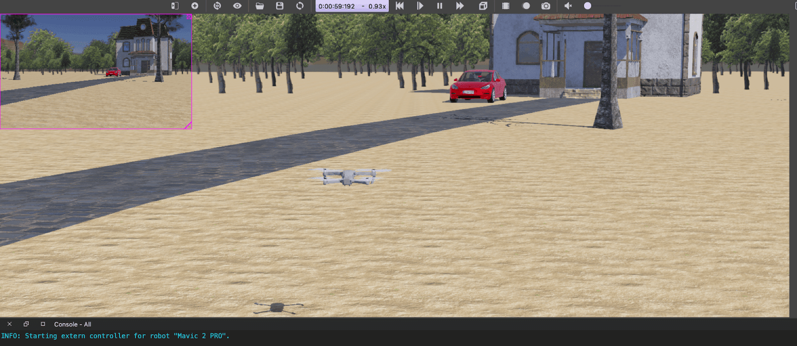

In order to simulate the drone, we used an open-source 3D robot simulator called Webots. We used some of the basic built-in sample models, sensors, and actuators within the software package to construct a simulated world with a drone and some realistic real-world objects. The internal physics engine provided us with a reliable way to test and develop a very basic controller for the drone’s attitude control and live data telemetry.
Embedded image
Real-time simulation of a DJI Mavic 2 Pro Drone

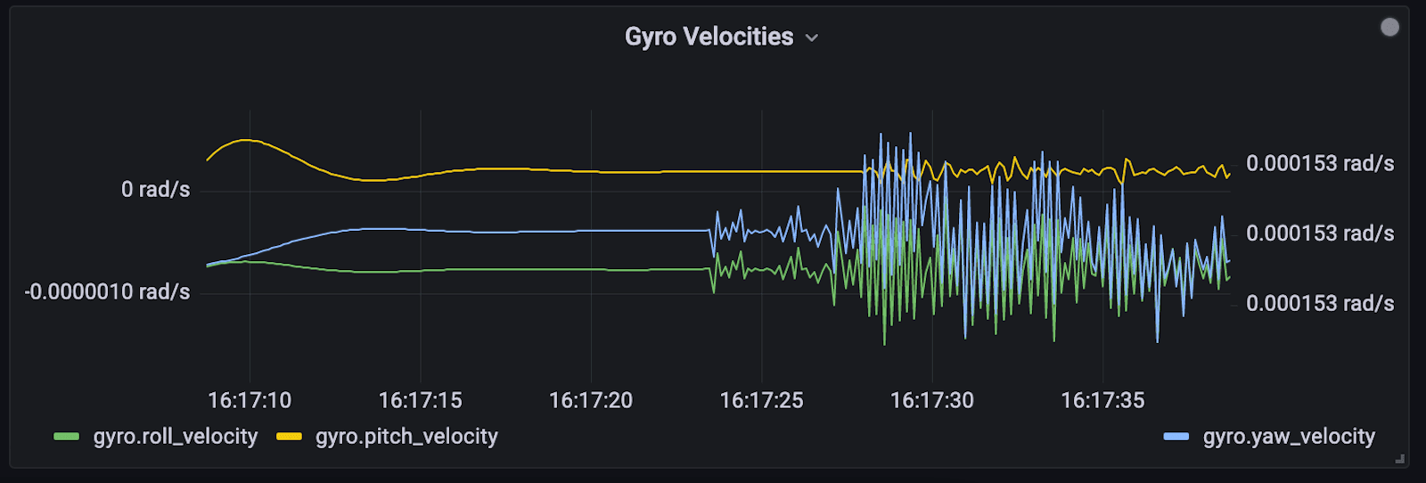

A simple time-series panel was used to visualize the rotational velocity data from the gyroscope on-board.
Embedded image

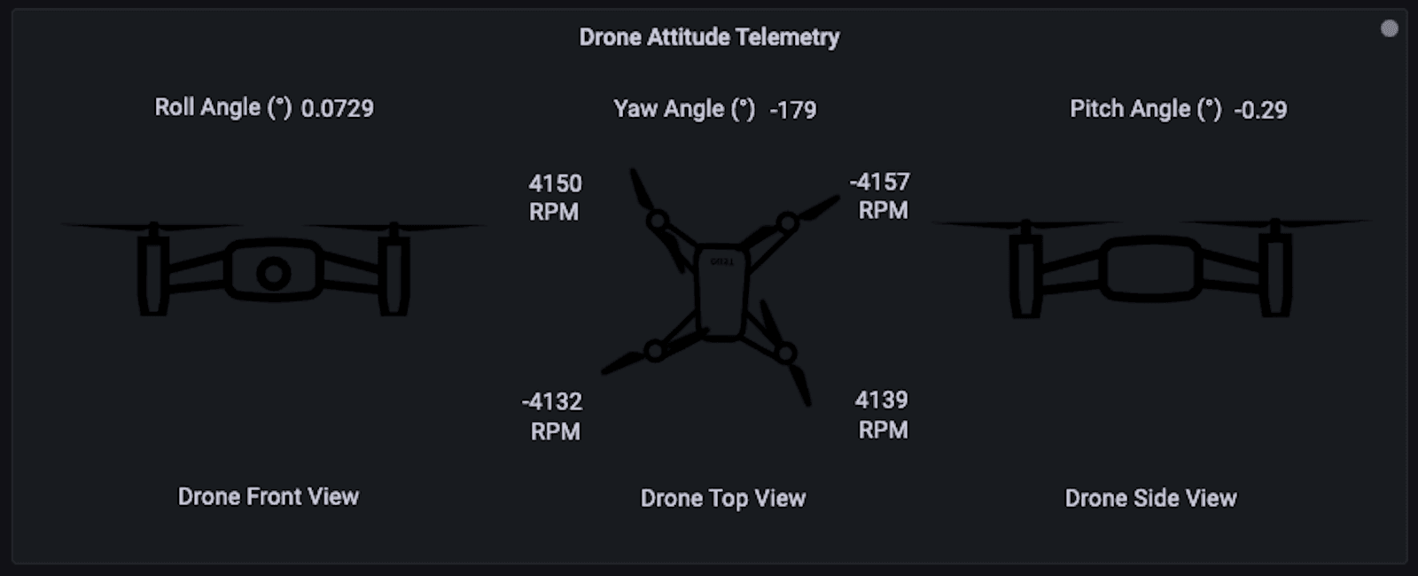

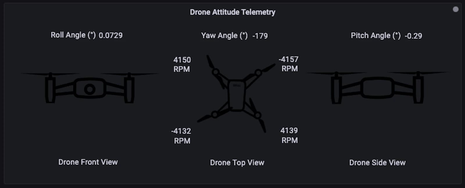

Below, you can see the Canvas panel (under early development!) for the visualization of the real-time attitude telemetry from the drone, with appropriate views of the drone as they relate to the roll, pitch, and yaw of the simulated drone.
Embedded image

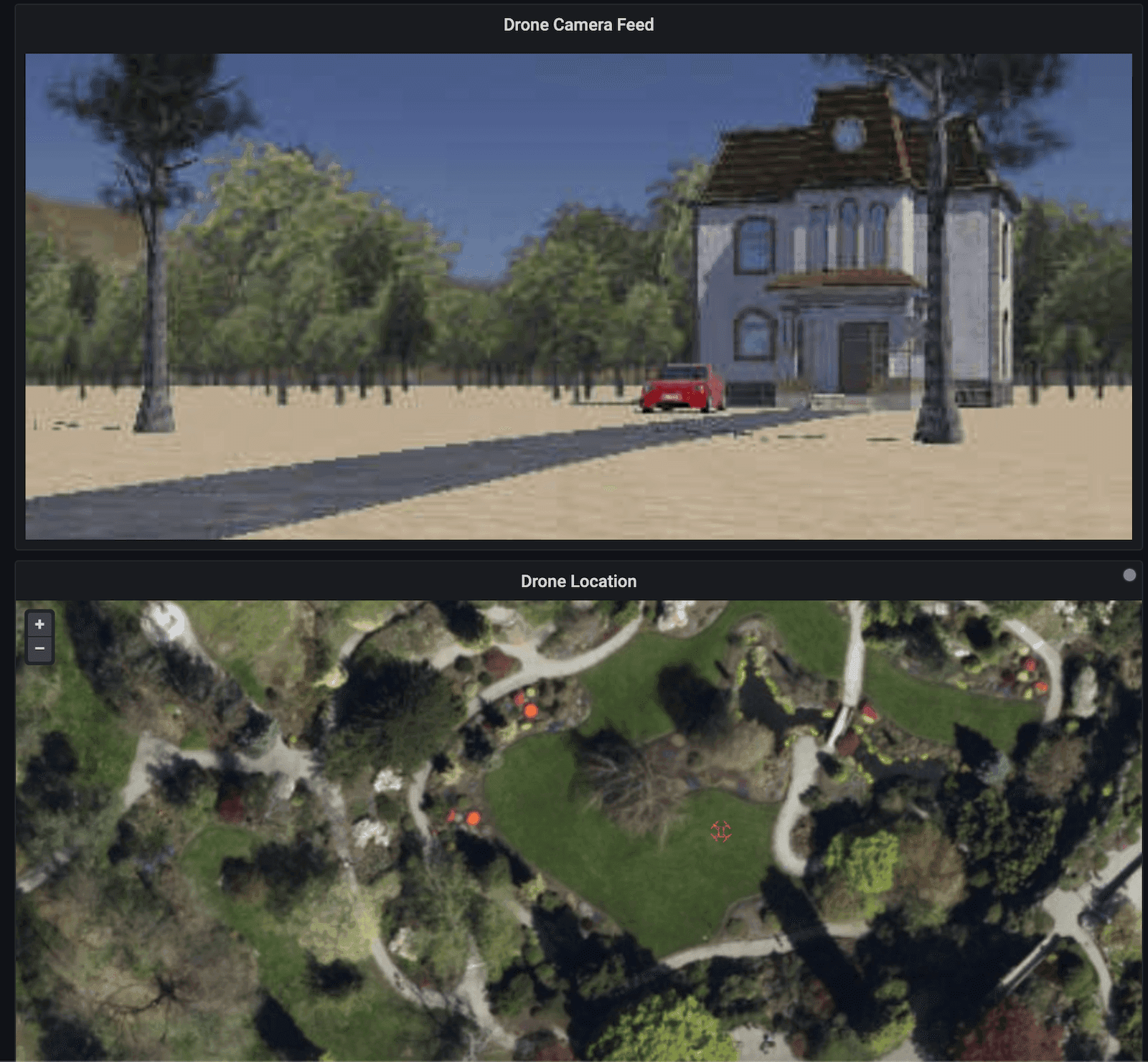

On top of that, we utilized the Text panel in the HTML mode to show the live camera feed from our simulation. The newly released Geomap panel was used to show the real-time drone location.
Embedded image
Live camera and location feed from the simulated drone

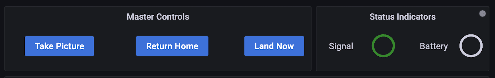

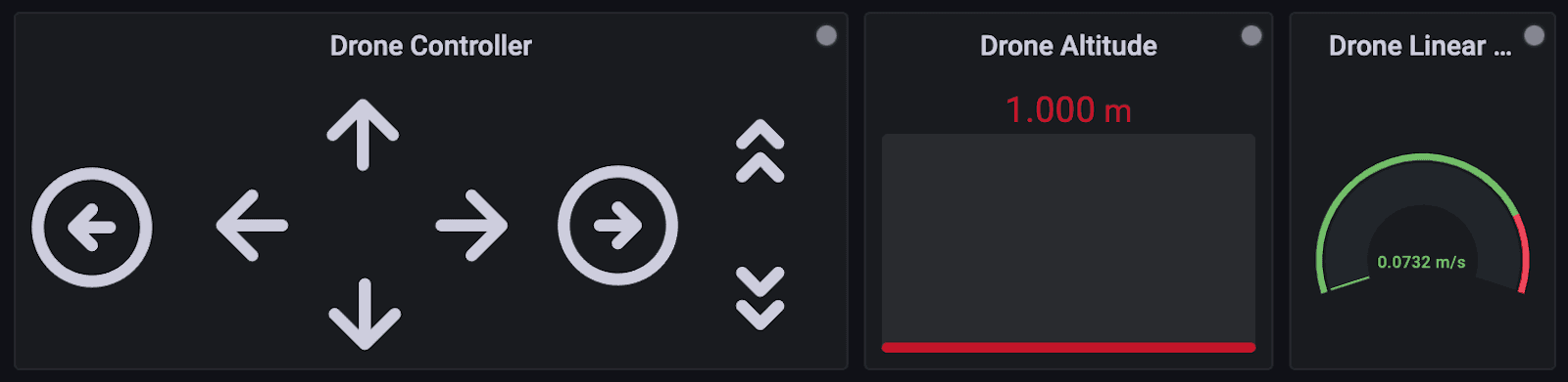

We also added remote-write capabilities using buttons on our Canvas panel (below) to control the drone movements. We were also able to trigger other potential pre-programmed actions, such as taking a picture or performing a specific maneuver.
Embedded imageEmbedded image
