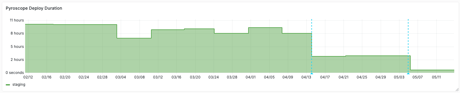

Fewer stateful components means fewer things that can break and faster recovery when they do. Rollouts that took 8-12 hours in v1 now complete in minutes. The segment writer is diskless. The store-gateway is gone. The operational surface area is significantly smaller.

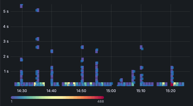

- Heatmap queries (shown below): visualize profile distributions over time to spot patterns and outliers.
