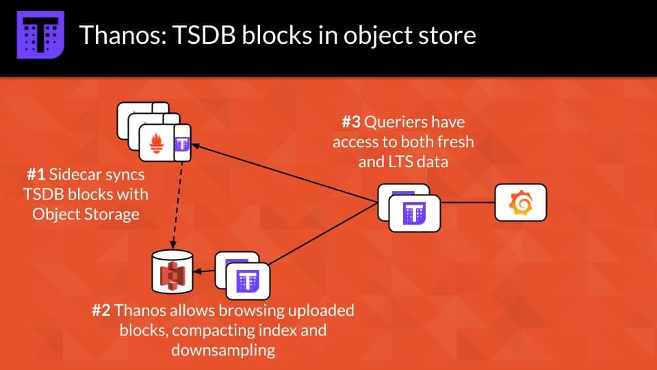

Thanos offloads Prometheus TSDB blocks to object stores; 7 different object stores are supported. Two-hour-long blocks are built locally and then uploaded to the object store by the Thanos sidecar. A separate microservice – the Thanos Store Gateway – is used to handle queries against the blocks in object storage. Responsibility for the durability of the blocks is offloaded to the object store – a wise choice, as replication and repair is difficult to get right.
Embedded image
