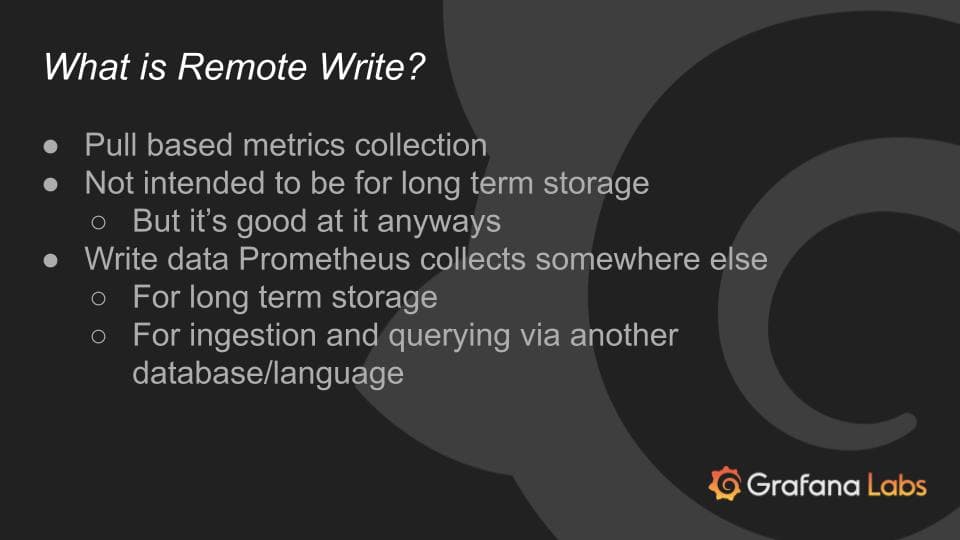

At the start, Styan provided a brief summary of remote write basics.
Embedded image
He reminded the audience that remote write will – if you configure it to – send all of your metrics somewhere other than Prometheus for various reasons, such as long-term storage or some other system for a different query language.
In his case, he wanted it for Cortex and different query parallelization, which is provided by Cortex.

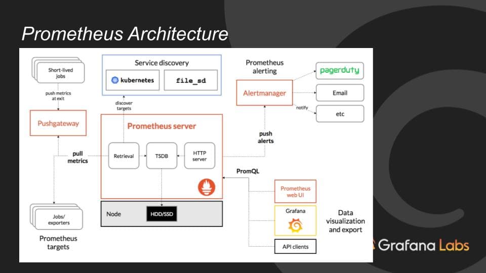

Embedded image
Previously, the retrieval portion of Prometheus would scrape targets (see Retrieval, above), and remote write would make a copy of every sample and buffer unsent samples in memory until it could successfully send them on to the remote write system.
That wasn’t great, Styan said: “What happens if the remote right endpoint goes down, and you continually buffer data?”
As he explained, that buffer was a fixed size, so if filling the buffer didn’t OOMkill your Prometheus, remote write would eventually just start dropping samples when the buffer filled up, which is something you don’t want either. “If this remote storage system is supposed to be for your long-term storage but you don’t end up with all your data there,” he said, “that’s not great either.”
