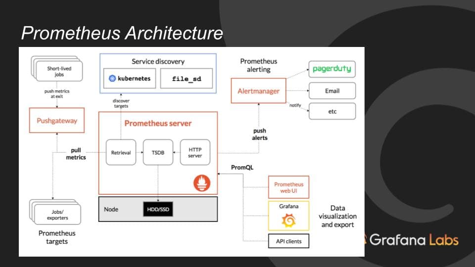

Previously, the retrieval portion of Prometheus would scrape targets (see Retrieval, above), and remote write would make a copy of every sample and buffer unsent samples in memory until it could successfully send them on to the remote write system.
That wasn’t great, Styan said: “What happens if the remote right endpoint goes down, and you continually buffer data?”
