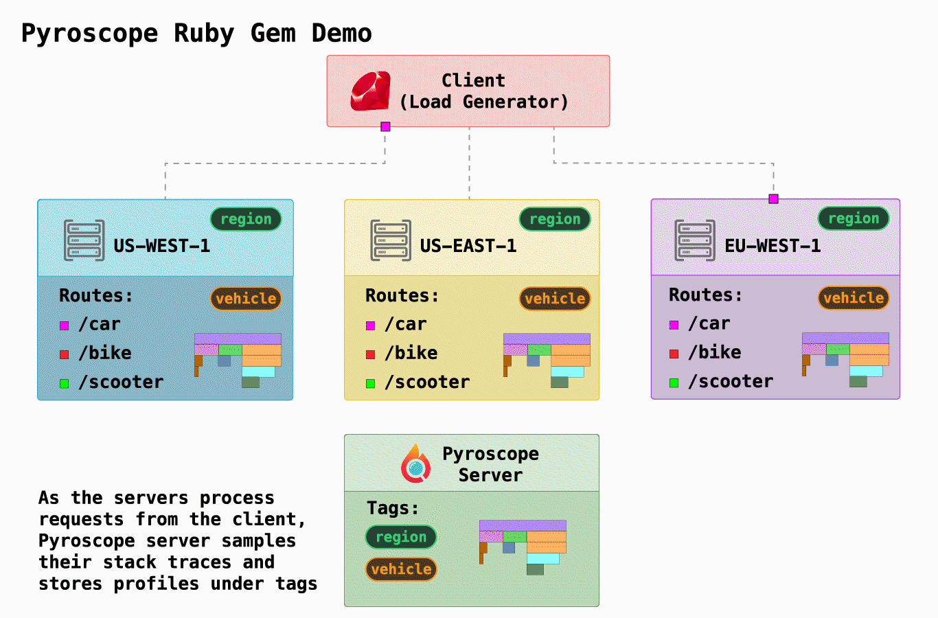

In this example we show a simplified, basic use case of Pyroscope. We simulate a “ride share” company that has three endpoints found in server.rb:
  • /bike : calls the order_bike(search_radius) function to order a bike
  • /car : calls the order_car(search_radius) function to order a car
  • /scooter : calls the order_scooter(search_radius) function to order a scooter
We also simulate running three distinct servers in three different regions (via docker-compose.yml)
  • us-east-1
  • us-west-1
  • eu-west-1
One of the most useful capabilities of Pyroscope is the ability to tag your data in a way that is meaningful to you. In this case, we have two natural divisions, and so we “tag” our data to represent those:
  • region: statically tags the region of the server running the code
  • vehicle: dynamically tags the endpoint (similar to how one might tag a controller rails)

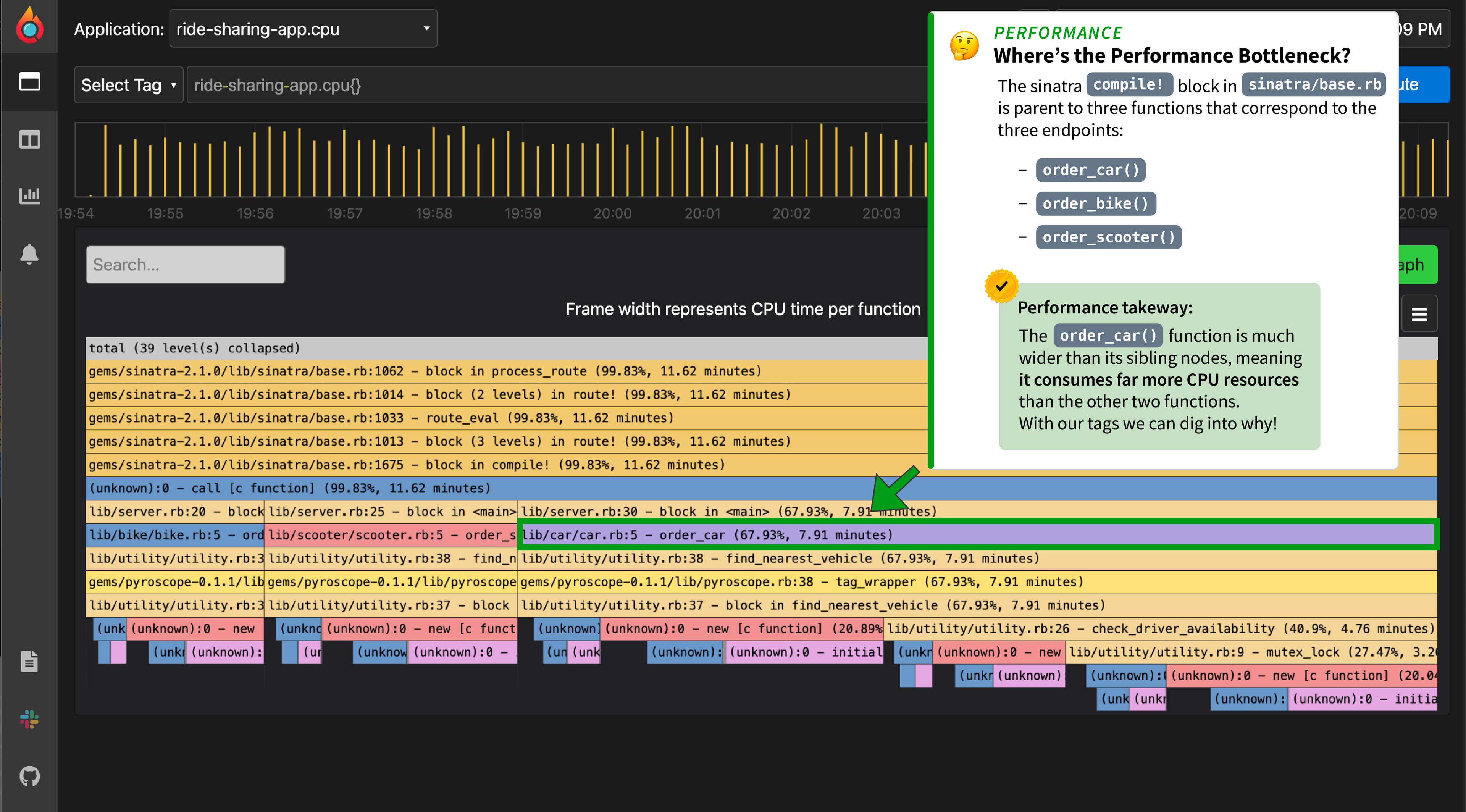

Where’s the performance bottleneck?
Flame graph showing performance bottleneck UI in Grafana Pyroscope
The first step when analyzing a profile from your application is to take note of the largest node, which is where your application is spending the most resources. In this case, it happens to be the order_car function.

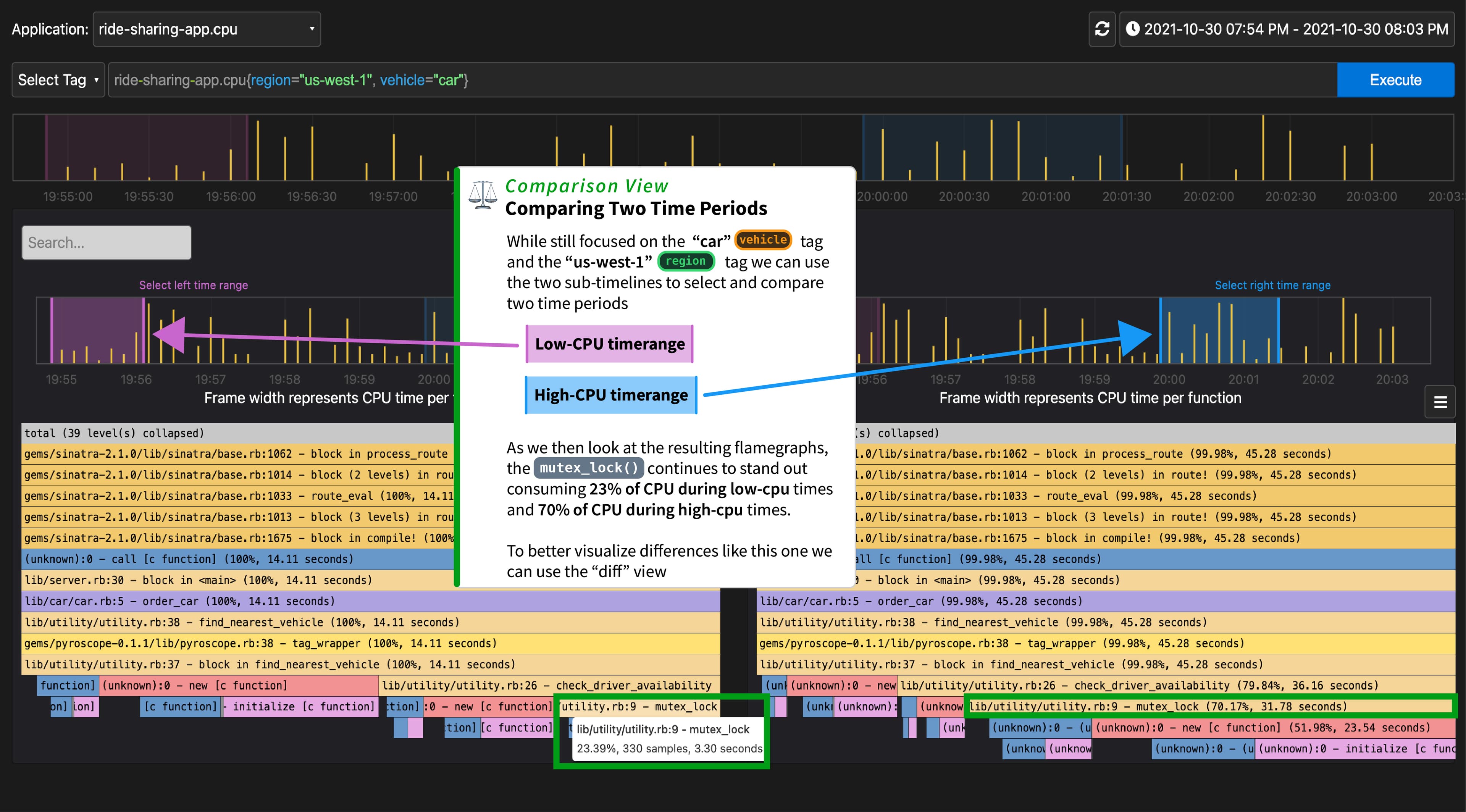

Comparing two time periods
Using Pyroscope’s “comparison view” we can actually select two different time ranges from the timeline to compare the resulting flame graphs. The pink section on the left timeline results in the left flame graph and the blue section on the right represents the right flame graph.
When we select a period of low cpu utilization and a period of high cpu utilization, we can see that there is clearly different behavior in the mutex_lock() function where it takes 23% of CPU during low cpu times and 70% of CPU during high cpu times.
Comparison view of different time periods in Grafana Pyroscope
