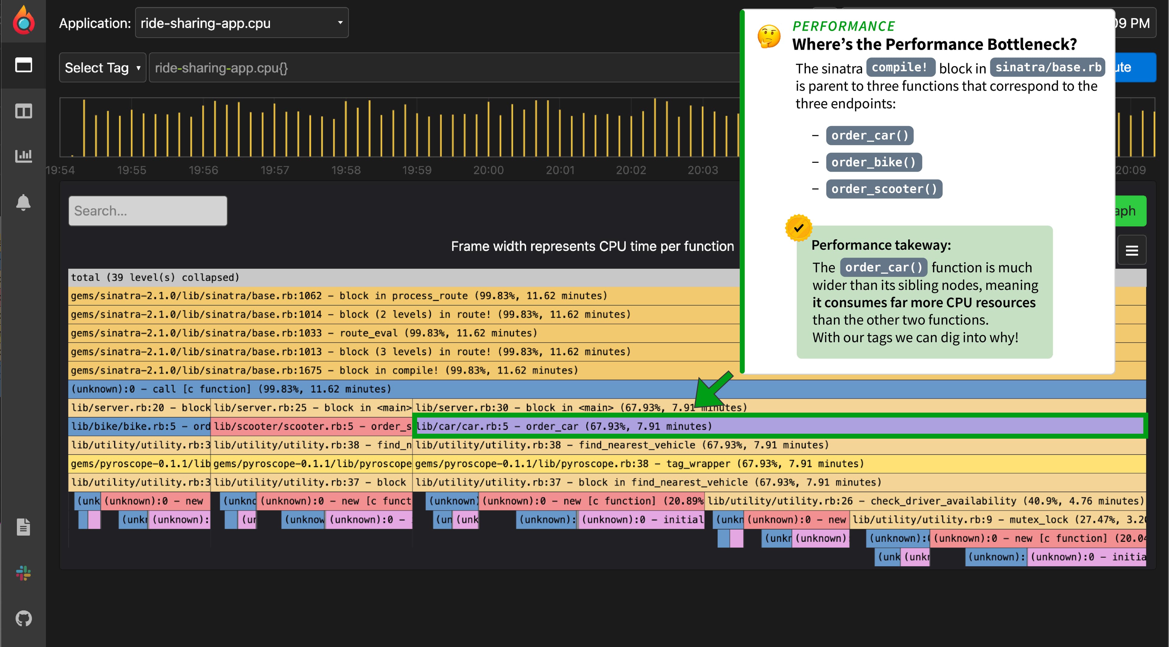

Where’s the performance bottleneck?
Flame graph showing performance bottleneck UI in Grafana Pyroscope
The first step when analyzing a profile from your application is to take note of the largest node, which is where your application is spending the most resources. In this case, it happens to be the order_car function.

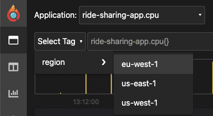

The benefit of using the Pyroscope package, is that now that we can investigate further as to why the order_car() function is problematic. Tagging both region and vehicle allows us to test two good hypotheses:
  • Something is wrong with the /car endpoint code
  • Something is wrong with one of our regions
To analyze this, we can select one or more tags from the Select Tag drop-down menu:
Select tag UI in Grafana Pyroscope UI

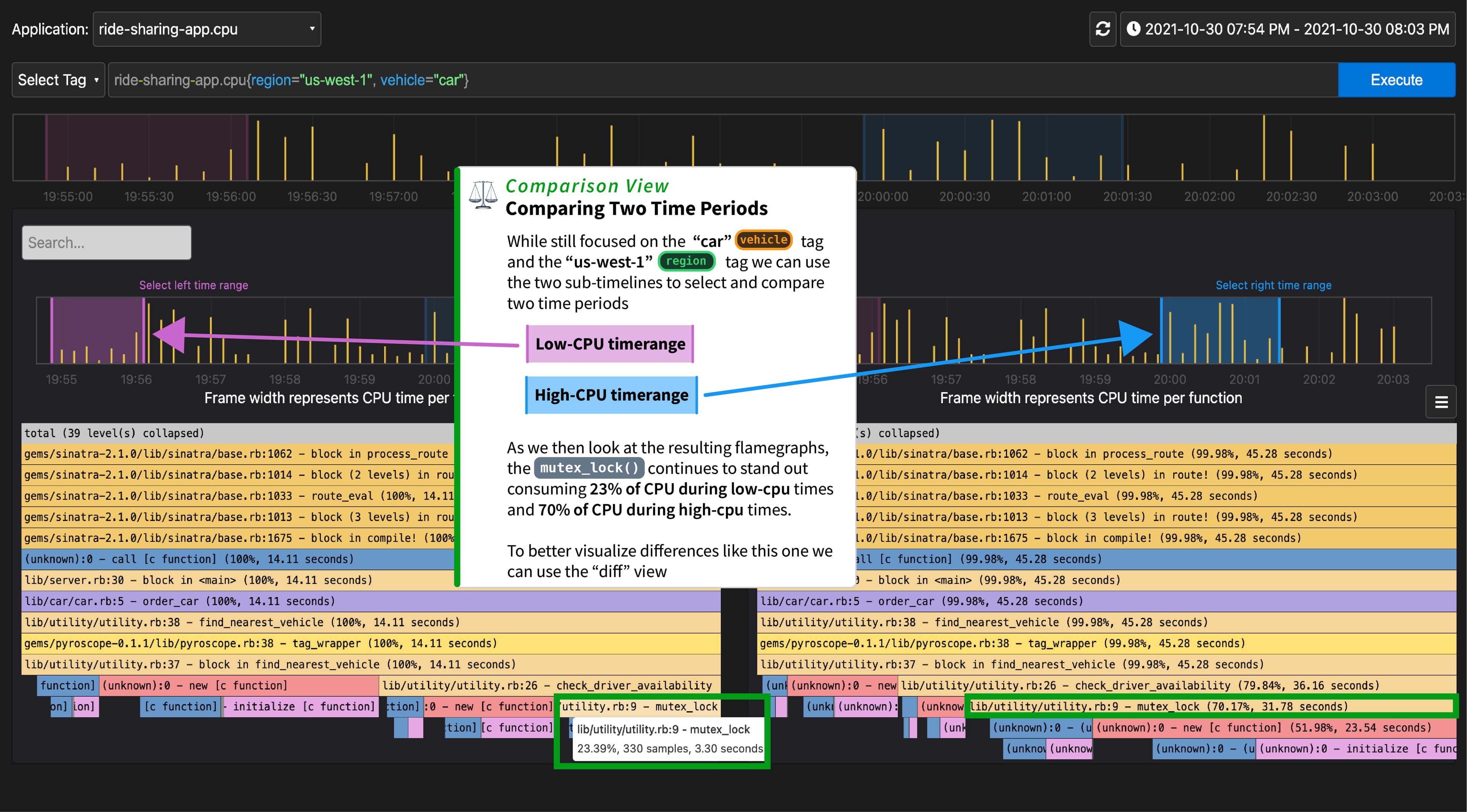

Narrowing in on the issue using tags
Knowing there is an issue with the order_car() function, we automatically select that tag. Then, after inspecting multiple region tags, it becomes clear by looking at the timeline that there is an issue with the us-west-1 region, where it alternates between high-cpu times and low-cpu times.
We can also see that the mutex_lock() function is consuming almost 70% of CPU resources during this time period.
Debugging UI in Grafana Pyroscope
Comparing two time periods
Using Pyroscope’s “comparison view” we can actually select two different time ranges from the timeline to compare the resulting flame graphs. The pink section on the left timeline results in the left flame graph and the blue section on the right represents the right flame graph.
When we select a period of low cpu utilization and a period of high cpu utilization, we can see that there is clearly different behavior in the mutex_lock() function where it takes 23% of CPU during low cpu times and 70% of CPU during high cpu times.
Comparison view of different time periods in Grafana Pyroscope
