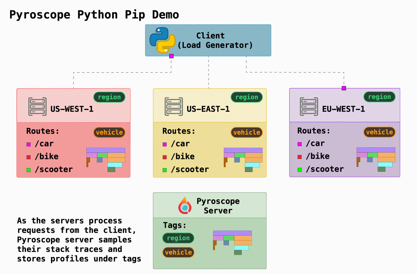

In this example we show a simplified, basic use case of Pyroscope. We simulate a “ride share” company which has three endpoints found in server.py:
  • /bike : calls the order_bike(search_radius) function to order a bike
  • /car : calls the order_car(search_radius) function to order a car
  • /scooter : calls the order_scooter(search_radius) function to order a scooter
We also simulate running 3 distinct servers in 3 different regions (via docker-compose.yml)
  • us-east-1
  • us-west-1
  • eu-west-1
One of the most useful capabilities of Pyroscope is the ability to tag your data in a way that is meaningful to you. In this case, we have two natural divisions, and so we “tag” our data to represent those:
  • region: statically tags the region of the server running the code
  • vehicle: dynamically tags the endpoint (similar to how one might tag a controller rails)

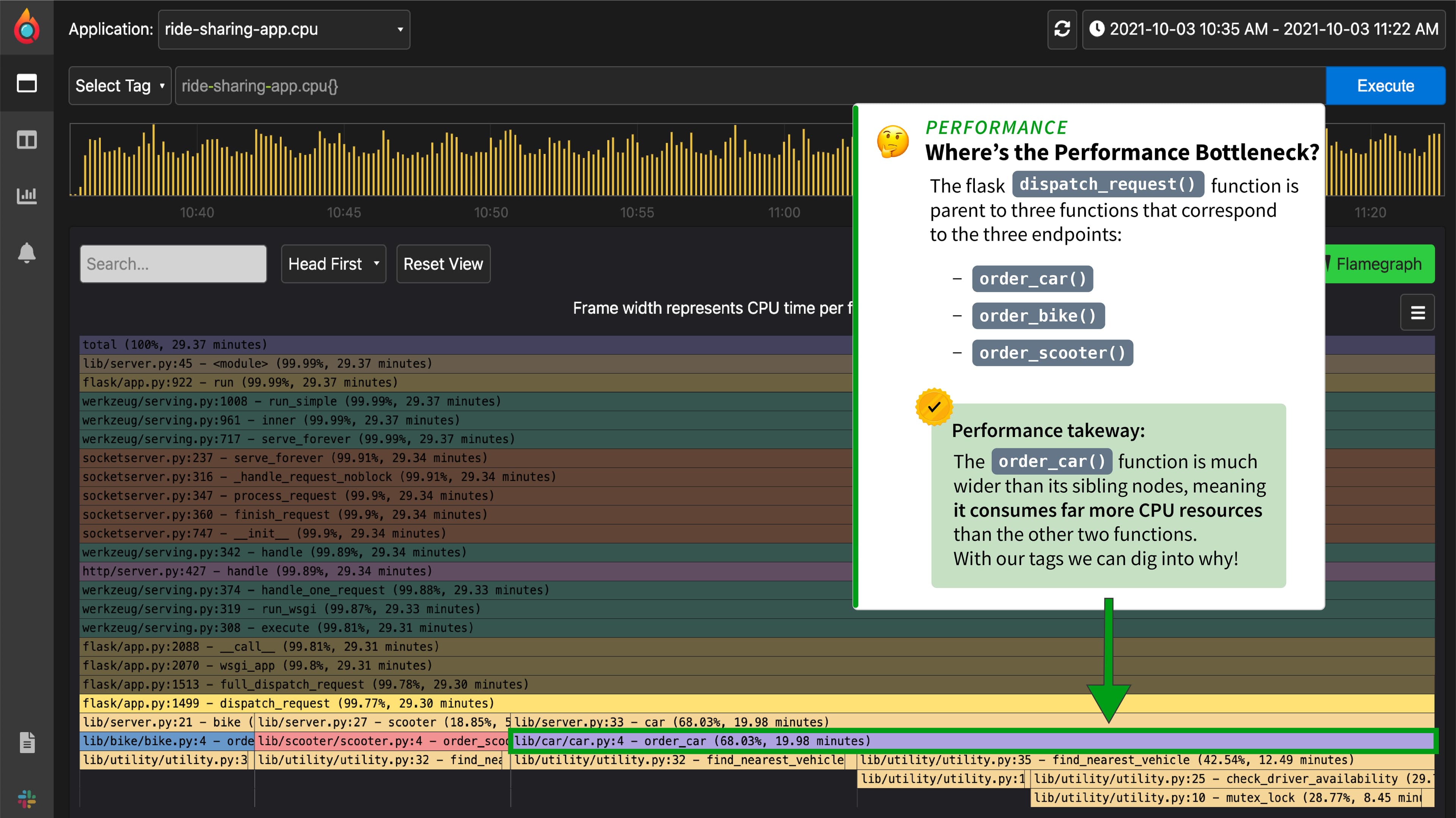

Where’s the performance bottleneck?
Performance botlteneck called out in dashboard
The first step when analyzing a profile outputted from your application, is to take note of the largest node which is where your application is spending the most resources. In this case, it happens to be the order_car function.

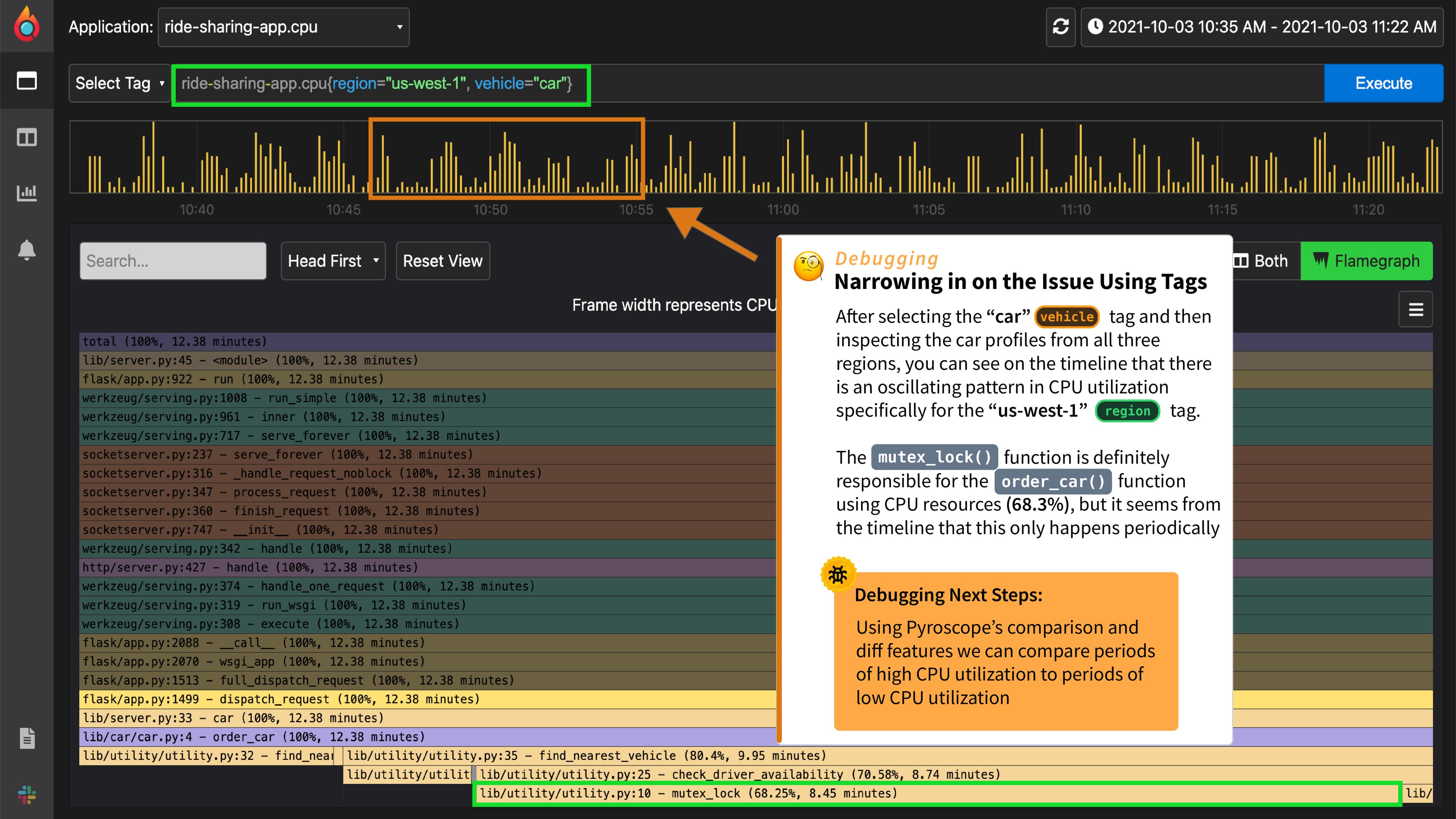

Narrowing in on the issue using tags
Knowing there is an issue with the order_car() function we automatically select that tag. Then, after inspecting multiple region tags, it becomes clear by looking at the timeline that there is an issue with the us-west-1 region, where it alternates between high CPU times and low CPU times.
We can also see that the mutex_lock() function is consuming almost 70% of CPU resources during this time period.

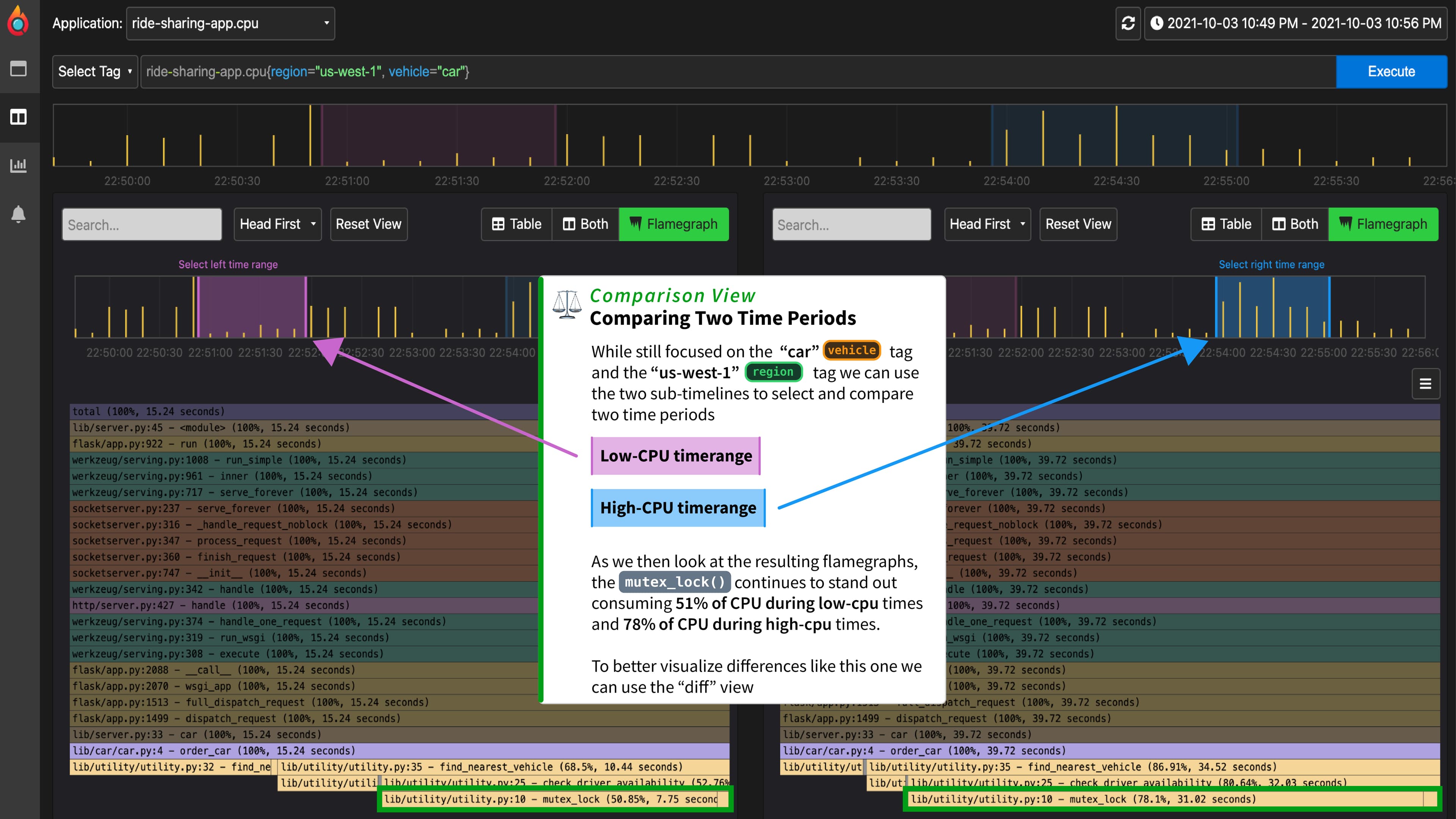

Comparing two time periods
Using Pyroscope’s “comparison view” we can actually select two different time ranges from the timeline to compare the resulting flame graphs. The pink section on the left timeline results in the left flamegraph, and the blue section on the right represents the right flame graph.
When we select a period of low CPU utilization and a period of high CPU utilization we can see that there is clearly different behavior in the mutex_lock() function where it takes 51% of CPU during low CPU times and 78% of CPU during high CPU times.

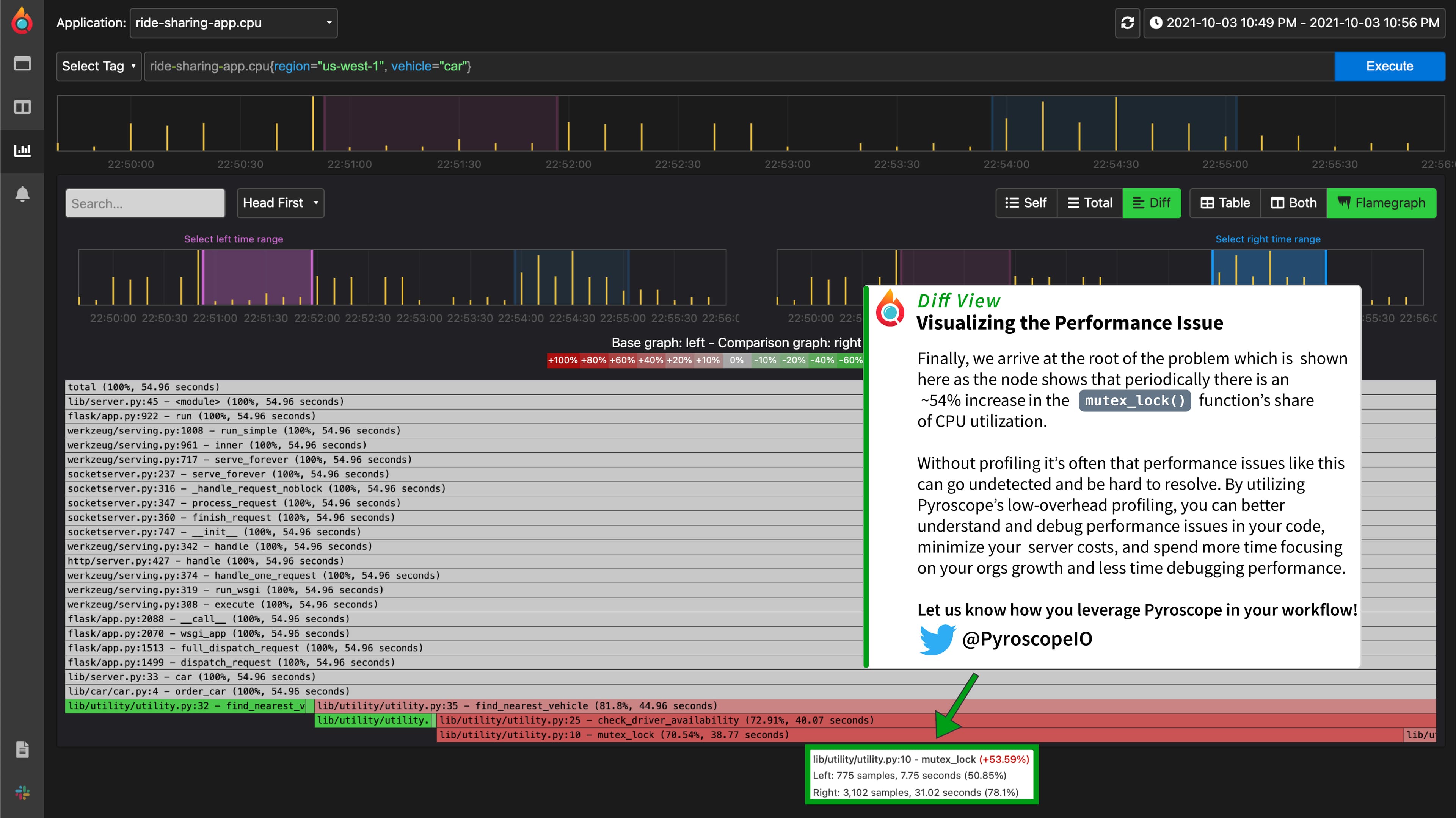

Visualizing the difference between two flame graphs
While the difference in this case is stark enough to see in the comparison view, sometimes the diff between the two flame graphs is better visualized with them overlayed over each other. Without changing any parameters, we can simply select the diff view tab and see the difference represented in a color-coded diff flame graph.
