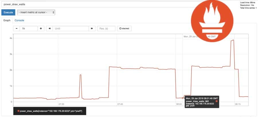

Erwin, who lives in the Netherlands, connected his Raspberry Pi Zero to his smart energy meter with a USB2 P1 cable, which enabled him to gather all of the data that the smart meter collected onto his Raspberry Pi. He wrote an exporter in Go using the promhttp library to get the data from the P1 port, store it, and expose the metrics to be scraped by Prometheus.
In his presentation, Erwin showed the graphs from his smart meter. “You can see some peaks. I’m using four kilowatts [here]. That’s probably because when [the washing machine] turned on, that uses three kilowatts,” he said. “There’s some more going on, I’m not sure what it is. So I put Prometheus on the other Intel NUC that I had lying around. So you have the gathering, but the visualization of Prometheus is not stored, so here comes Grafana.” Power usage Default Prometheus graph showing the 4Kw peak

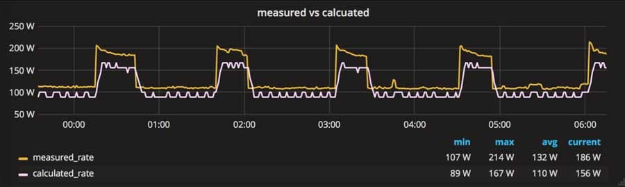

The first graph showed the current draw and the meter reporting. “With Prometheus it is possible to do a derivative of your graph, so this [graph] is the comparison between what the meter is reporting, and what the current draw is, and as you can see they do align,” he said. “There’s a small difference between them, which also makes sense because the smart meter only reports its values every 20 seconds.”
Current draw vs what the meter reports Current draw vs what the meter reports
The graph, interestingly, showed some peaks at night, every 60-90 minutes. What was drawing power at night? His refrigerator. “At one point I was up at night and I heard it turn on,” Erwin said. “I was like, ‘Oh, let’s check [the graph] on my phone.’”

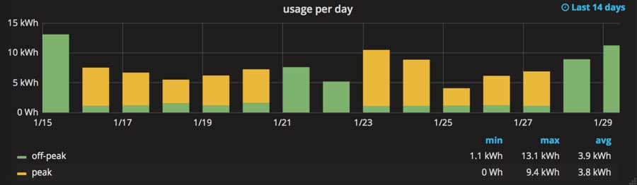

The second graph of note showed the off-peak and peak measurements. “I found out that I have two meters, and on the weekends it’s all off-peak,” he said. “I also noticed Christmas is off-peak. Apparently January 1 is off-peak. So I now have insights into when I save money and when I don’t save money.”
Peak vs off-peak usage Peak vs off-peak usage
