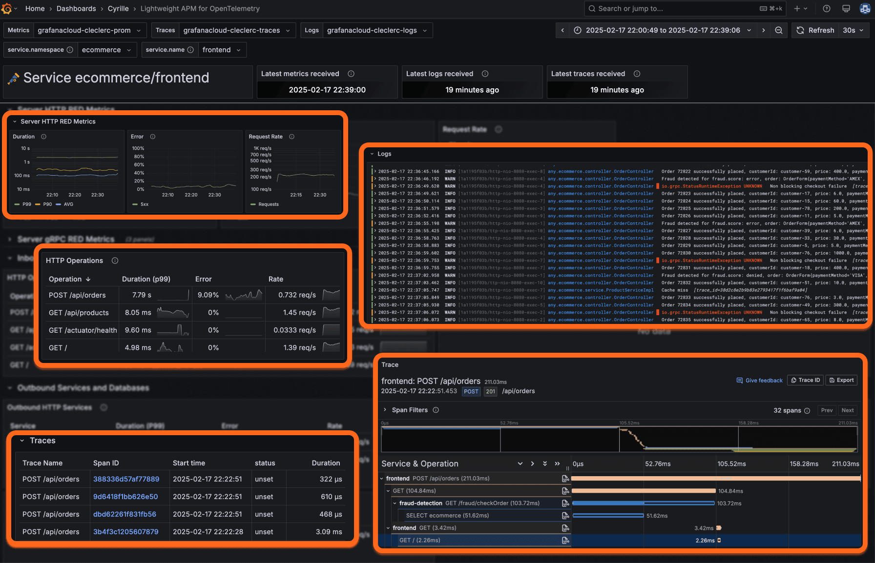

Richer community dashboards
Once resource attribute promotion and keep_identifying_resource_attributes are enabled, you can immediately get richer OpenTelemetry native dashboards, such as the Lightweight APM for OpenTelemetry dashboard, through the Grafana community.
This dashboard provides a simplified APM experience, including a service selector, RED metrics on inbound HTTP/RPC operations, and RED metrics on outbound HTTP/RPC/database calls, alongside log and trace correlation!
Lightweight APM for OpenTelemetry dashboard, with panels highlighted to illustrate the functionality
