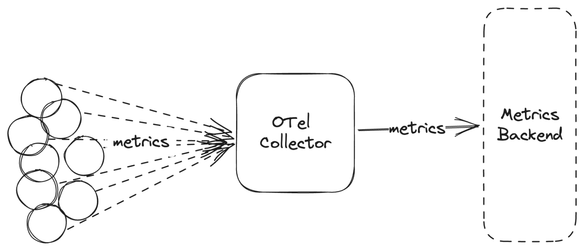

Application architecture
The typical architecture that we’re targeting here is that the applications generate the metrics and export them to the OpenTelemetry Collector in the OTLP format and the Collector then forwards these metrics to the relevant backend.
We will not discuss the architecture where the applications push directly to the backend. This is not recommended in production.
