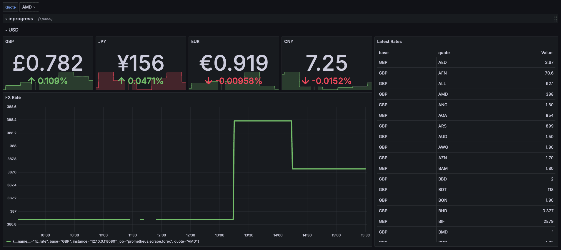

  3. Visualize the changes in forex rates

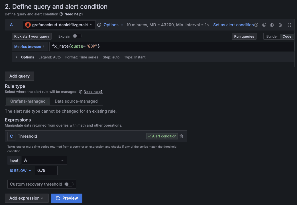

  4. Define alerts to be notified of changes in forex rates even when we’re not looking at our dashboard

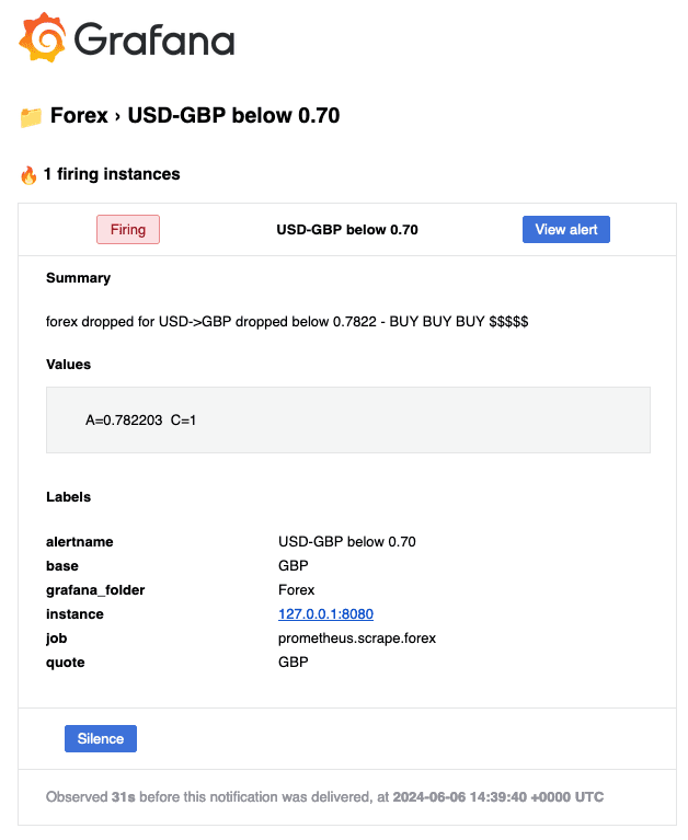

  3. You should now be seeing a metric in Grafana Cloud. Verify that it’s working by heading to your Grafana Cloud instance and going to Explore — you should see a metric called fx_rate
  4. Now you can run queries, make dashboards, and set up alerts based on the forex rate. Below I’ll show some examples for your inspiration
Grafana dashboard for exchange ratesDefine query and alert conditions' menuAlert notification
