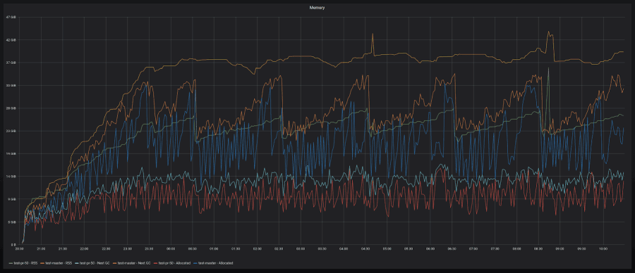

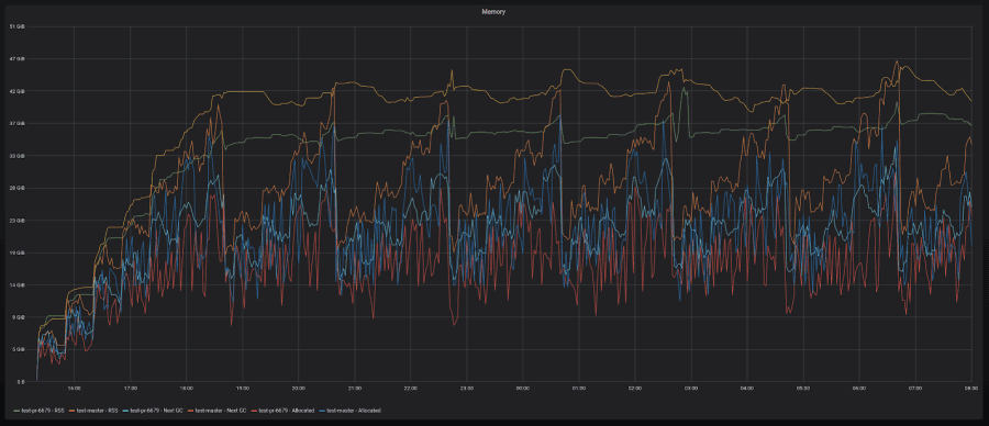

Here are some graphs:
Decent memory reduction with high churn (10-20%)
Massive memory reduction with little to no churn (30-40%)

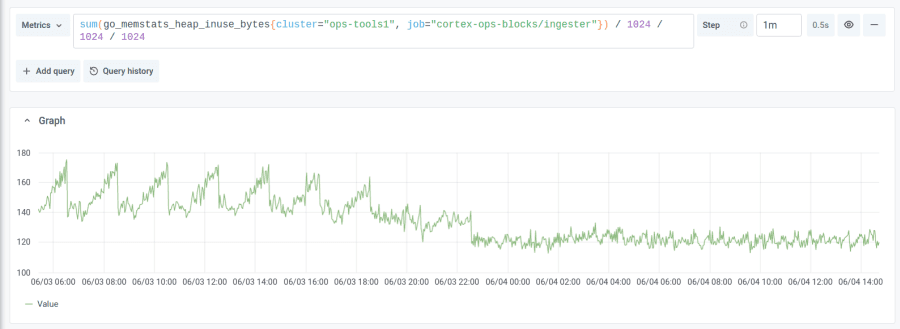

The improvements are not limited to Prometheus. Other projects in the Prometheus ecosystem like Cortex and Thanos, which import the Prometheus TSDB, also benefit from this change. Here is a graph from Cortex with block storage, where not only the memory usage is reduced, but so are the spikes in memory every 2 hours.
