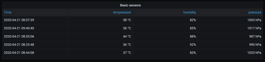

Take a look at the table below showing time, temperature, and pressure over time:

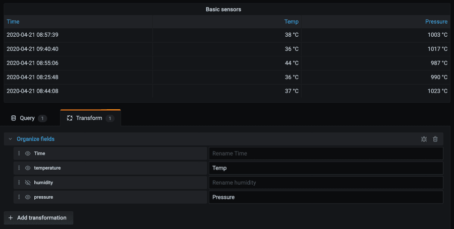

With, for example, the organize fields transformation, you can easily hide, reorder, or rename the result set’s fields. In the table below, the temperature field was renamed to Temp, pressure to Pressure, and the humidity field was hidden.

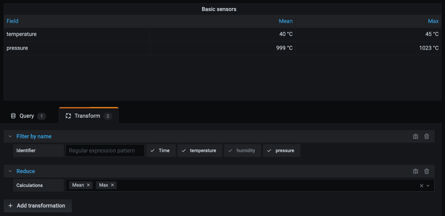

You can chain multiple transformations together; they are run in a sequence. This means that the result from the previous transformation will be passed to the next one in the transformations list. For example, you can first filter the results set and then apply calculation on the filtered data. The image below shows an example of these transformations. The result set was first filtered (humidity field is filtered out), and then the reduce transformation was applied to calculate the mean and max of the temperature and pressure.
