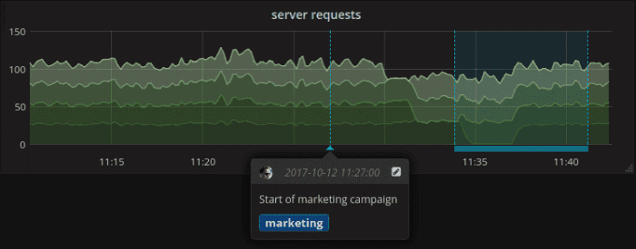

One thing that was missing in Grafana, though, was enabling Loki as an annotations query source. Annotations are an amazing feature in Grafana that can help you get even more insights into your systems, as it lets you overlay any kind of events over your graphs. For example, you can overlay opening or closing windows in your greenhouse over your temperature graph, application deploys over your web service error rate, or people’s arrivals and departures over your smart home’s electricity consumption.
Embedded image
Before Grafana 6.4, there was no way to see data from Loki in dashboards at all. But now you can not only visualize your logs in Logs panel but also use Loki for annotations and either overlay data from your existing log streams as annotations or use Loki as a lightweight solution to other valuable events. This helps you get even better insights into your system behavior.

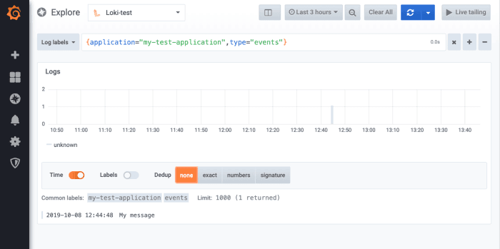

4. You can check that the message is in Loki using Explore with query {application="my-test-application",type="events"}. You can learn more about the query language in the documentation.

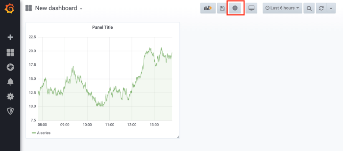

5. Create a dashboard with a simple Graph panel. You can use random walk from Test Data data source.
6. Open dashboard settings.
Embedded image

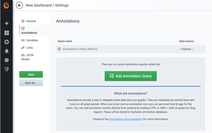

7. Open annotations tab.
Embedded image

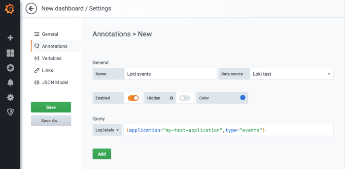

8. Click Add Annotation Query, fill in the name, and choose your Loki data source from the data source picker. Fill in the Loki query to filter your test events that we pushed in step 2: {application="my-test-application",type="events"}.
Embedded image

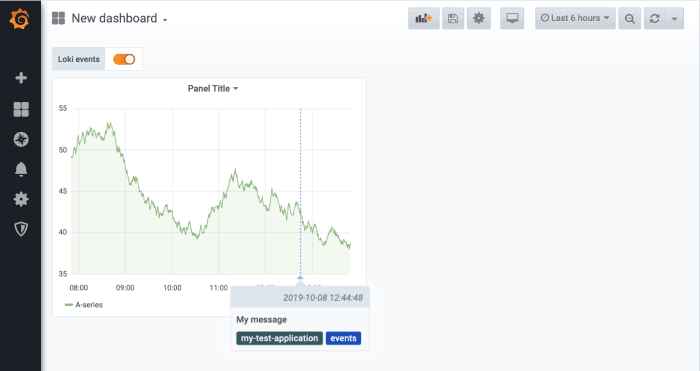

9. Click Add and go back to your dashboard. The graph panel we created should show annotations we pushed in the second step.
