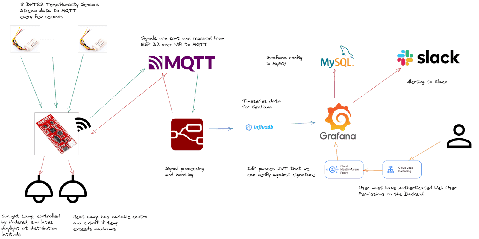

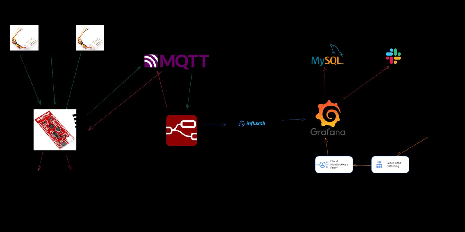

High-level architecture

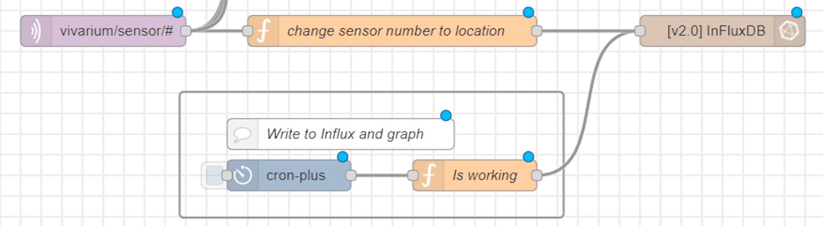

The high-level architecture required a few pieces to get working. The core element is automation. The data is pushed from the sensors into InfluxDB via Node-RED. The Grafana settings are stored in MySQL and the user interface is accessed through the identity aware proxy. I figured that Google can build a better authentication system than I can. I wrote about this before so you can see Grafana’s awesome integration capabilities using JSON web tokens.

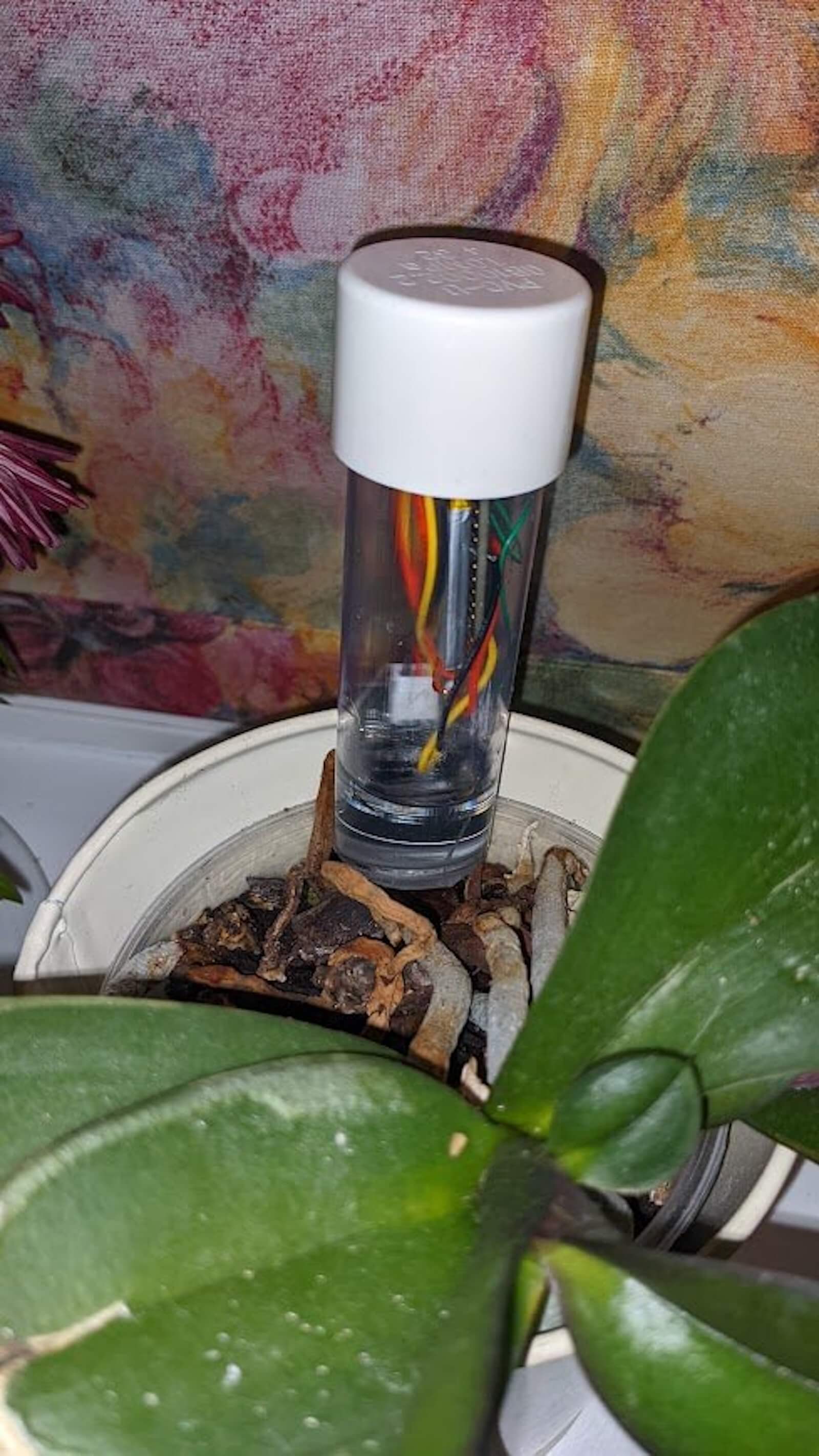

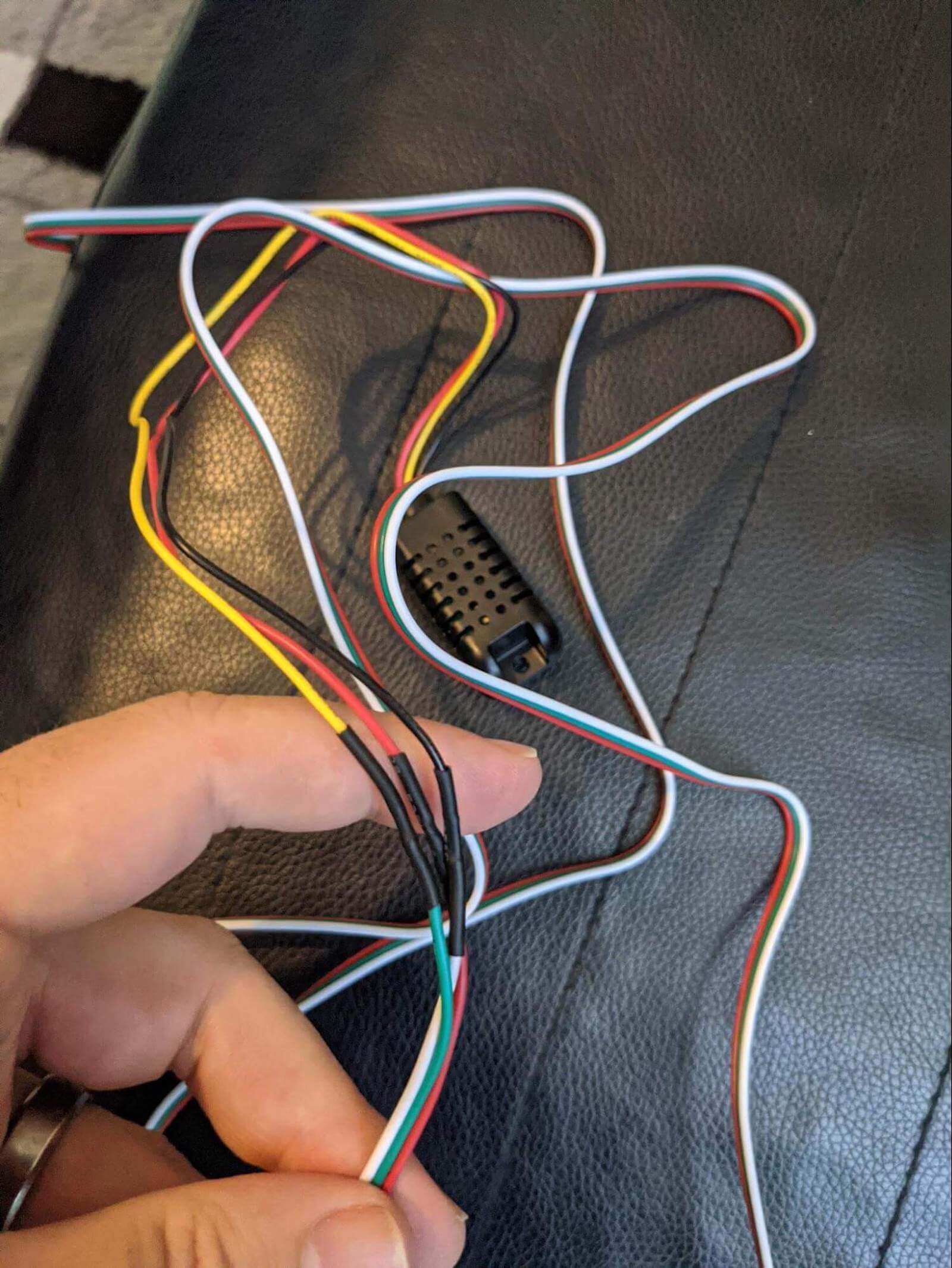

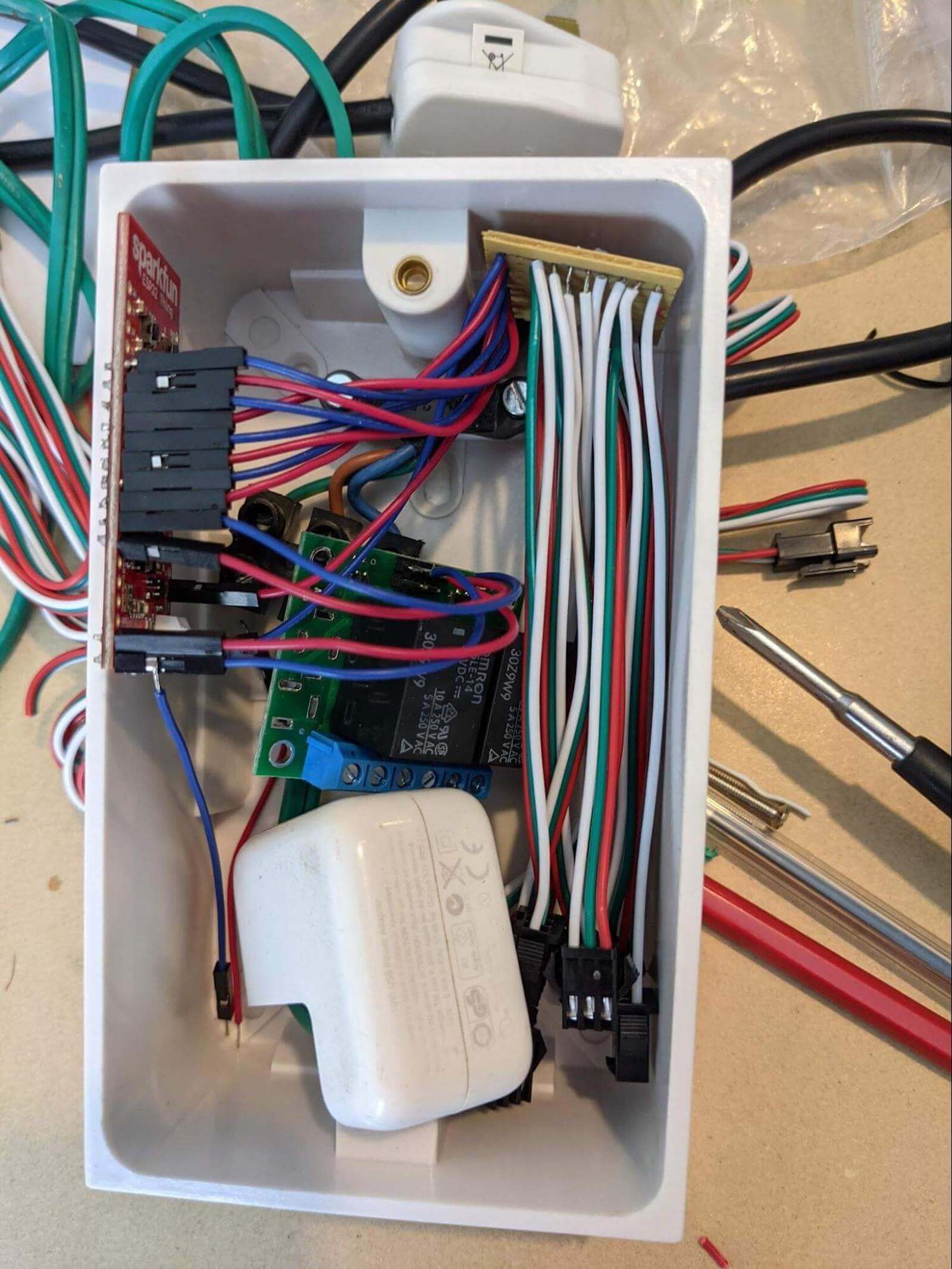

The sensor system is built using an ESP32Thing with 8 x DHT22 temperature/humidity sensors. I used this guide to build the template and modified the code to support eight inputs (top/bottom, left/right, front/back) rather than one, and I used this guide to build the MQTT part.

I needed to build a custom container because I wanted the necessary libraries pre-loaded before the container was loaded onto the cluster. When the container was configured to load the libraries it added a few minutes to the boot time, so I opted for the pre-built container image.

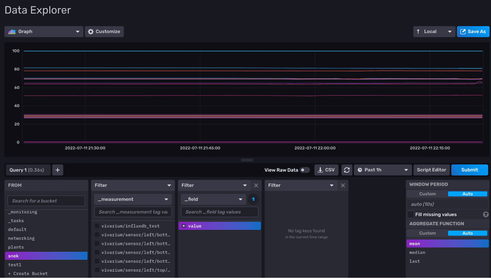

The data from Node-RED is pushed into InfluxDB. I ran InfluxDB as a container — there is a fairly solid starter manifest. I created a bucket called “Snek” at my daughter’s request. It’s still there. The data in Influx is the raw time series with the eight locations and the type, humidity, and temperature. The value is just a floating point number, humidity is 0-100, temperature is in celsius.

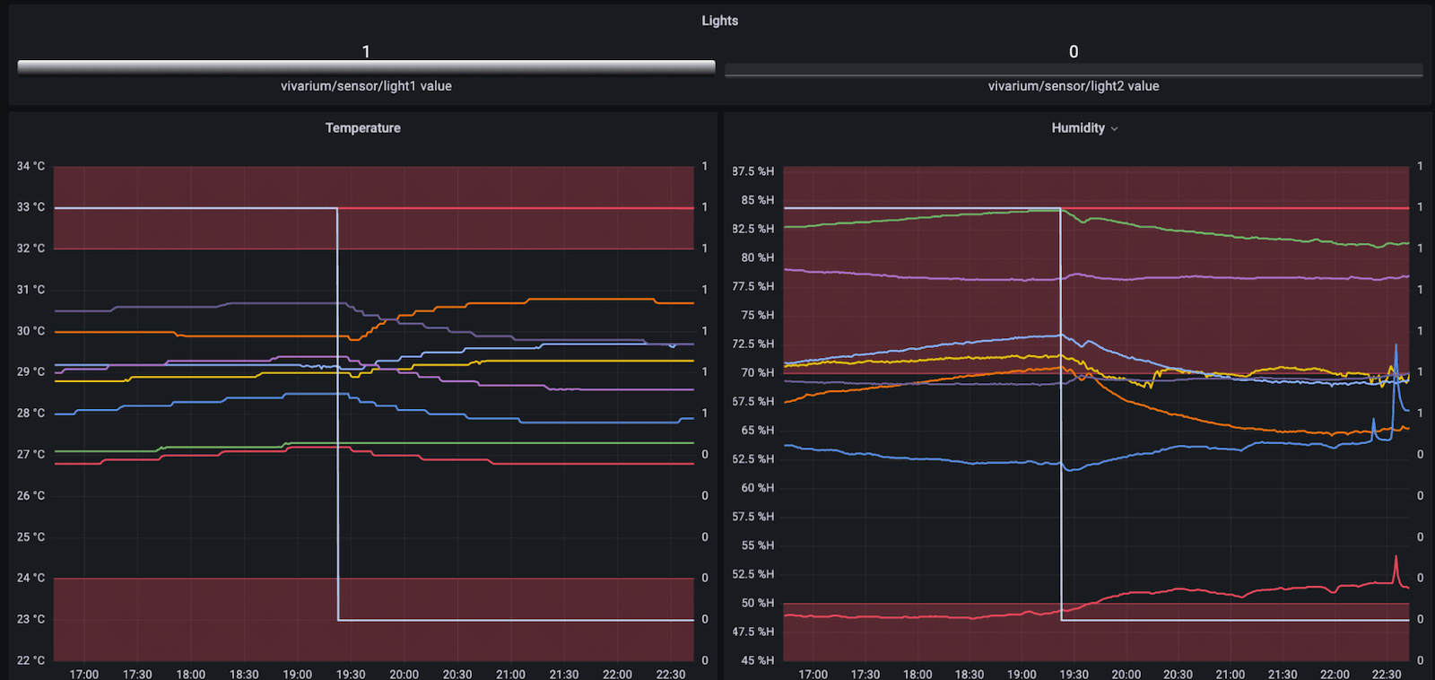

There are three other data points I wanted to track: the status of both the lights, and a test point from Node-RED. The test point gave me a way to alert if it was missing, so I could detect if Node-RED had failed. If influx failed, I would get a source alert in Node-RED.
In the Influx bucket view below, the test point is the top blue line; the humidity range is between the 35-80 mark; the temperature is the tight cluster between 24-32; and the two zero and one lines at the bottom are the light sensors’ readings.

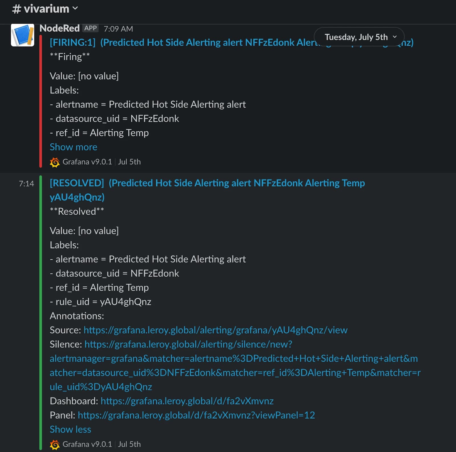

Alerting

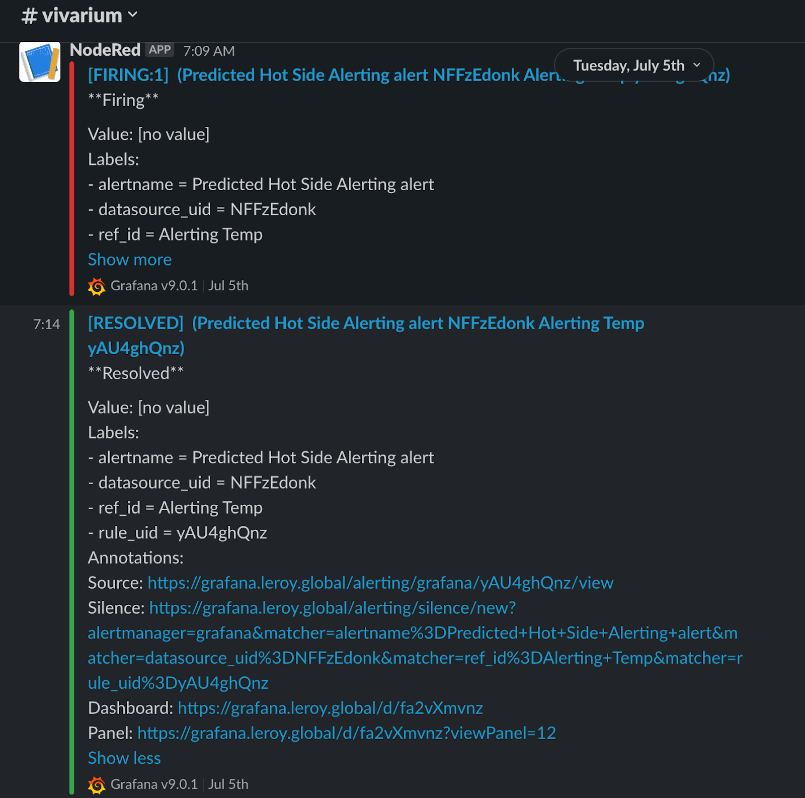

The challenge with this was sending the right alerts around the correct conditions. The temperature is an immediate control problem: If the temperature varies too greatly even for a short period of time, it is detrimental to the snake’s health. The automatic control system is sufficient for this. However, in my current setup the humidity does not have a direct way to be controlled, so alerting a human is critical for fixing that.

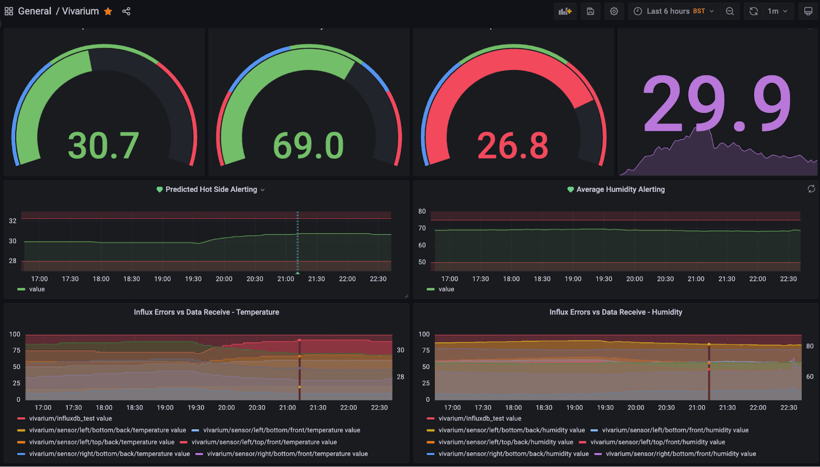

On the dashboard pictured below, we set up critical panels that show the humidity in the vivarium as well as the temperature on the hot side, the cold side (yes, the snake needs a temperature gradient so it can move to where it feels comfortable), and a prediction around the middle zone (where there is no sensor).

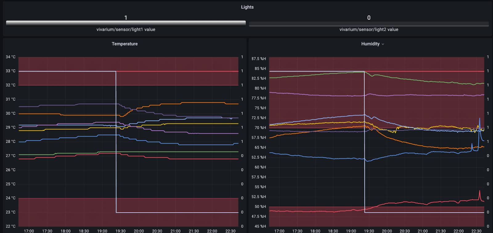

The graphs track humidity and temperature for the over-time analysis used for the alerting. The bottom graphs show the input (and gaps in the data) as well as the Influx test point (which tells me if data is missing from the sensor or Node-RED).
The instantaneous values don’t require aggregation over a long period of time. Influx seems to slow down over large queries (one of the perks of SD cards and Raspberry Pis), so limiting the data for the critical graphs is great. Here is the code for those graphs (filters can be adjusted for any of the sensors):

Monitoring other pieces is quite interesting, because when the daylight light turns off it affects the temperature and humidity. Also, if the snake is active or the door is opened, that would heavily affect the humidity and temperature, too. Here, you can see the cold side is not cold enough, but that is a byproduct of the outside temperature during a heat wave.
The left top front sensor gives the closest reading to the hottest point on the ground, so this is used for the trending graphs with different filters for each of the zones.

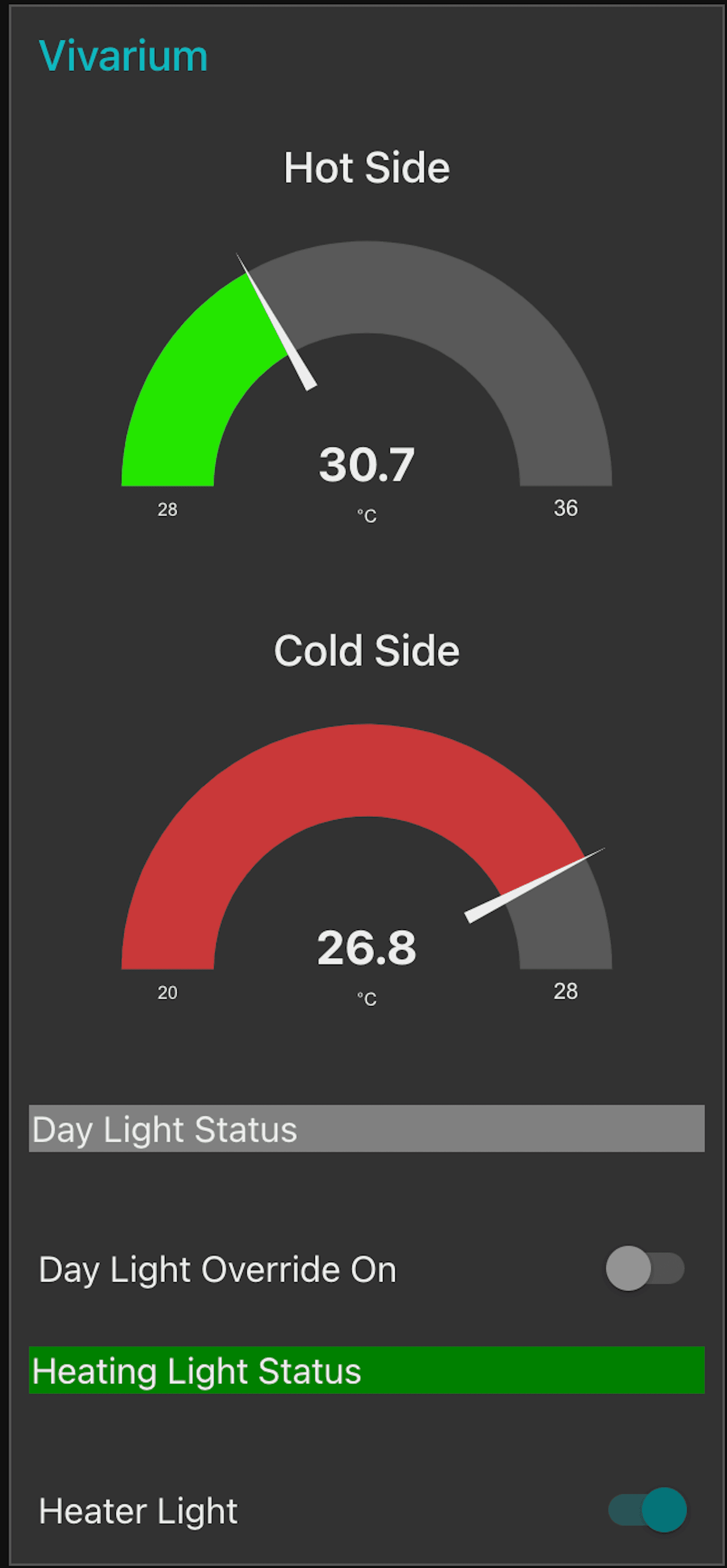

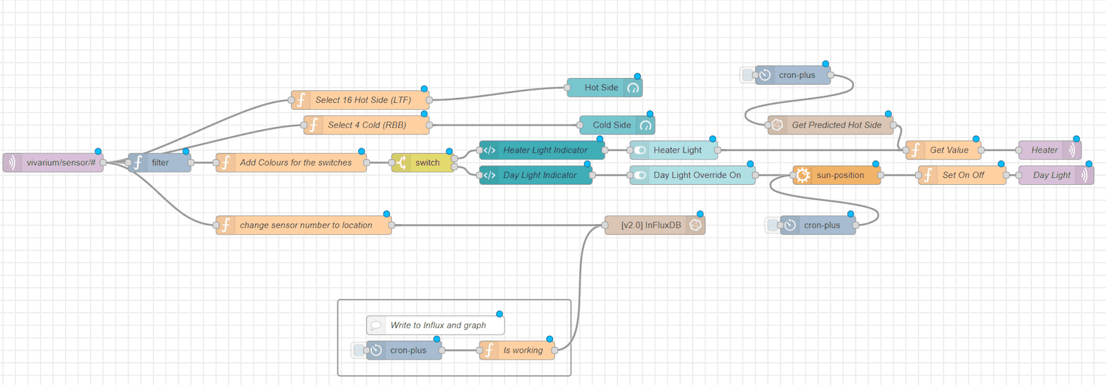

Using the Node-RED UI, we were able to create a simple view and control system in case the temperature was too high and the heater needed to be turned off. It also let me know to turn the light on when Pretzel’s feeding time was after sunset. Control from the internet was crucial if the snake was left for a few days.
For the UI client, it is just an extension of the flow to show the temperature and humidity on the UI. However, I used the input from the switch rather than the output from the flow to indicate whether the lamps were on or off. This means that after the signal to turn on or off the flow would wait to get the confirmation from the ESP32 to verify the control signal had been sent. It would take one of the unknowns out of the loop (did the light actually turn on/off?).

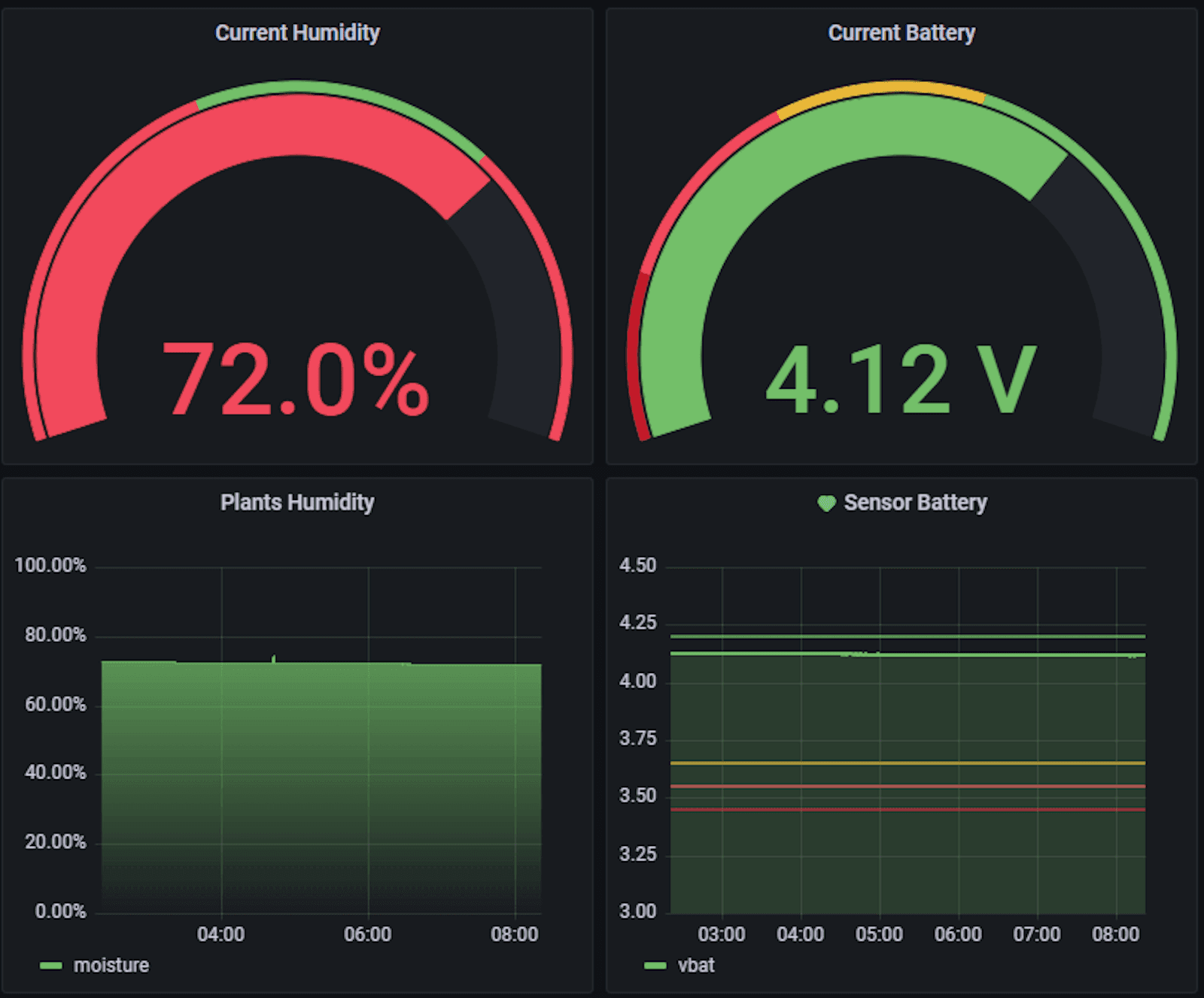

It would be paired with a dimmer control rather than an on-off switch. Here are two of the panels.
