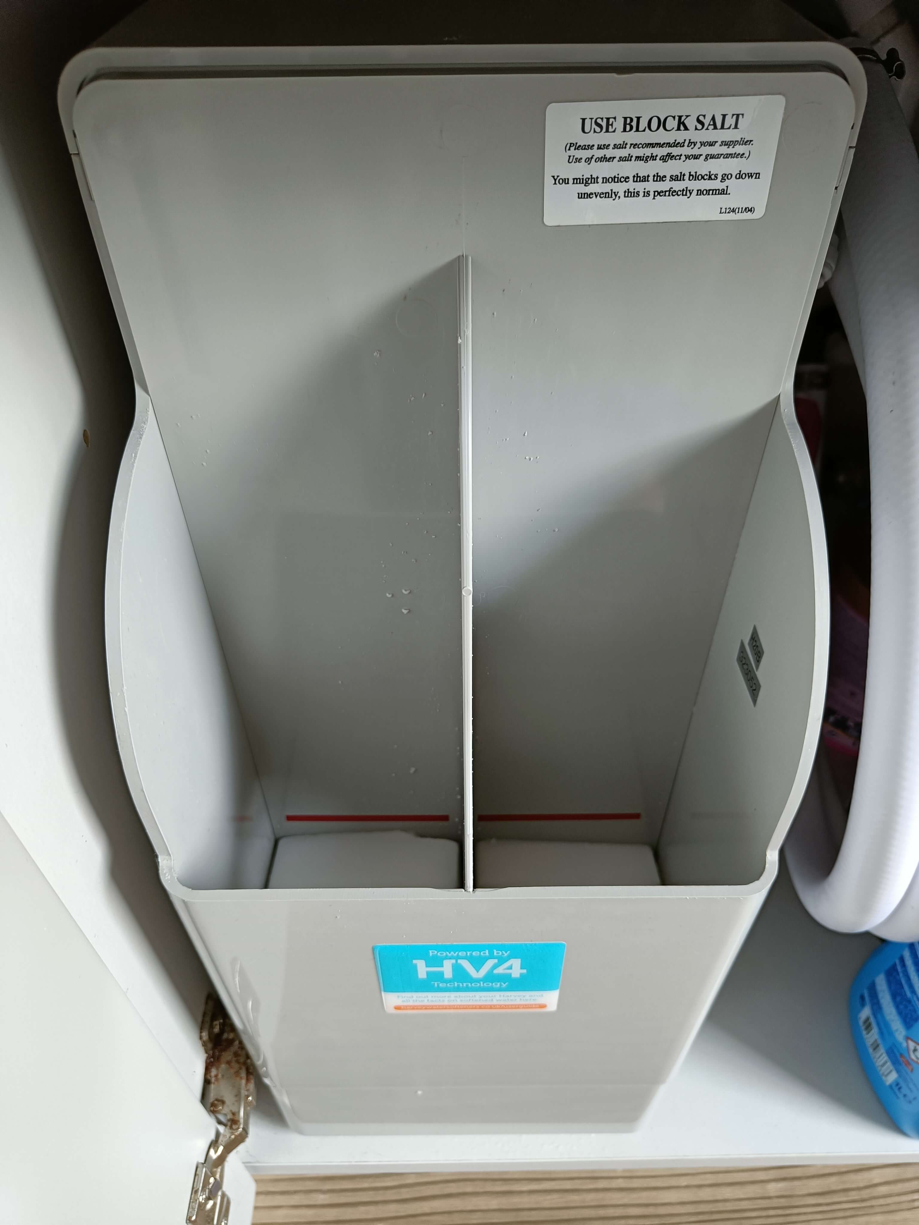

This is a picture of what my basic water softener looked like. The red lines indicate it’s time for a new salt block.

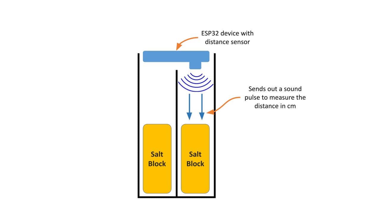

You can see the design here. When the distance measured reaches 30 cm, it’s time to top up with a new salt block.

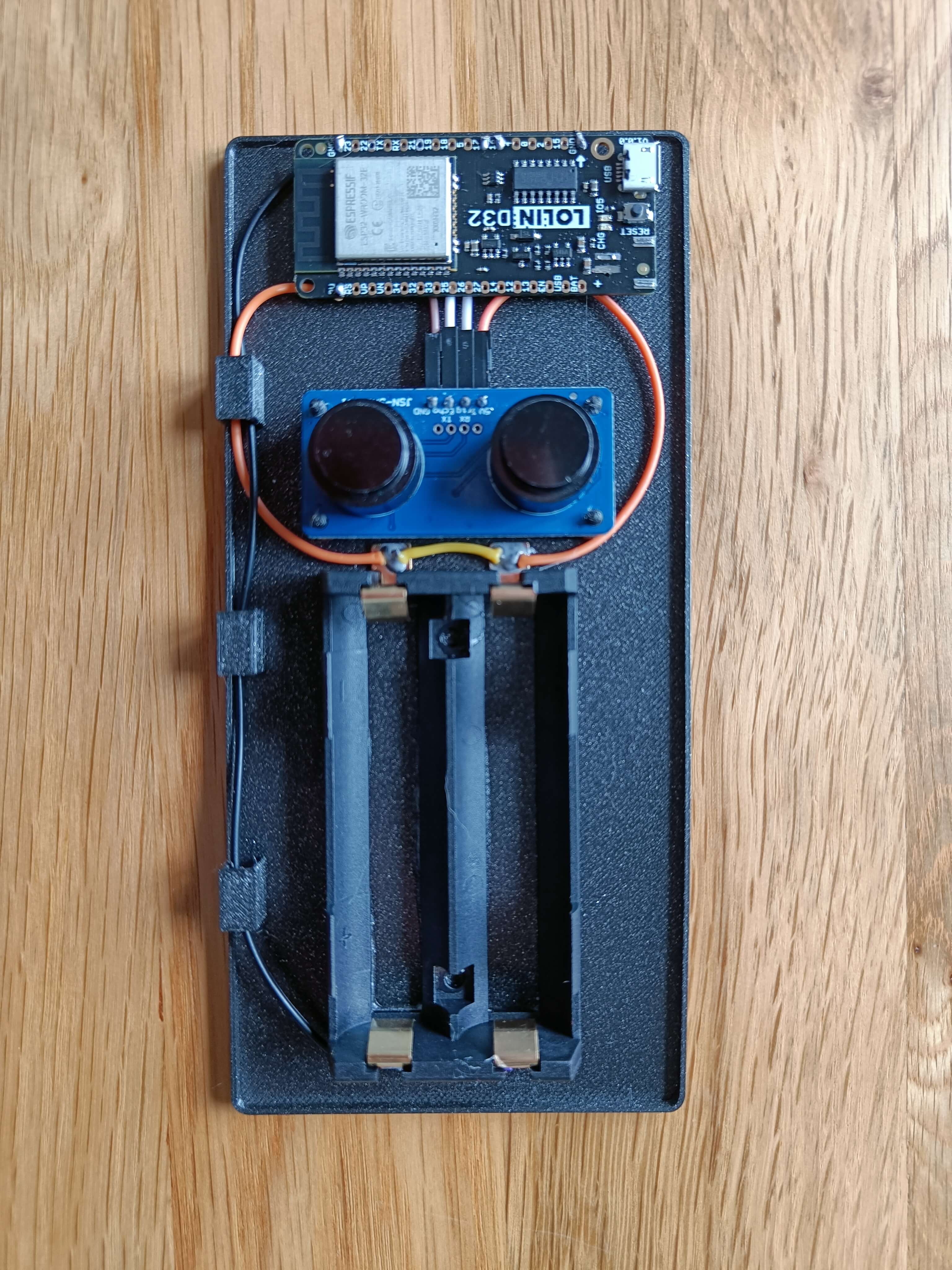

Below, you can see my assembled circuits, sensor, battery holder, and wires.
Embedded image

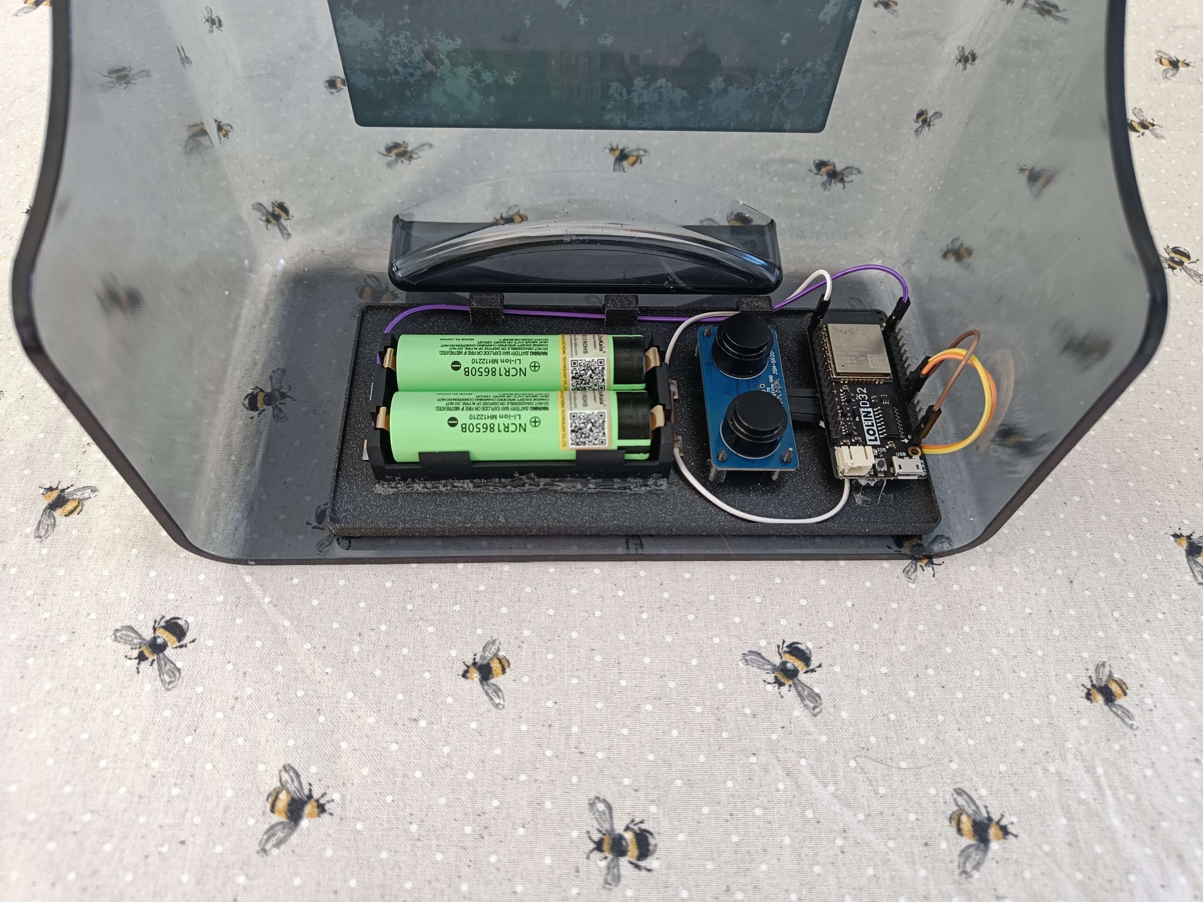

And here is the assembled device glued to the water softener lid. (It gets turned over when it’s installed.)
Embedded image

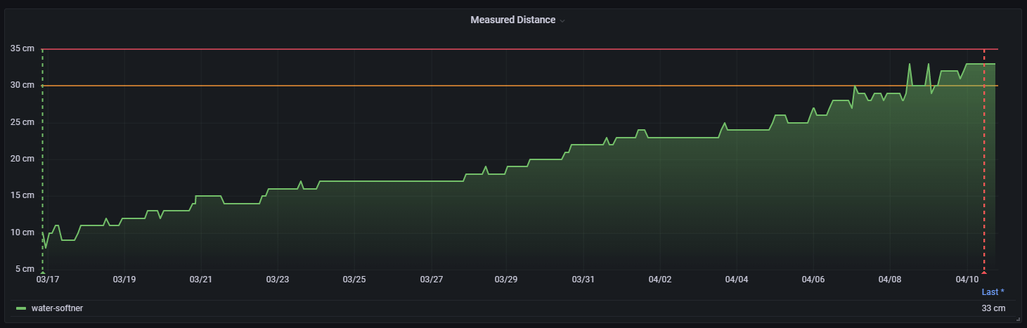

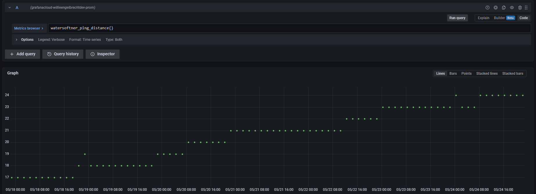

Over a period of a month, the sensor collects the data at a constant two-hour interval rate, as demonstrated in the graph below. The graph slowly trends upwards until it reaches a distance of about 30 cm (orange threshold line), at which point Grafana will start to send out alert emails. At 35 cm (red threshold line) the salt will be completely gone.
Embedded image

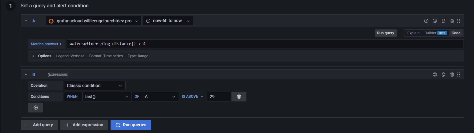

I used this metric to query in Grafana, using the PromQL language:
Embedded image
Here’s how I configured it to send an alert when the value of the measurement is more than 30 cm:
Embedded image

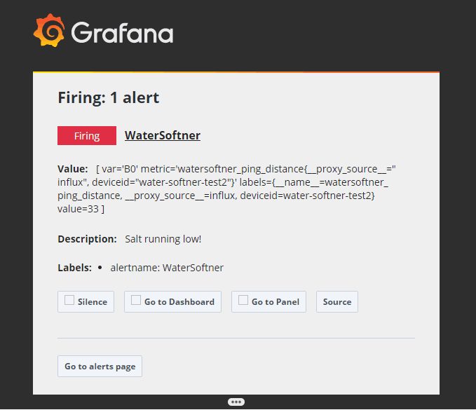

This is what appears in my inbox when the alert is triggered:
Embedded image
