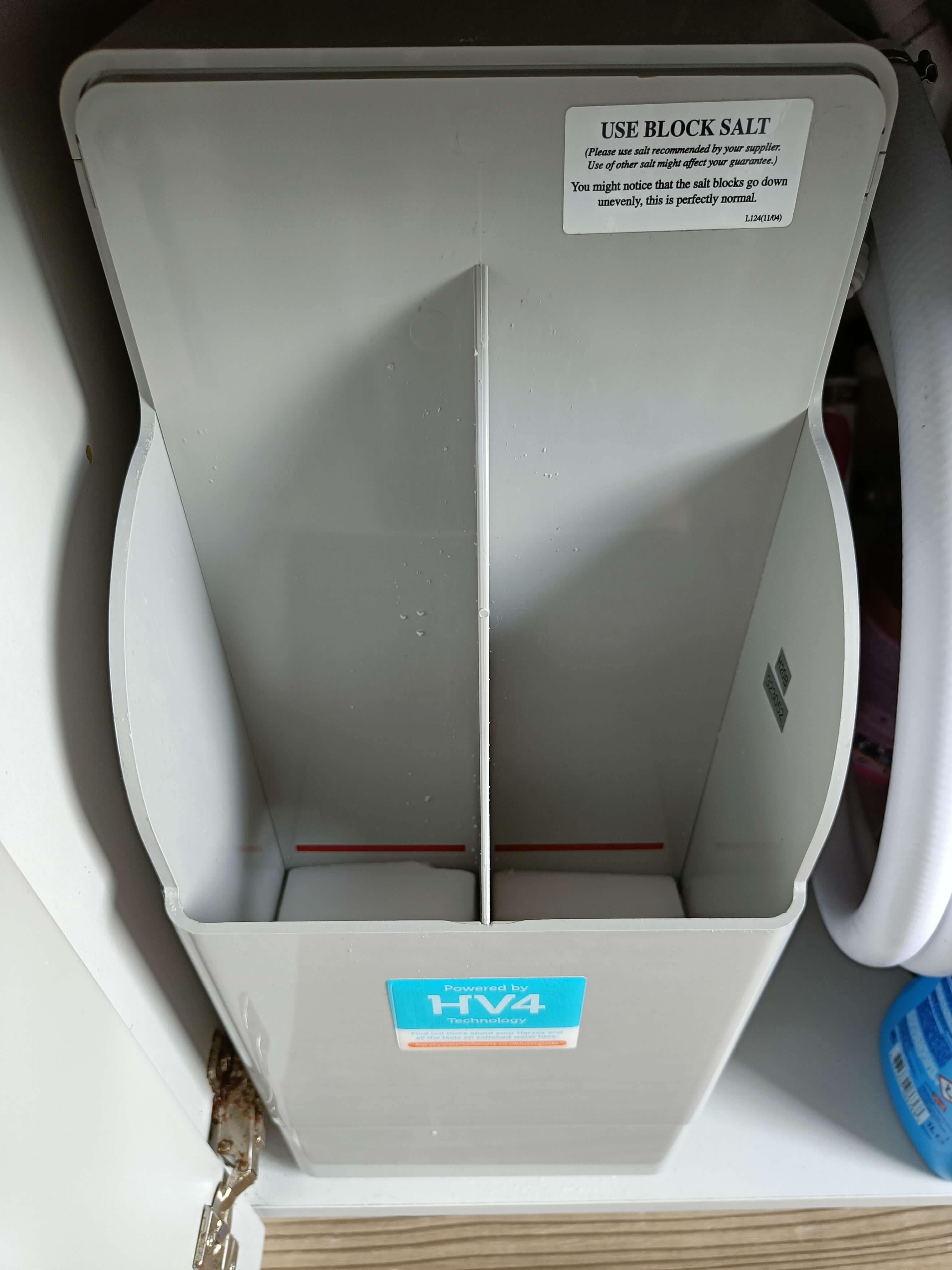

This is a picture of what my basic water softener looked like. The red lines indicate it’s time for a new salt block.

On the electronics side, there were a couple of issues I needed to address: The ESP32 microcontroller isn’t capable of running a fully-fledged OS and Grafana agent. I also needed to be mindful of preserving my battery life, which meant I didn’t need the controller to send updates every 60 seconds. The level of salt remaining does not change that quickly (it’s about 30 cm over a period of a month), so a measurement once a day could even suffice. I decided to update once every two hours as part of my testing.

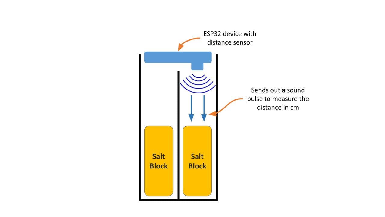

You can see the design here. When the distance measured reaches 30 cm, it’s time to top up with a new salt block.

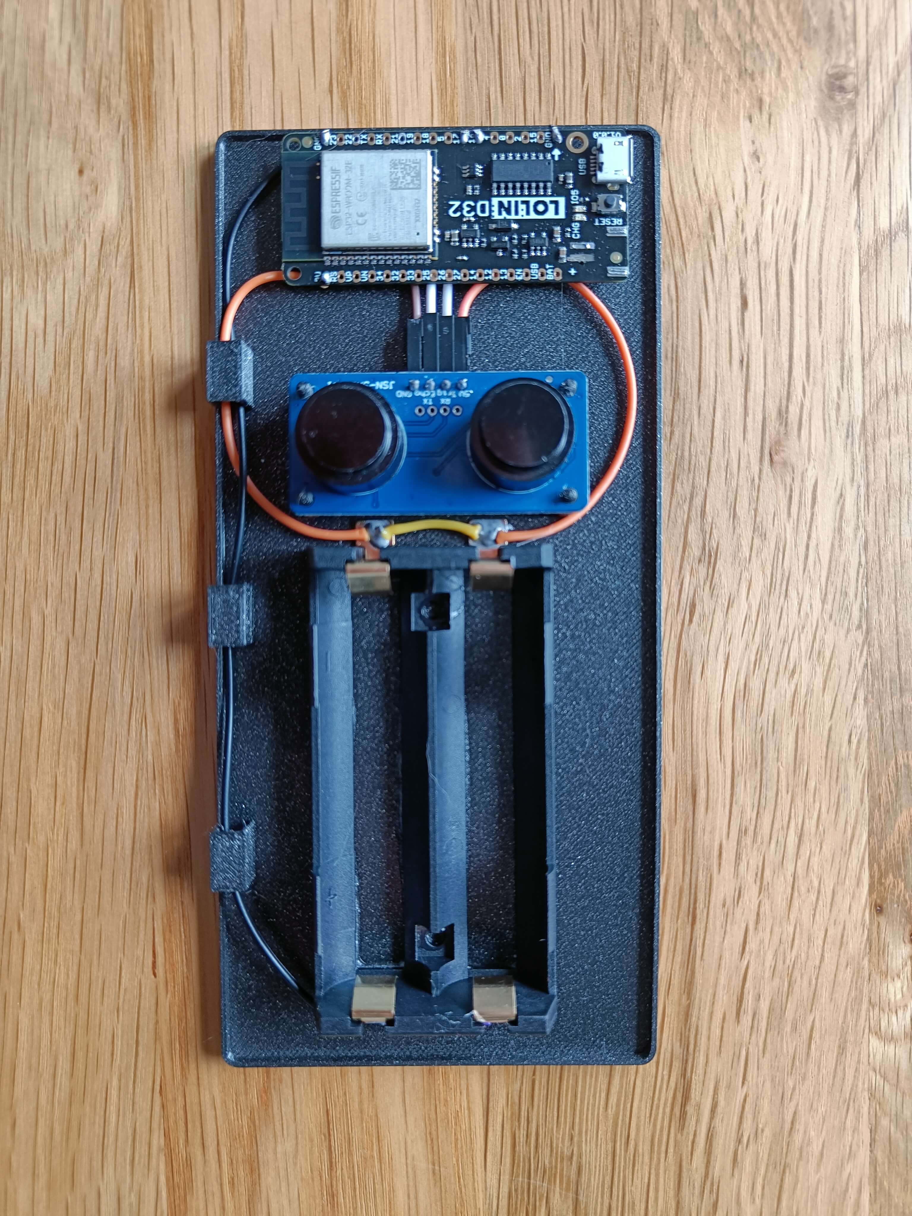

Below, you can see my assembled circuits, sensor, battery holder, and wires.
Embedded image

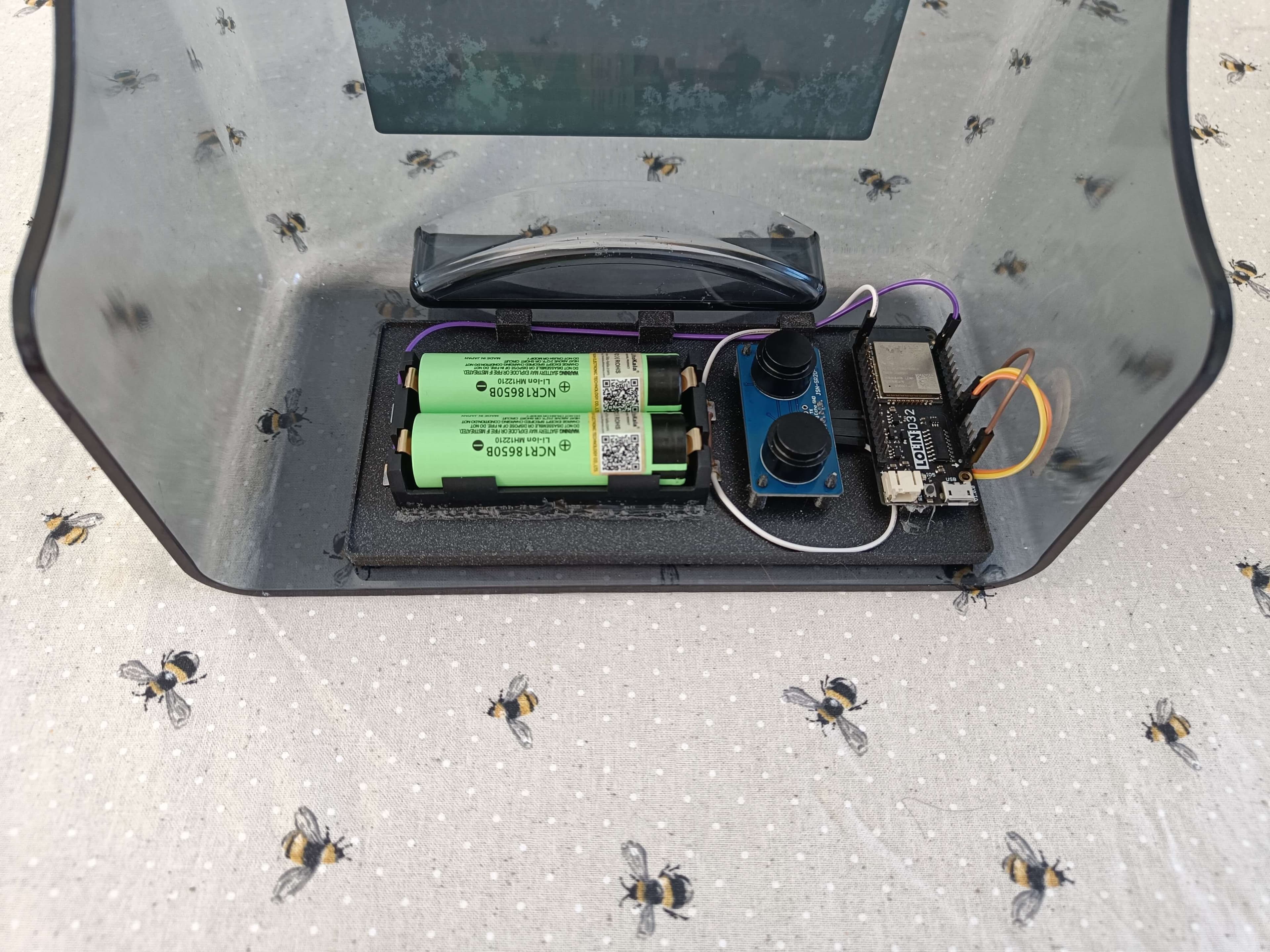

And here is the assembled device glued to the water softener lid. (It gets turned over when it’s installed.)
Embedded image

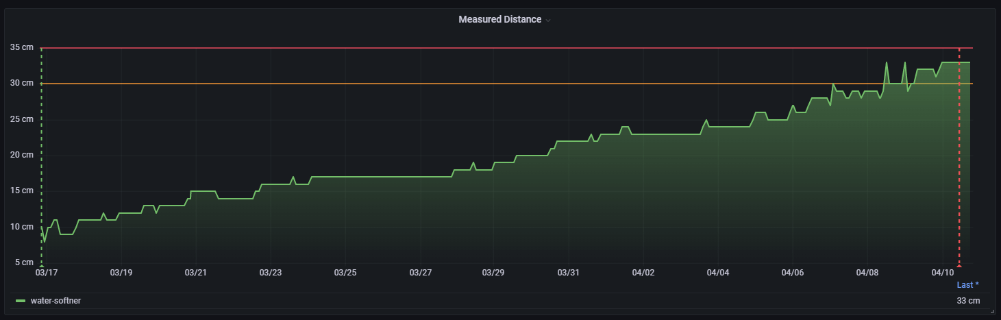

Over a period of a month, the sensor collects the data at a constant two-hour interval rate, as demonstrated in the graph below. The graph slowly trends upwards until it reaches a distance of about 30 cm (orange threshold line), at which point Grafana will start to send out alert emails. At 35 cm (red threshold line) the salt will be completely gone.
Embedded image

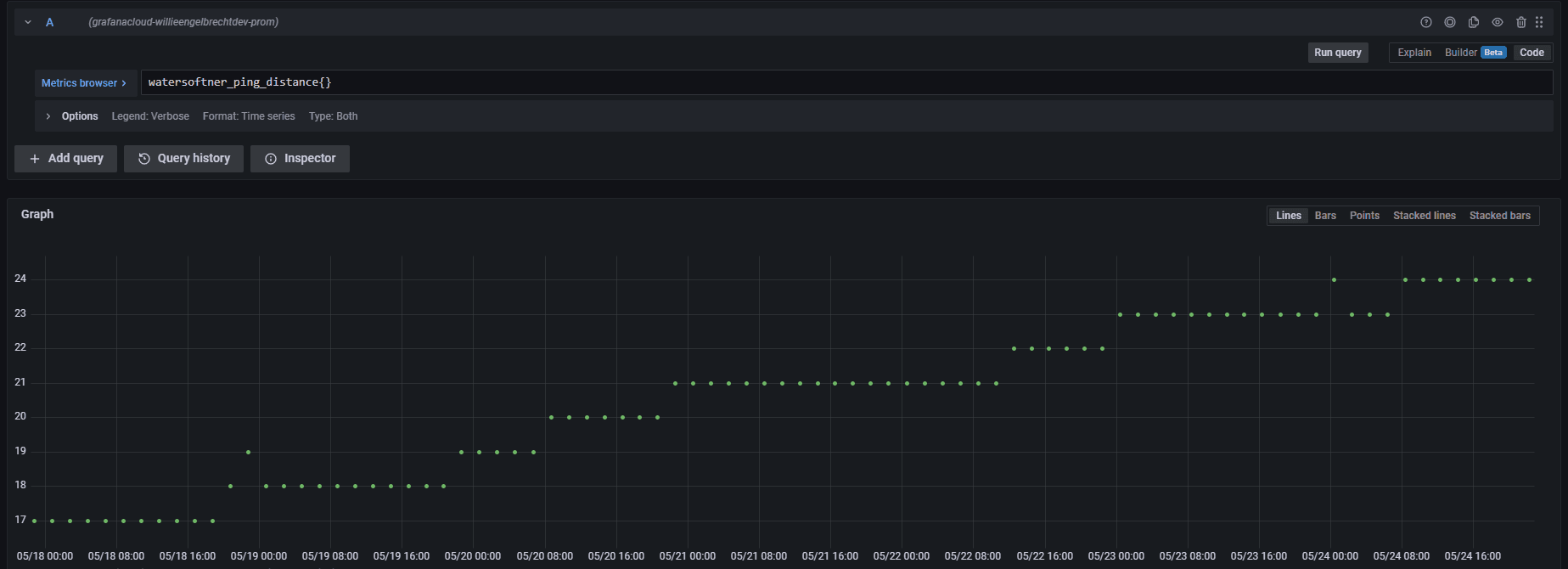

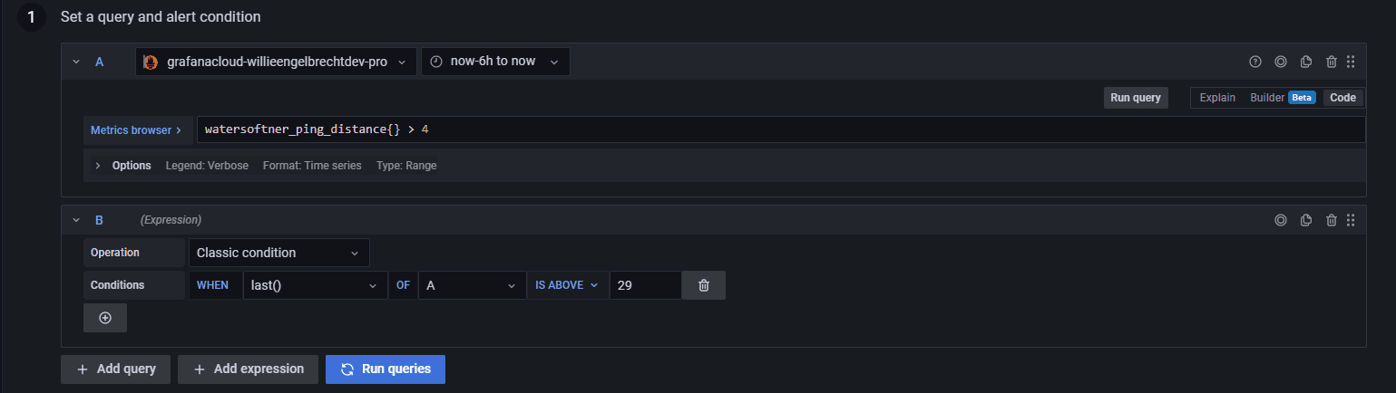

I used this metric to query in Grafana, using the PromQL language:
Embedded image
Here’s how I configured it to send an alert when the value of the measurement is more than 30 cm:

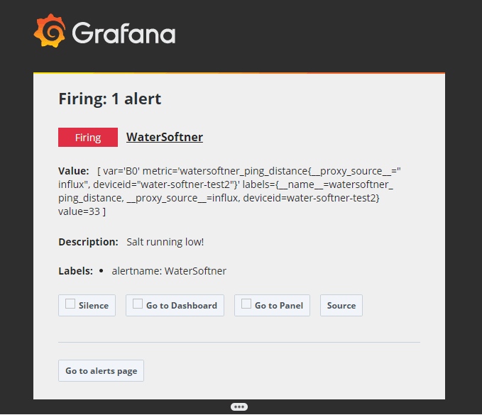

This is what appears in my inbox when the alert is triggered:
Embedded image
