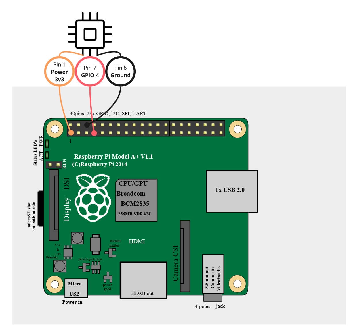

After meeting the requirements above, our first step is to connect our DHT22 sensor with the Raspberry Pi computer.
The DHT22 sensor comes with three pins that we will connect to the Raspberry Pi pins with jumper wires that have female ends. On the DHT22 sensor, the power supply is represented with the positive symbol “+,” the data output as “out,” and the ground wire with the negative symbol “-.”
To connect the sensor to the Raspberry Pi board, we need to:
- Connect the power supply (+) to pin 1 (3v3 power)
- Connect the data output wire to pin 7 (GPIO 4)
- Connect the ground (-) wire to pin 6 (Ground)
(Tip: The pins on the Raspberry Pi board can be easily identified by counting. Place the Raspberry Pi in front of you, so you see two rows of pins at the top. The bottom row is numbered with odd numbers — 1,3,5, etc. — and the row above it is numbered with even numbers — 2,4,6, etc.)

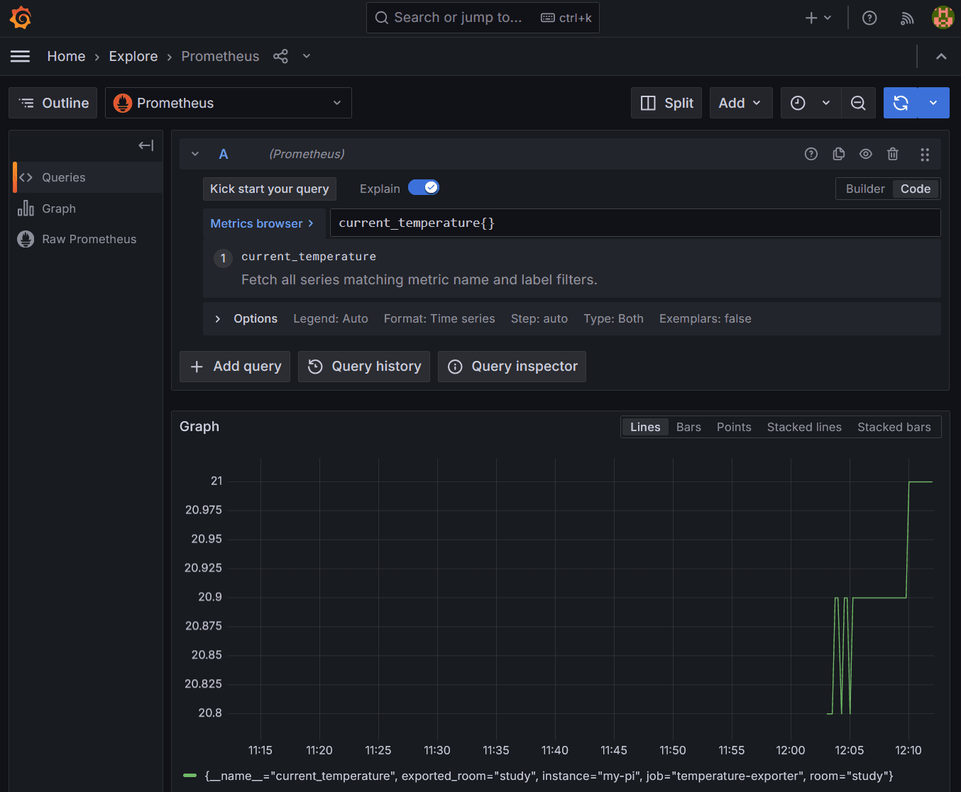

Monitor your temperature and humidity data from Grafana
Now that we understand how metrics are exported by our Python app, stored, and collected by Prometheus, we can move on to monitoring sensor data in Grafana.
- From your machine, access your Raspberry Pi by entering the IP address into the browser: http://{you-raspberry-pi-IP-address}:3000.
- You should be automatically logged in to Grafana.
- Open the side menu.
- Click Explore.
- Select Prometheus from the dropdown menu at the top left corner.
- Click Metrics browser and select
current_temperature. - Click the run query button at the top right corner. You should see temperature data graphed.

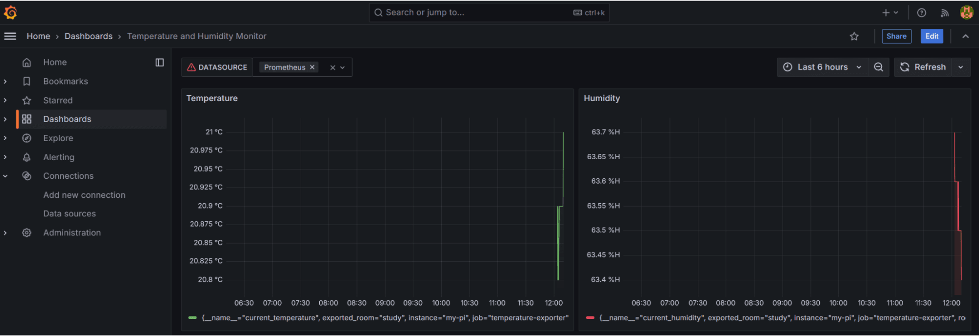

- Click Add > Add to dashboard > Open dashboard. This will take the query that you’ve been working on and save it as a panel on a Grafana dashboard.

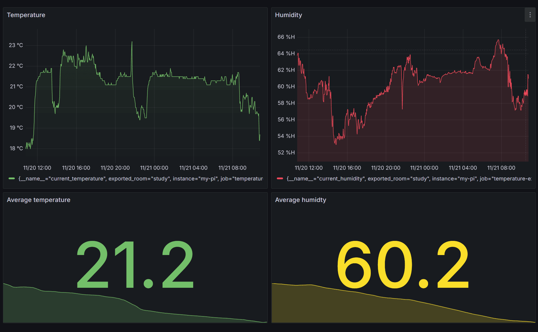

You made it!
From here you can create a second panel to monitor the current_humidity .
For inspiration or reference, import the sample dashboard provided for this tutorial by using its ID. In Grafana, go to Home > Dashboards > Import, enter the ID 22406, and click Load. Adjust it to fit your needs.
