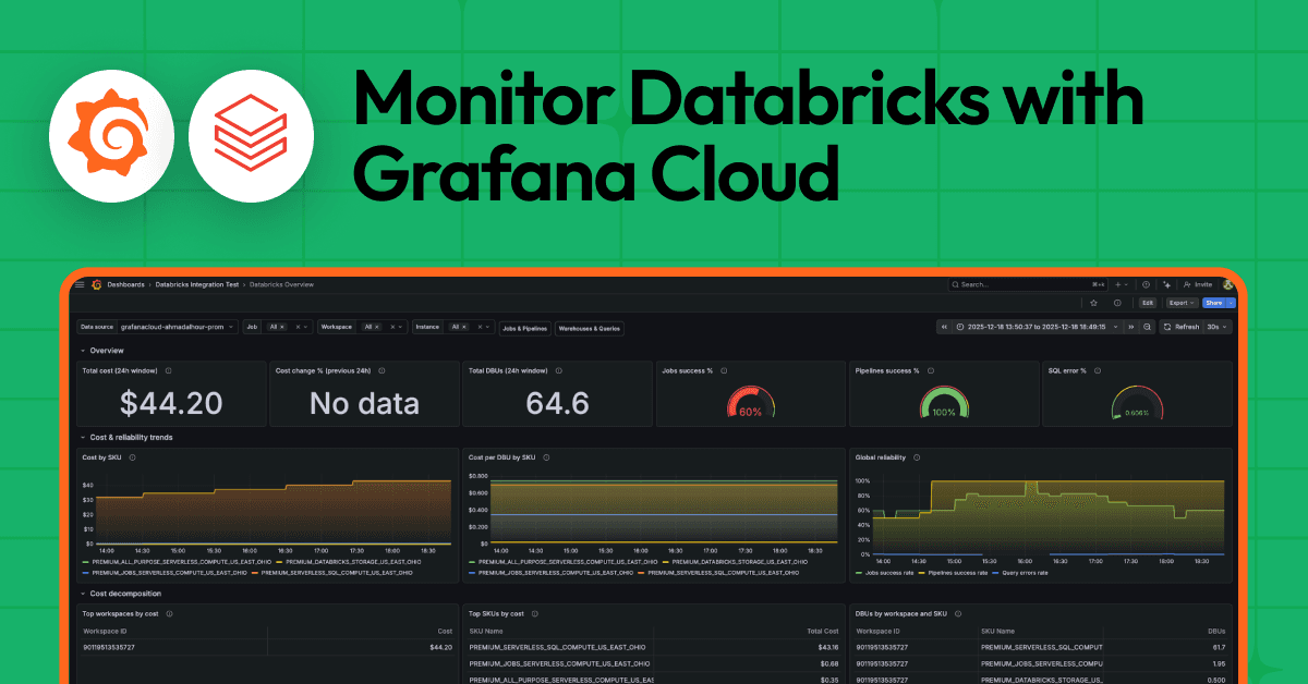

What you get: dashboards
This integration comes with three prebuilt dashboards you'll see in your Grafana instance once you've installed it.
Databricks overview
This is essentially your executive summary: costs, DBU consumption, and high-level reliability metrics. It's intended to serve as a high-level snapshot so you can quickly spot anomalies and track overall platform health.
At the top, you'll see stat panels with the numbers that matter: total cost over the past 24 hours, day-over-day cost change, total DBUs consumed, and aggregate success rates for jobs and pipelines. Below that, time series panels show trends over time, and tables break down costs by SKU and workspace.
The overview dashboard for the Databricks integration in Grafana Cloud
