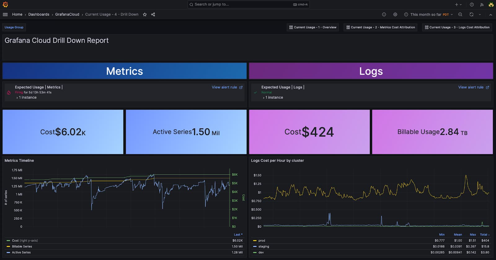

Grafana Cloud offers tools like the billing/usage dashboard to gain a detailed breakdown of monthly usage with a straightforward pricing framework — active series and data points per minute (DPM). With these out-of-the-box dashboards, customers not only get transparency on usage. They also get tools to systematically deal with metrics explosion as they scale. Apart from OOTB dashboards, we have seen our customers leverage the power of Grafana visualizations to create custom dashboards that give them a visual summary of how your costs are trending.
Screenshot of usage insights dashboard in Grafana CloudScreenshot of billing dashboard in Grafana Cloud.
