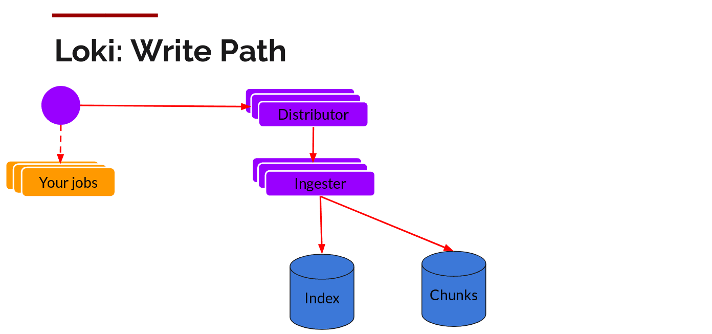

The write path and read path (query) are pretty decoupled from each other and it helps to talk about it each separately. Loki: Architecture!

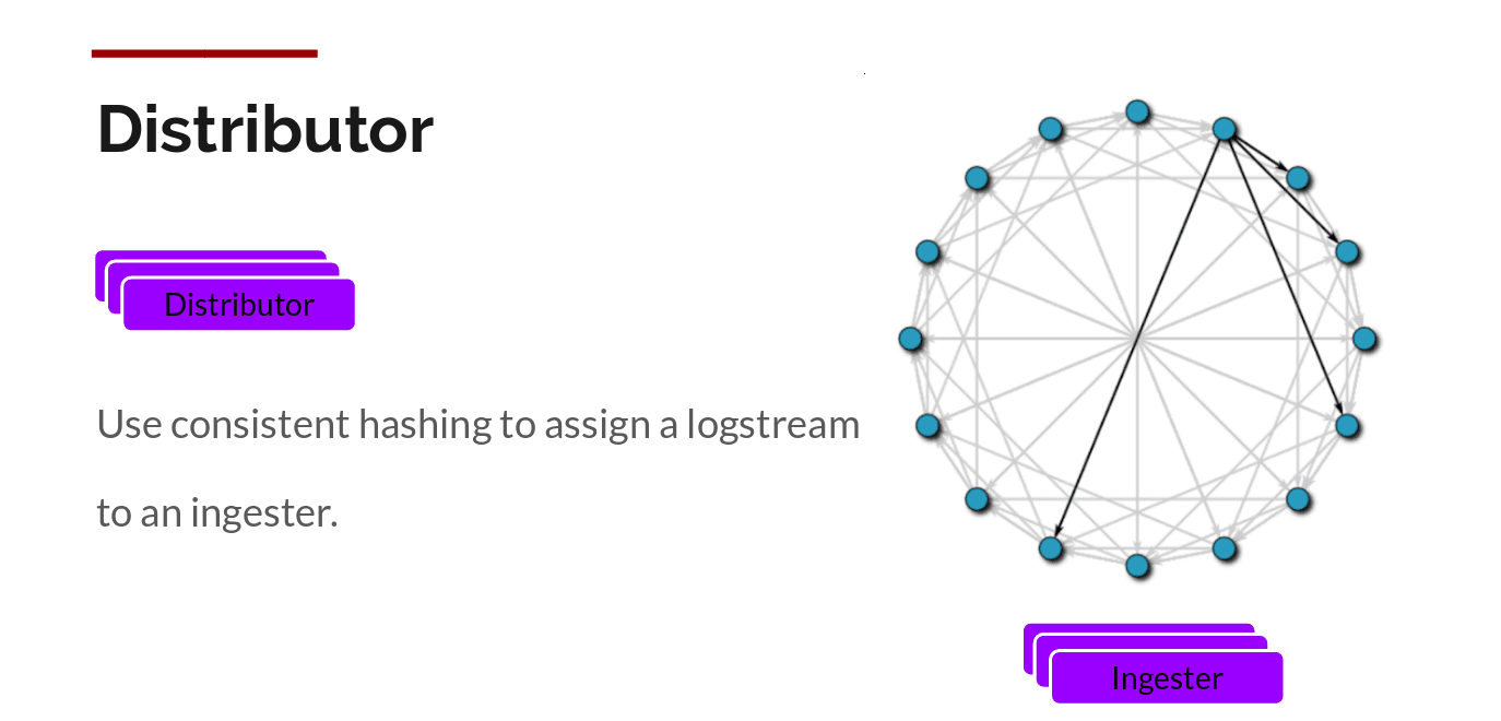

Distributor
Once promtail collects and sends the logs to Loki, the distributor is the first component to receive them. Now we could be receiving millions of writes per second and we wouldn’t want to write them to a database as they come in. That would kill any database out there. We would need batch and compress the data as it comes in.
We do this via building compressed chunks of the data, by gzipping logs as they come in. The ingester component is a stateful component in charge of building and then later flushing the chunks. We have multiple ingesters, and the logs belonging to each stream should always end up in the same ingester for all the relevant entries to end up in the same chunk. We do this by building a ring of ingesters and using consistent hashing. When an entry comes in, the distributor hashes the labels of the logs and then looks up which ingester to send the entry to based on the hash value. Loki: Distributor
Further, for redundancy and resilience, we replicate it n (3, by default) times.

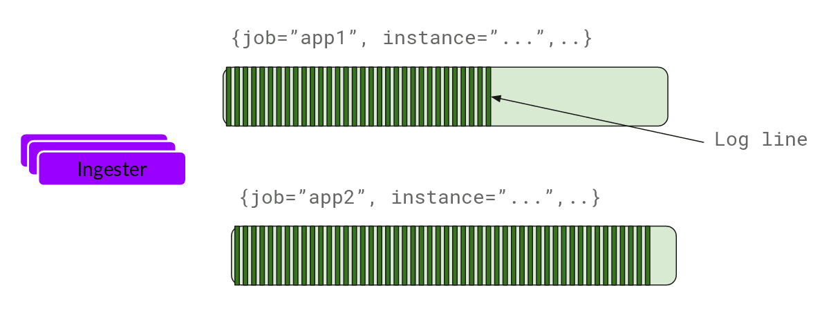

Ingester
Now the ingester will receive the entries and start building chunks. Loki: Ingester
This is basically gzipping the logs and appending them. Once the chunk “fills up”, we flush it to the database. We use separate databases for the chunks (ObjectStorage) and the index, as the type of data they store is different.
After flushing a chunk, the ingester then creates a new empty chunk and adds the new entries into that chunk.

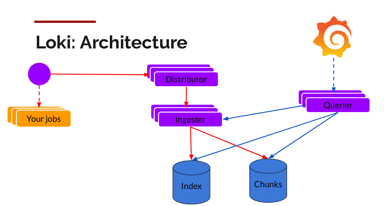

Querier
The read path is quite simple and has the querier doing most of the heavy lifting. Given a time-range and label selectors, it looks at the index to figure out which chunks match, and greps through them to give you the results. It also talks to the ingesters to get the recent data that has not been flushed yet.
Note that, right now, for each query, a single querier greps through all the relevant logs for you. We’ve implemented query parallelisation in Cortex using a frontend and the same can be extended to Loki to give distributed grep which will make even large queries snappy enough.
Loki: A look at the Querier
