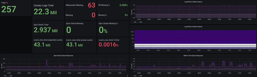

Moving on to the Loki Canary: I won’t go into too much detail because this will be explained in a future blog post, but the canaries are now much more aggressive about checking for data integrity, including spot checking for logs over a longer time window and running metric queries to verify count_over_time accuracy. Details can be found in PR 2344.

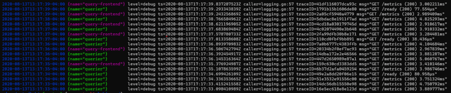

The last thing I would like to call some attention to are some really slick additions to the command line query tool LogCLI. PR 2470 allows you to color code your log lines based on their stream labels for a nice visual indicator of streams.
