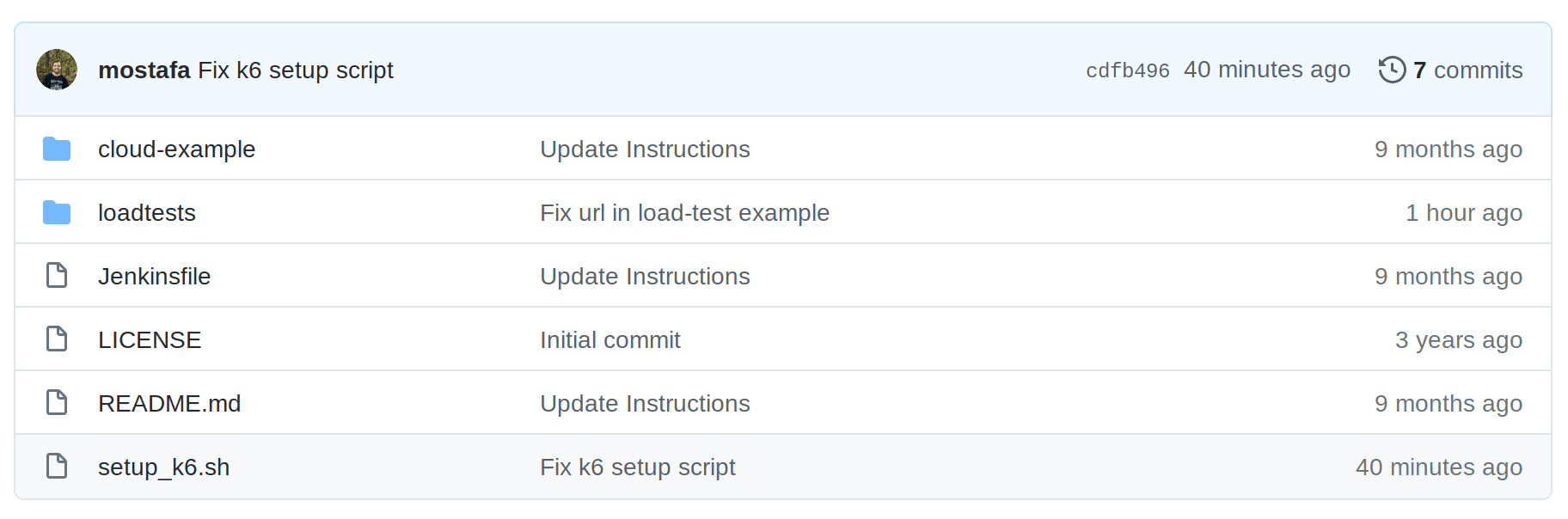

In the root of your project folder, create a file named Jenkinsfile. This configuration file will trigger the CI to build whenever a push to the remote repository is detected. If you want to know more about it, check out the tutorial: Using a Jenkinsfile.
Alongside the Jenkinsfile, we’ve added the script setup_k6.sh which installs k6 on the runner. For other ways to install k6, check out the k6 installation documentation.

Eventually, your repository should look like the following screenshot. You can also fork the k6-jenkins-example repository.
GitHub repo

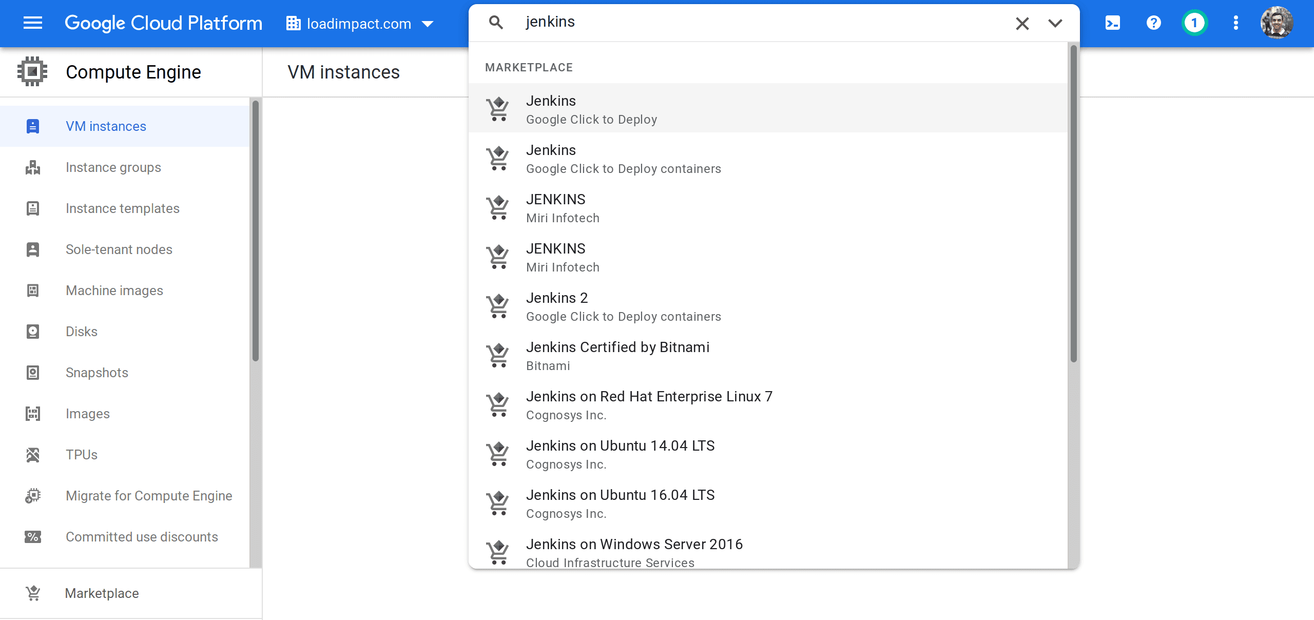

In this demonstration, we’ve installed Jenkins on a Google Compute Engine (GCE) instance on Google Cloud Platform (GCP). It’s pretty easy to get this up and running, use the Google Cloud Deployment Manager. Simply search for “jenkins” in the top search bar and select the Jenkins option with”click to deploy” which is the 1st option in the screenshot below. This will install Jenkins on a Debian GNU/Linux virtual machine as a GCE instance.
Further instructions will be provided by the GCP platform, which includes a Jenkins instance URL and credentials plus SSH access to the virtual machine.
Install Jenkins with Google Cloud

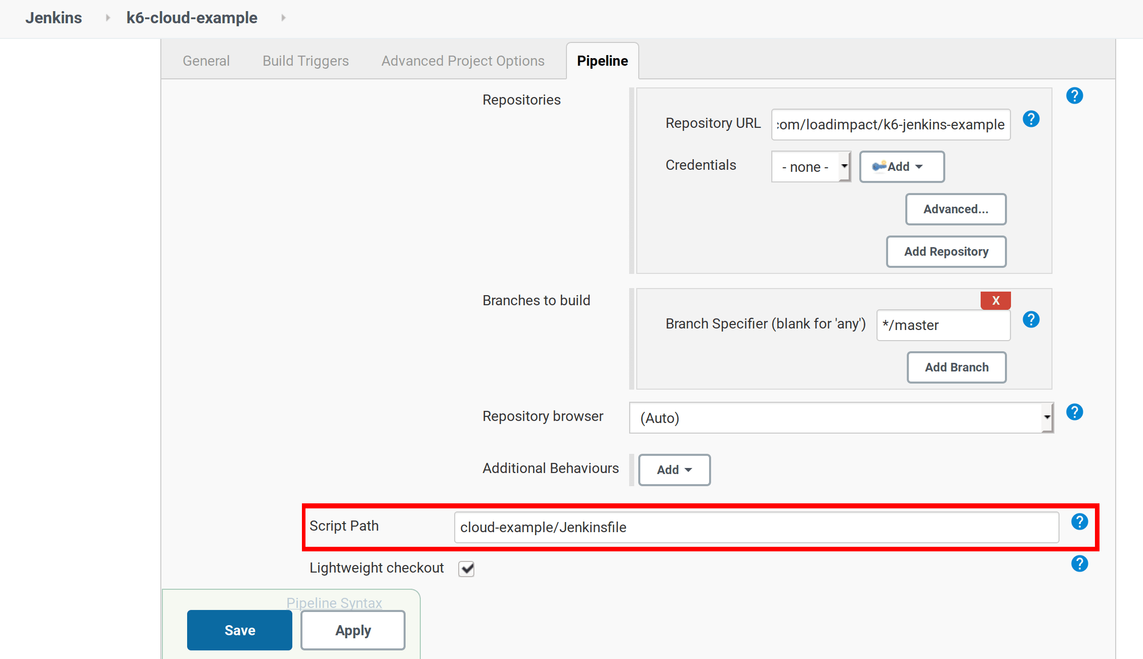

Assuming you have your GitHub repository set up and Jenkins pipeline job created, it’s time to integrate Jenkins with GitHub. You should create a token for the user on Jenkins and use that token along with the Jenkins instance URL to create the webhook.

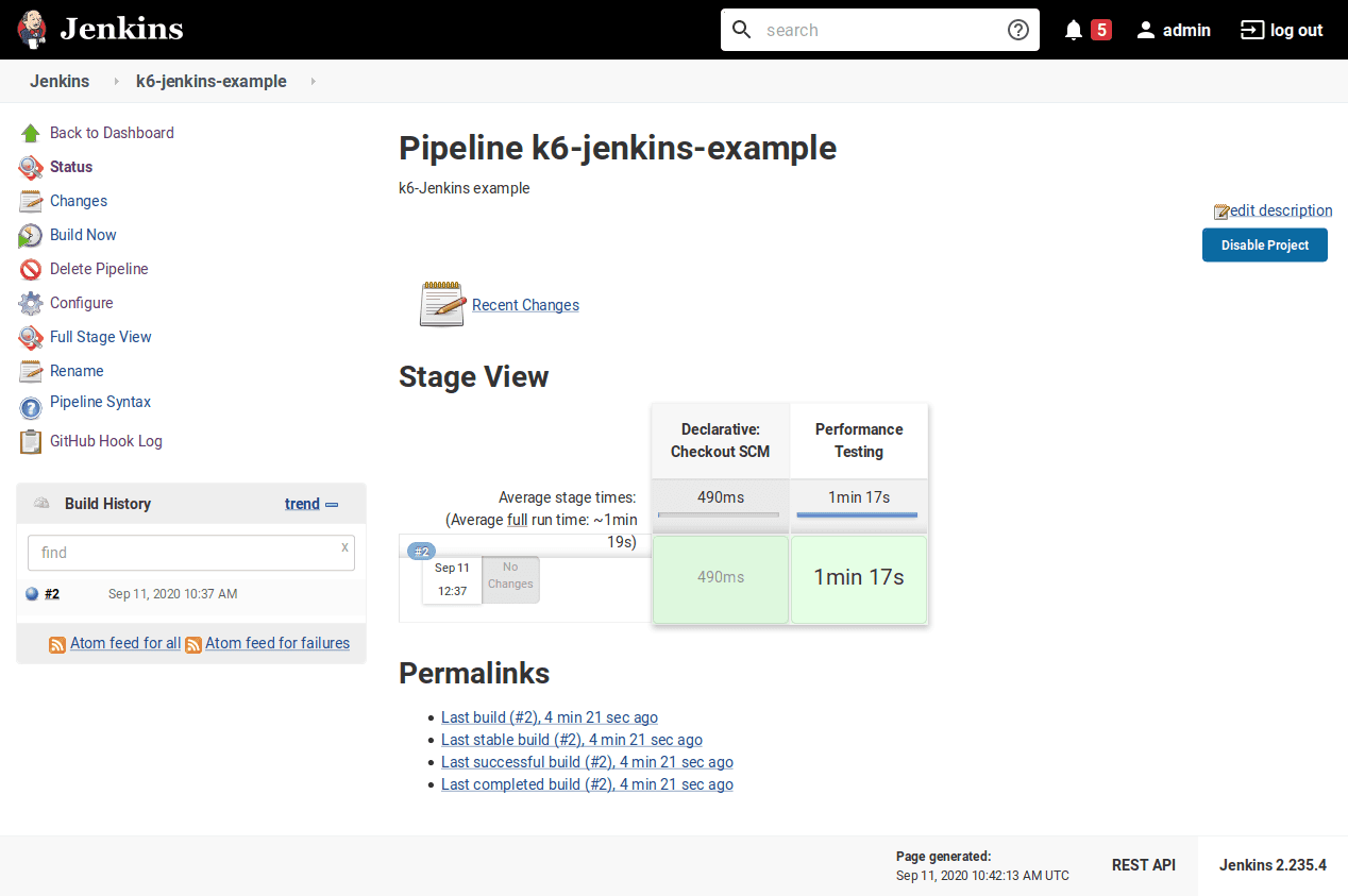

While in the Jenkins dashboard, head over to the pipeline you created and press Build Now to see the pipeline fetch the latest changes from your repository and run the tests.
Jenkins build

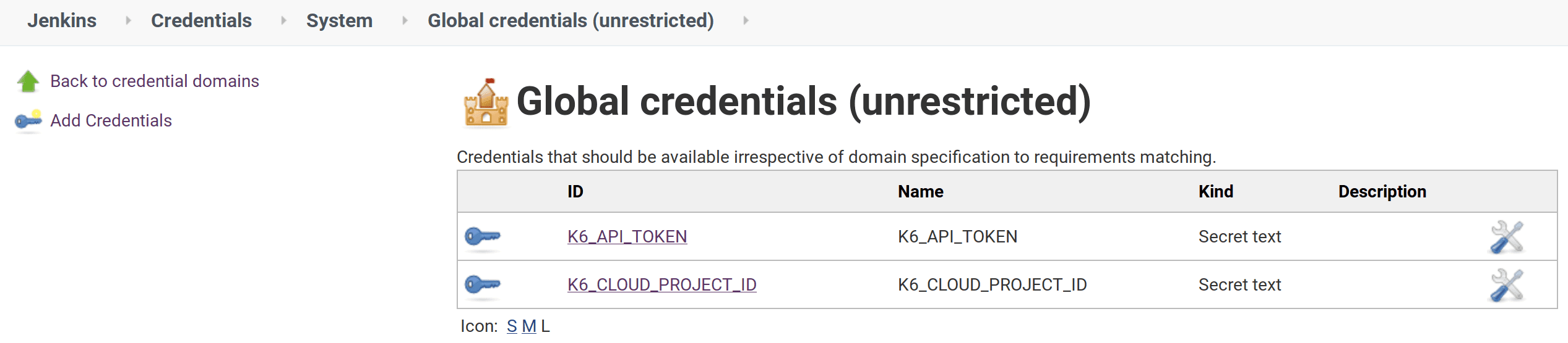

After that, go to the Personal API token page on Testing & synthetics -> Performance -> Settings in Grafana Cloud k6 and copy your API token. You also need your project ID to be set as an environment variable. The project ID is visible under the project name in the Grafana Cloud k6 project page.
Head over to https://<jenkins-instance-url>/credentials/ and add K6_API_TOKEN to global credentials as secret text.

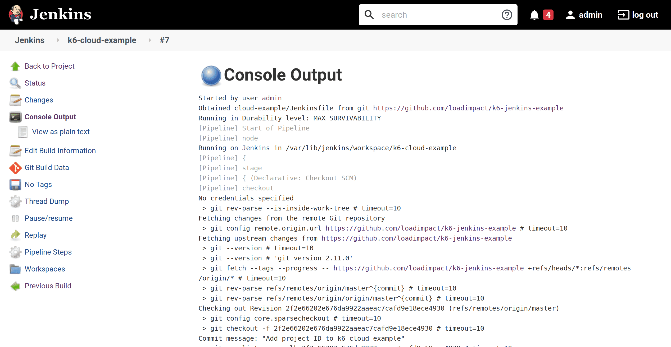

With that done, we can now go ahead and push the changes we’ve made in cloud-example/Jenkinsfile to our GitHub repository. This subsequently triggers Jenkins to build our new pipeline. Just keep in mind that since the changes to the Jenkinsfile is in another directory, you should also create a new pipeline job for it.
Jenkins example

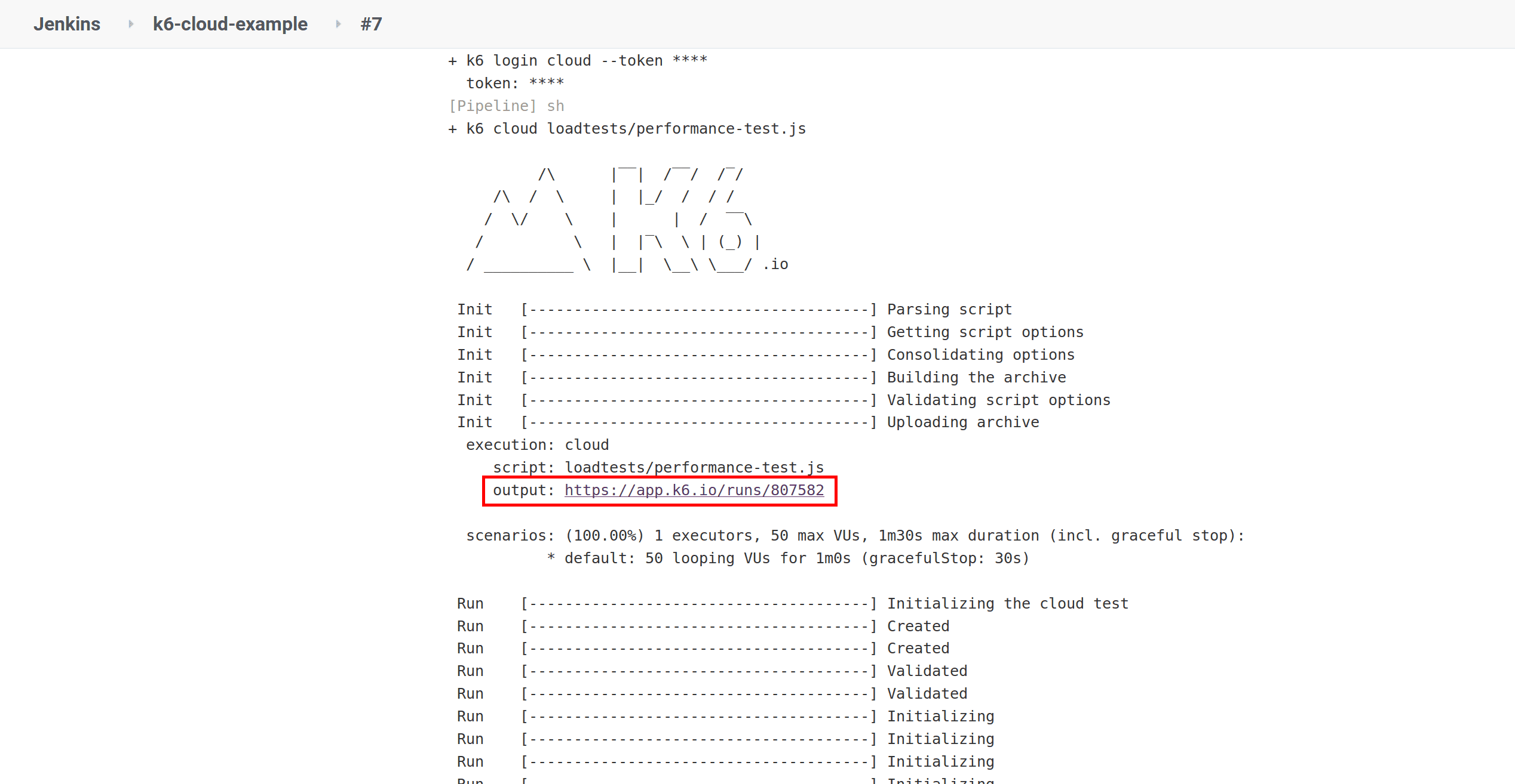

And when all is done and good, we should see a screen like this from Jenkins build page:
Jenkins output
It is essential to know that Jenkins prints the output of the k6 command, and when running cloud tests, k6 prints the URL of the test result in Grafana Cloud k6. You could navigate to this URL to see the result of your cloud test.
Jenkins test output

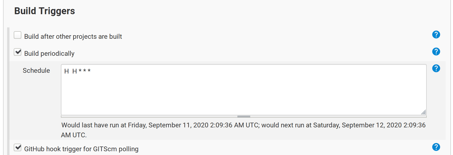

It’s common to run some performance tests during the night when users do not access the system under test. For example, to isolate larger tests from other types of tests or to generate a performance report periodically.
To configure scheduled nightly build that runs at a given time of a given day or night, follow these steps:
  1. Head over to your Jenkins dashboard and click on your pipeline.
  2. Click on configure.
  3. Head over to the Build Triggers section and select the build periodically checkbox.
  4. Fill in a cron-like value for the time you wish to trigger the pipeline execution at.
  5. Save the pipeline.
For example, to trigger a build at midnight everyday, the cron value of H H * * * will do the job. The screenshot below shows the same. You should be aware that the time zone is relative to the location where your Jenkins virtual machine is running. For this example, it is in UTC.
