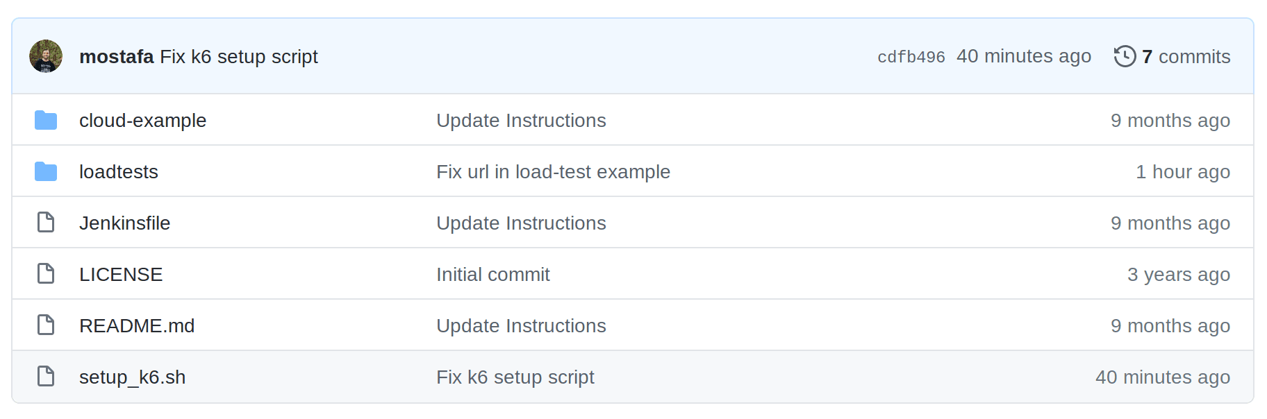

Eventually, your repository should look like the following screenshot. You can also fork the k6-jenkins-example repository.

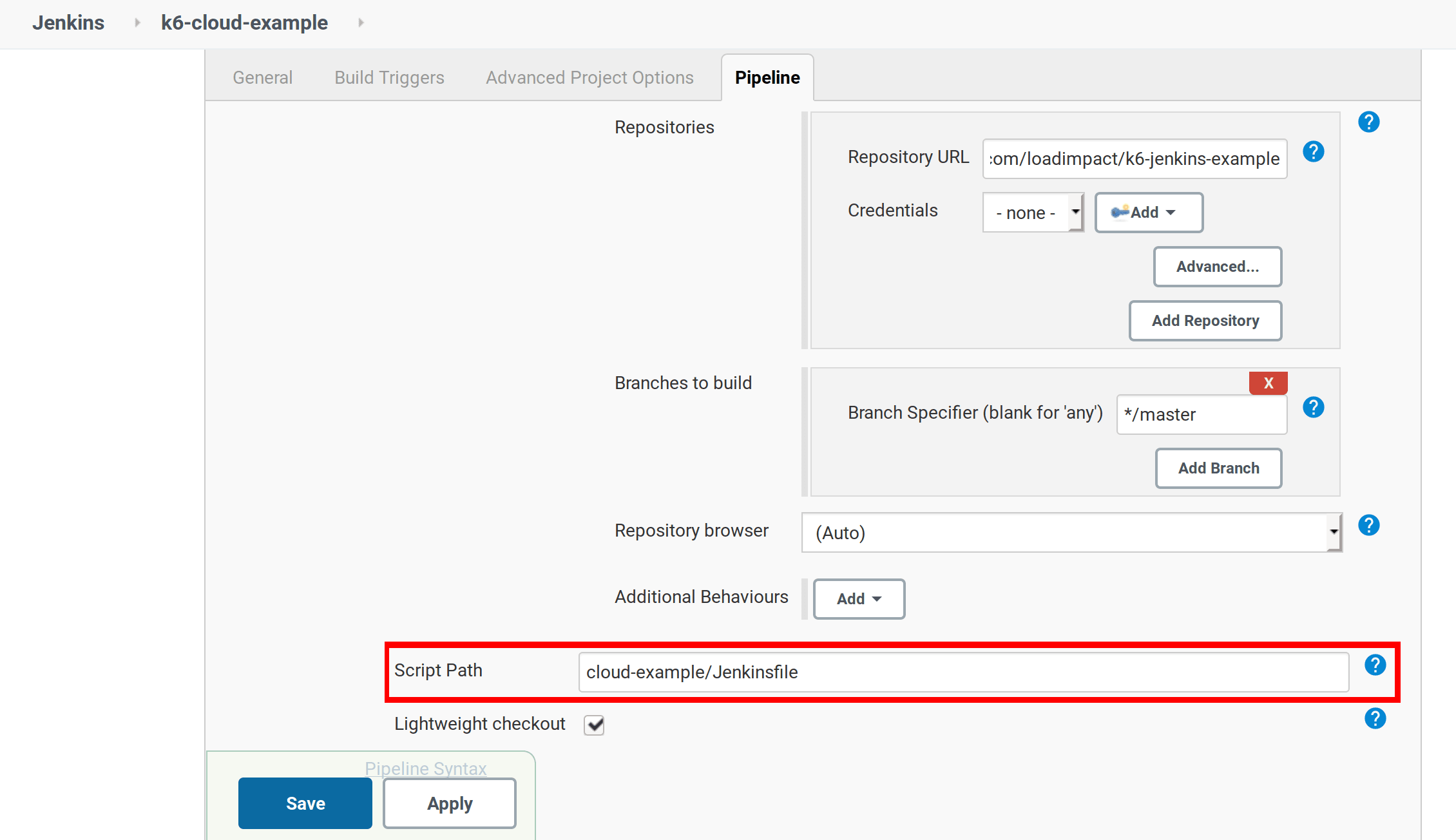

Creating the pipeline job
In this demonstration, we’ve installed Jenkins on a Google Compute Engine (GCE) instance on Google Cloud Platform (GCP). It’s pretty easy to get this up and running, use the Google Cloud Deployment Manager. Simply search for “jenkins” in the top search bar and select the Jenkins option with”click to deploy” which is the 1st option in the screenshot below. This will install Jenkins on a Debian GNU/Linux virtual machine as a GCE instance.
Further instructions will be provided by the GCP platform, which includes a Jenkins instance URL and credentials plus SSH access to the virtual machine.

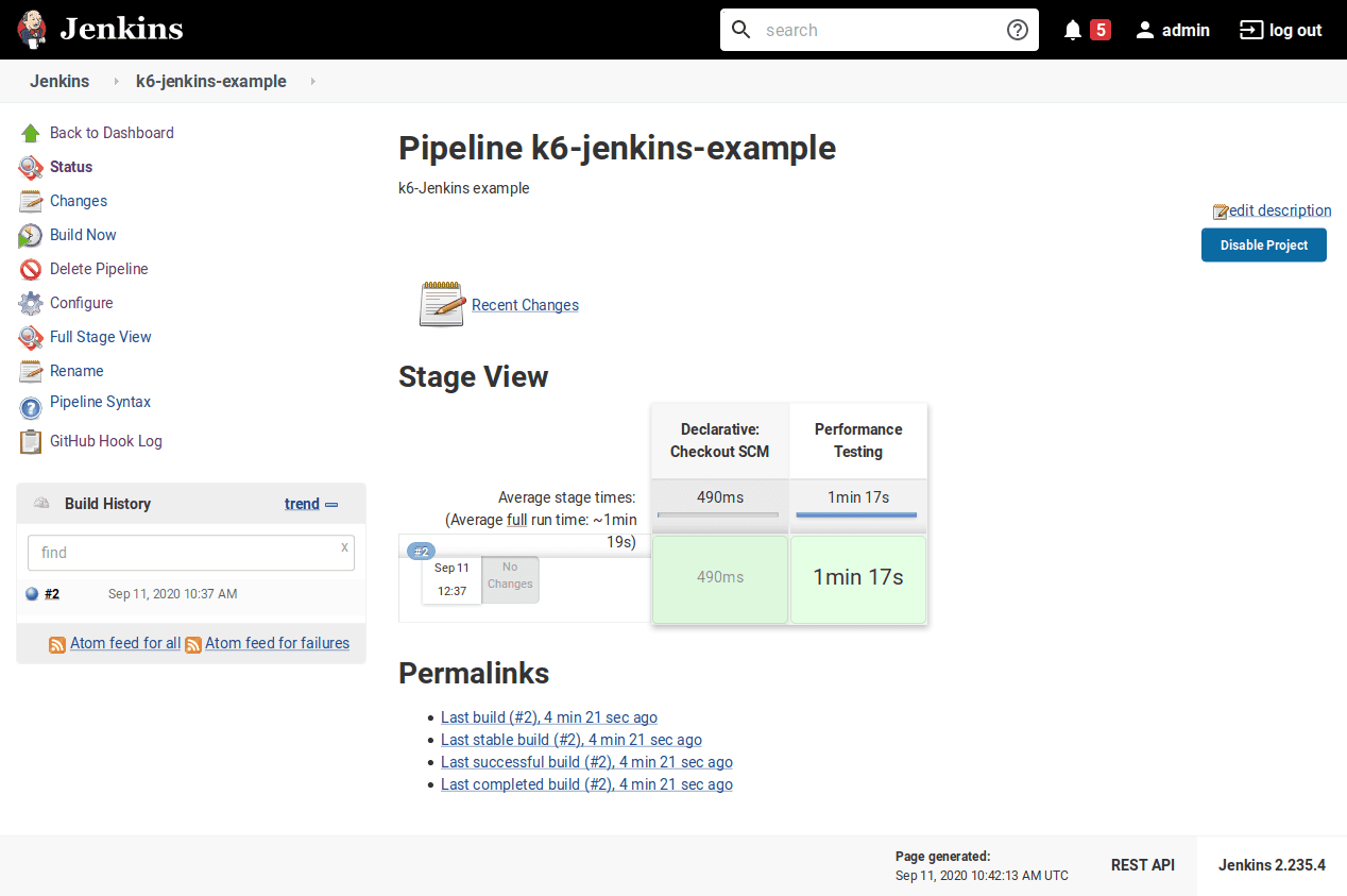

While in the Jenkins dashboard, head over to the pipeline you created and press Build Now to see the pipeline fetch the latest changes from your repository and run the tests.

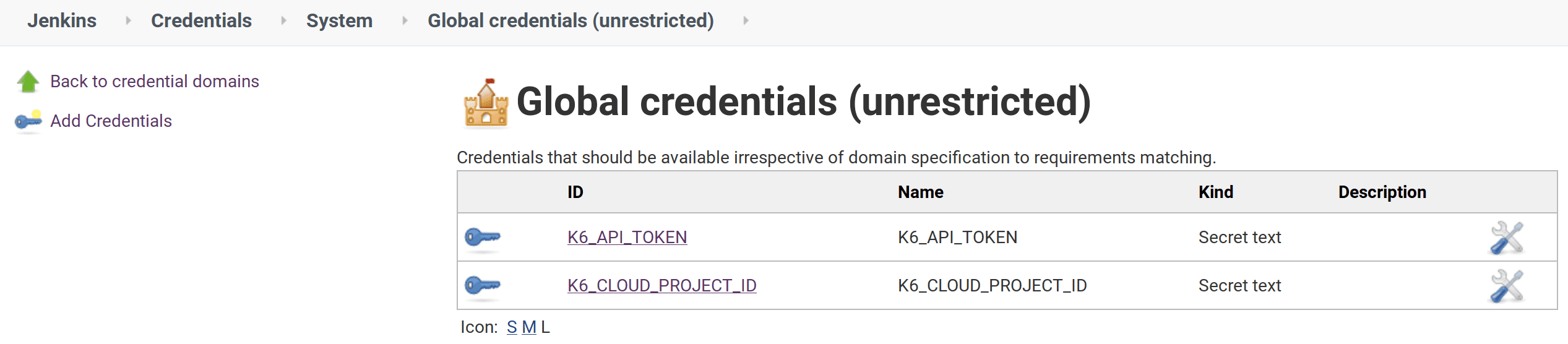

After that, go to the Personal API token page on Testing & synthetics -> Performance -> Settings in Grafana Cloud k6 and copy your API token. You also need your project ID to be set as an environment variable. The project ID is visible under the project name in the Grafana Cloud k6 project page.
Head over to https://<jenkins-instance-url>/credentials/ and add K6_API_TOKEN to global credentials as secret text.

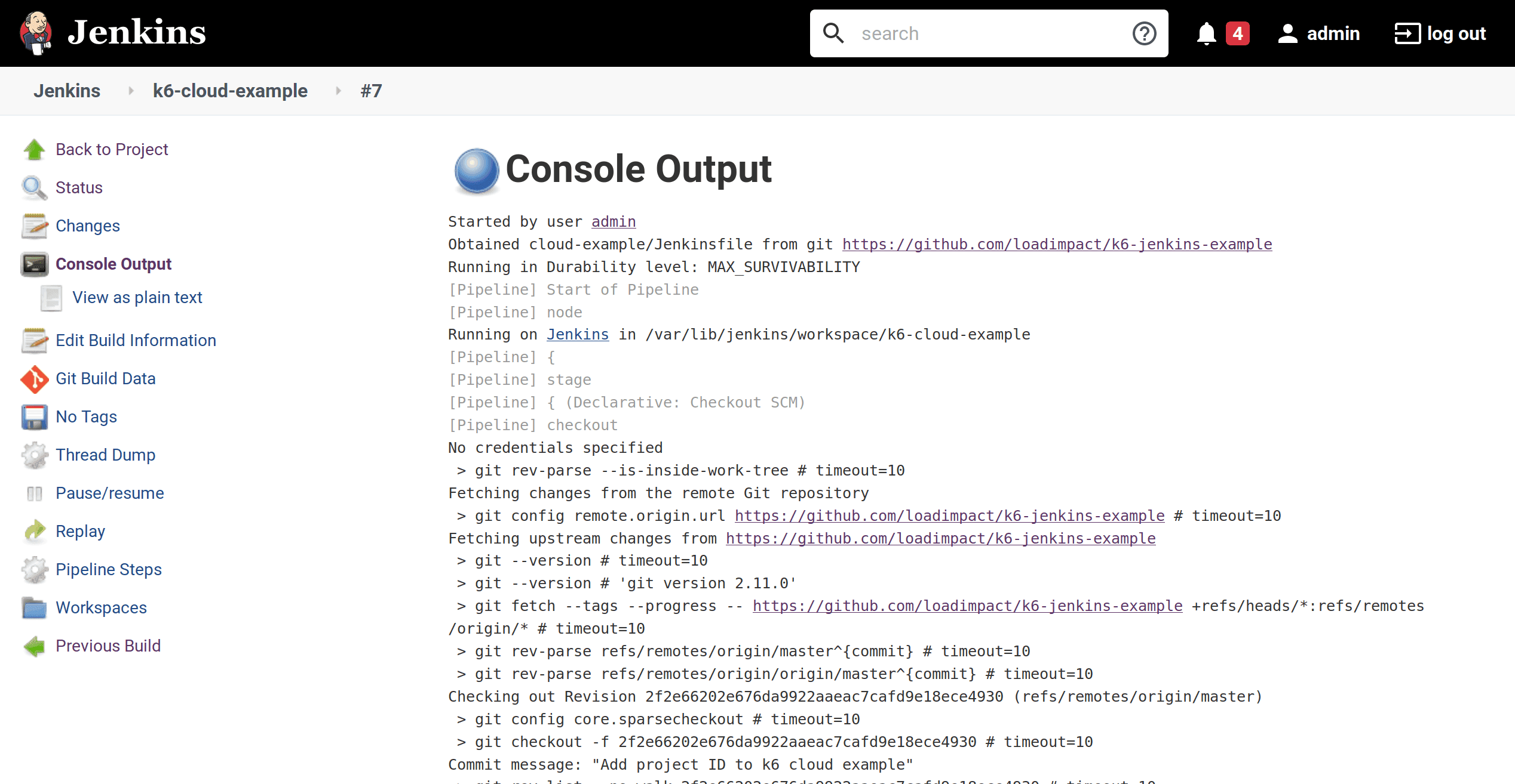

With that done, we can now go ahead and push the changes we’ve made in cloud-example/Jenkinsfile to our GitHub repository. This subsequently triggers Jenkins to build our new pipeline. Just keep in mind that since the changes to the Jenkinsfile is in another directory, you should also create a new pipeline job for it.
And when all is done and good, we should see a screen like this from Jenkins build page:
It is essential to know that Jenkins prints the output of the k6 command, and when running cloud tests, k6 prints the URL of the test result in Grafana Cloud k6. You could navigate to this URL to see the result of your cloud test.

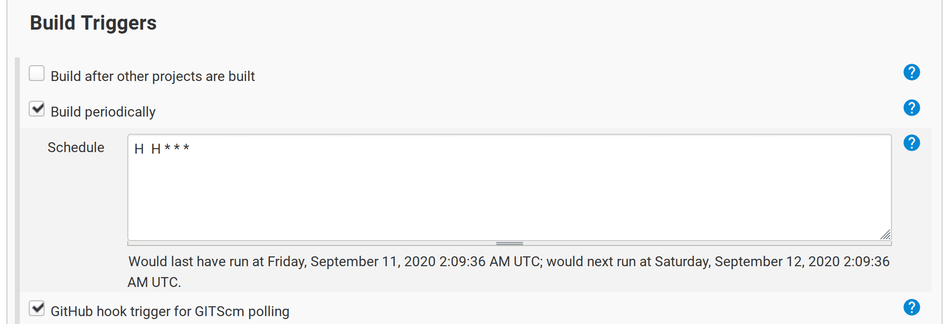

Nightly triggers
It’s common to run some performance tests during the night when users do not access the system under test. For example, to isolate larger tests from other types of tests or to generate a performance report periodically.
To configure scheduled nightly build that runs at a given time of a given day or night, follow these steps:
- Head over to your Jenkins dashboard and click on your pipeline.
- Click on
configure. - Head over to the
Build Triggers section and select thebuild periodicallycheckbox. - Fill in a cron-like value for the time you wish to trigger the pipeline execution at.
- Save the pipeline.
For example, to trigger a build at midnight everyday, the cron value of H H * * * will do the job. The screenshot below shows the same. You should be aware that the time zone is relative to the location where your Jenkins virtual machine is running. For this example, it is in UTC.
