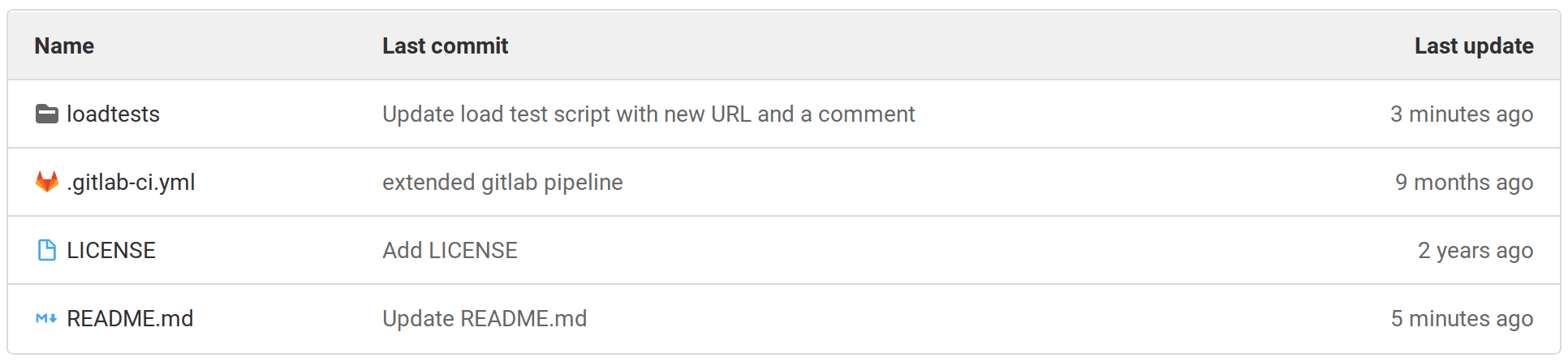

Eventually, your repository should look like the following screenshot. You can also fork the k6-gitlab-example repository.

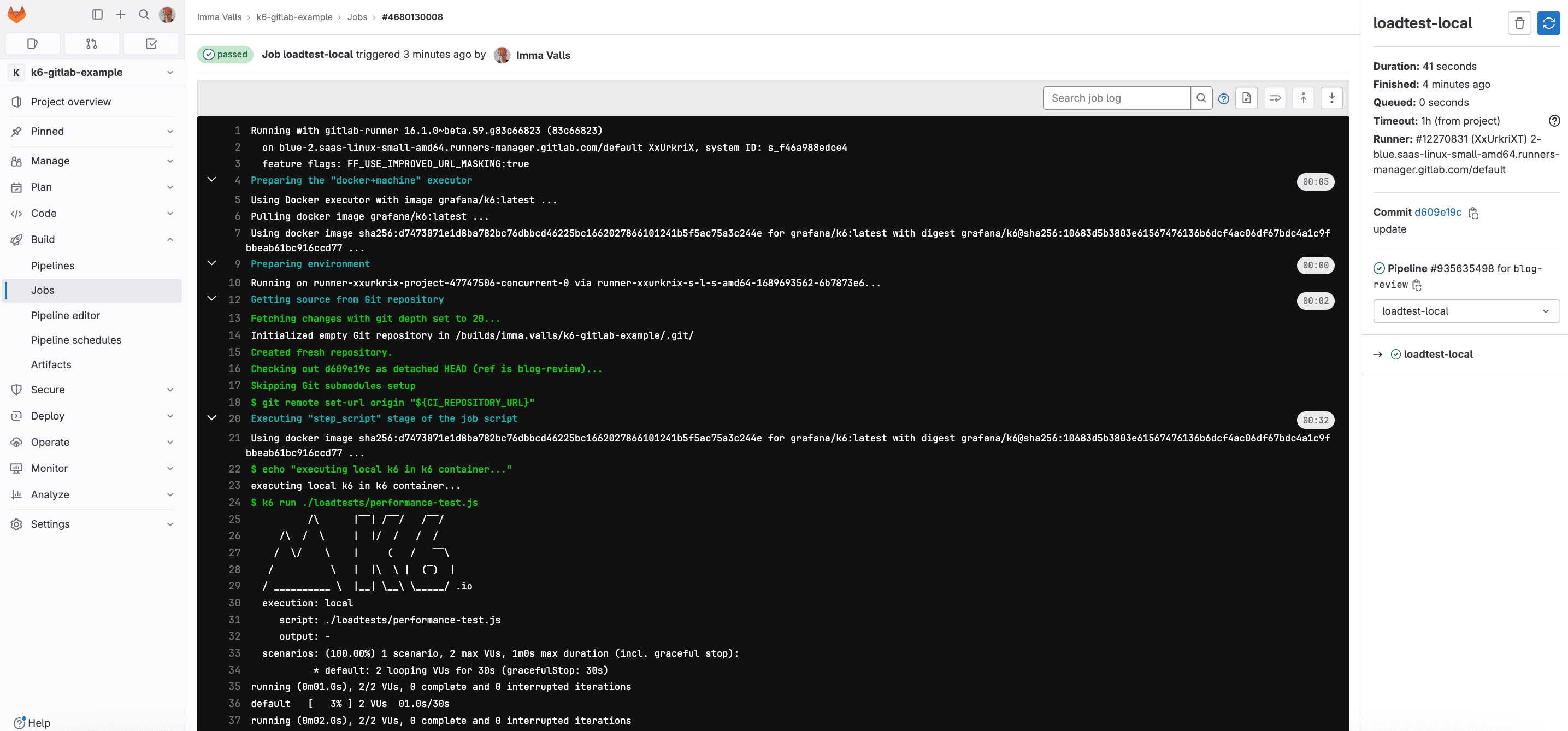

Click on the Build -> Jobs section of the sidebar menu.
On this page, you will have your initiated jobs running. Click on the specific job to watch the test run and see the results when it is finished. Below is the succeeded job:

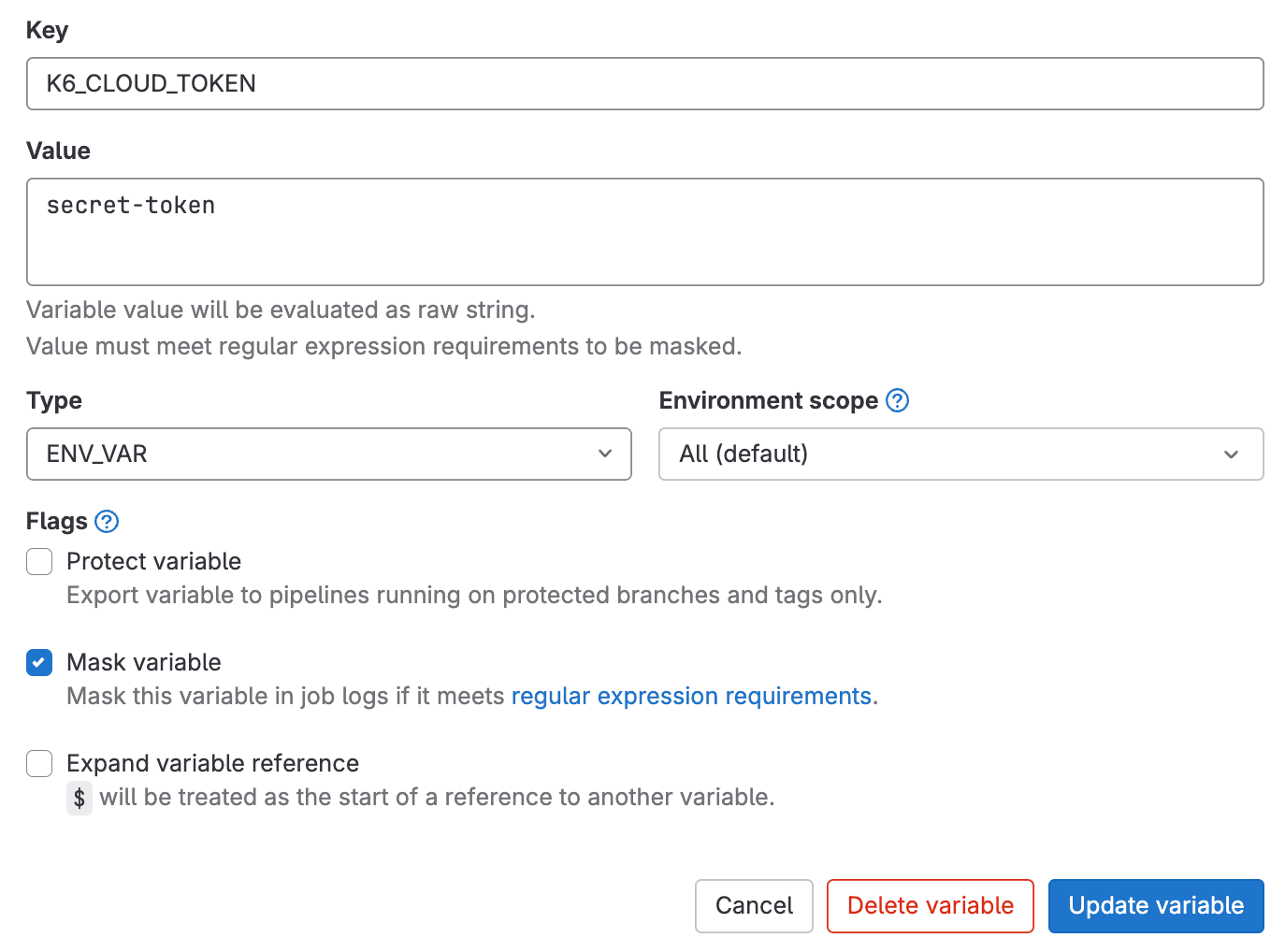

Now, we will show how to trigger cloud tests from GitLab CI. If you do not have an account with Grafana Cloud already, you can sign up for a free account today. After that, copy your token. You also need your project ID to be set as an environment variable. The project ID is visible under the project name in project page.
Navigate to Settings -> CI/CD of GitLab repository and expand variables. When GitLab runs a job, the K6_CLOUD_TOKEN environment variable will automatically authenticate you to the cloud service. You also need to set the K6_CLOUD_PROJECT_ID to your project ID. Refer to define a custom CI/CD variable in the UI guide for more information.
Ensure you uncheck the flag Protect variable if you run the example in an unprotected branch.

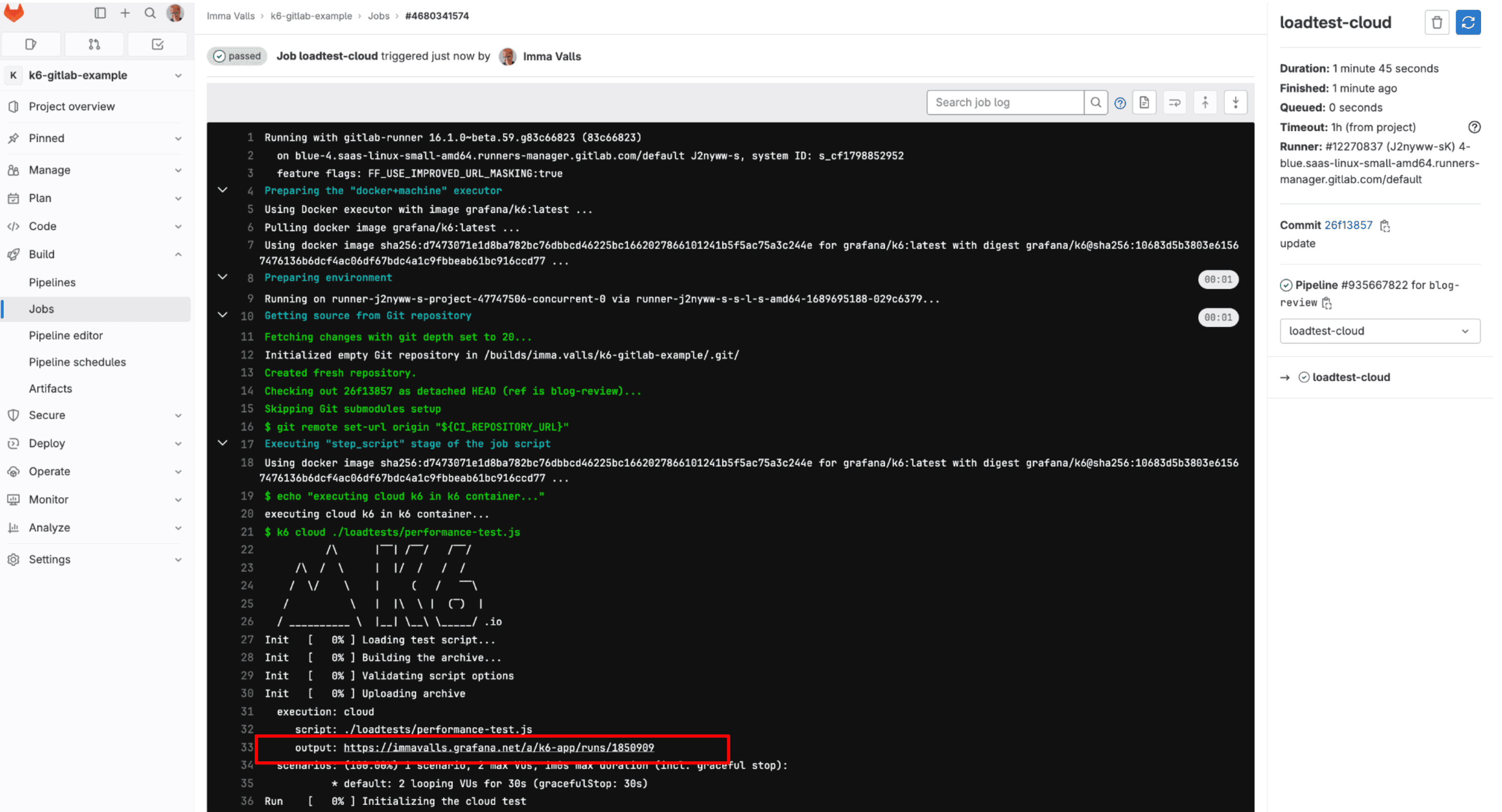

With that done, we can now go ahead and push the changes we’ve made in .gitlab-ci.yml to our GitLab repository. This subsequently triggers GitLab CI to build our new jobs. When all is done and good, we should see a screen like this from the GitLab jobs page:
It is essential to know that GitLab CI prints the output of the k6 command, and when running cloud tests, k6 prints the URL of the test result in Grafana Cloud k6. You could navigate to this URL to see the result of your cloud test.

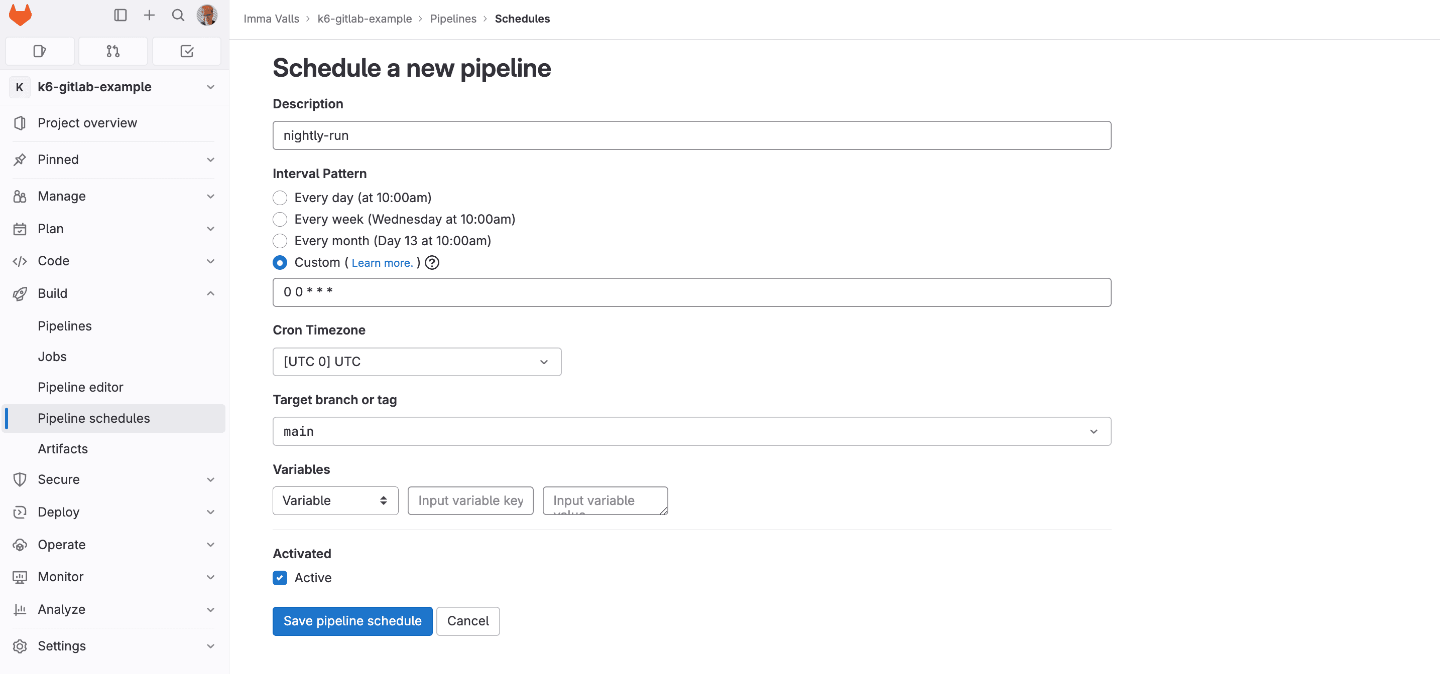

To configure scheduled nightly build that runs at a given time of a given day or night, follow these steps:
- Head over to
Build -> Pipelineschedules section of your repository. - Click New schedule and configure it.
- Fill in a cron-like value for the time you wish to trigger the job execution at.
- Click on
Save pipeline schedule.
For example, to trigger a build at midnight everyday, the cron value of 0 0 * * * will do the job. The screenshot below shows the same. For this example, it is in UTC.

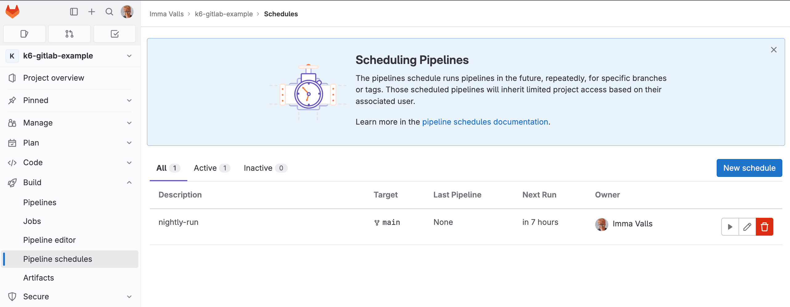

This is your saved job schedule. You can test it by clicking on the ▶️ button.
