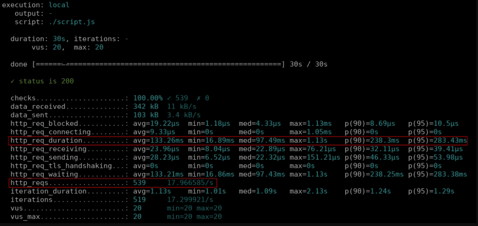

OK, things improved a lot, but still, 38% of our requests timed-out. We proceed by increasing the sleep value for each VU to 1 second:
// ... omitted for brevity
sleep(1);
And we rerun the test, while keeping the same number of VUs:
k6 run -d 30s -u 20 ./script.js
This produces a more desirable outcome for our system:
A screenshot of load test results showing all GET requests finish.
Some things we notice from the above output:
  • All requests finished in a timely manner, with the correct status code
  • 95% of our users got served a response in under 283.43ms
  • In the 30 second test duration we served 539 responses, at a rate of ~18 requests per second (RPS)
Now we have a better idea of the capabilities of this endpoint when responding to GET requests, in our particular environment.

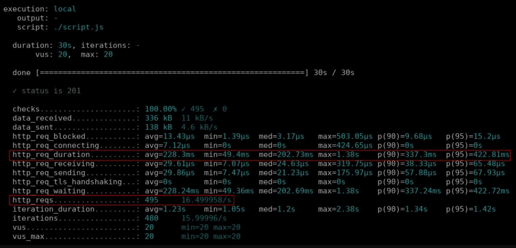

Armed with experience from our previous test runs, we decide to keep the same VU and sleep time values when running the script:
And this produces the following results:
A screenshot of load test results for POST requests.
We notice from the results above that we managed to serve all POST requests successfully. We also notice there was an increase in the duration of our responses and a decrease in the total number of requests we could handle during a 30 second test duration. This is to be expected though, as writing to a database will always be a slower operation than reading from it.

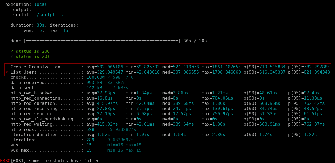

Because we are introducing more concurrent load on our system, we also decide to drop the number of VUs down to 15:
k6 run -d 30s -u 15 ./script.js
And here are the results:
A screenshot of load test results for both API endpoints.
We observe that all requests were successfully processed. Additionally, we now have 2 extra rates (“Create Organization” and “List Users”) with visual indications about their threshold status. More specifically, Create Organization succeeded but, List Users failed, because the 500ms p(95) threshold was exceeded.
The next logical step would be to take action on that failed threshold. Should we increase the threshold value, or should we try to make our API code more efficient? In any case, we now at least have all the necessary tools and knowledge to integrate load testing as part of our workflow. You could continue your journey by reading some of our CI/CD integrations guides.
