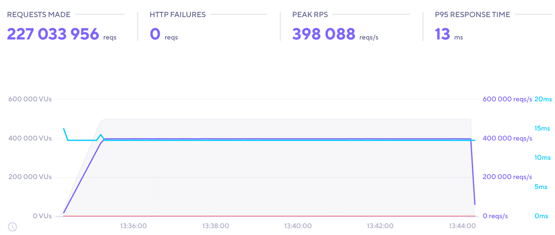

Peak load test
A stress test to see whether k6 could maintain an RPS that corresponded to peak load.
A screenshot of the load test in a dashboard.
Load configuration:
  • VUs: 500k
  • Duration: 10m
  • Unique URLs: 50
  • Peak RPS: 400k
  • Total reqs: 227M
  • Load zones: 2
Output:
  • Time-series: 23k
  • Raw records: 1.3M
Observations: The system handled this decently, but only after auto-scaling kicked in. It also took a bit of time for the RabbitMQ queue to drain after this.

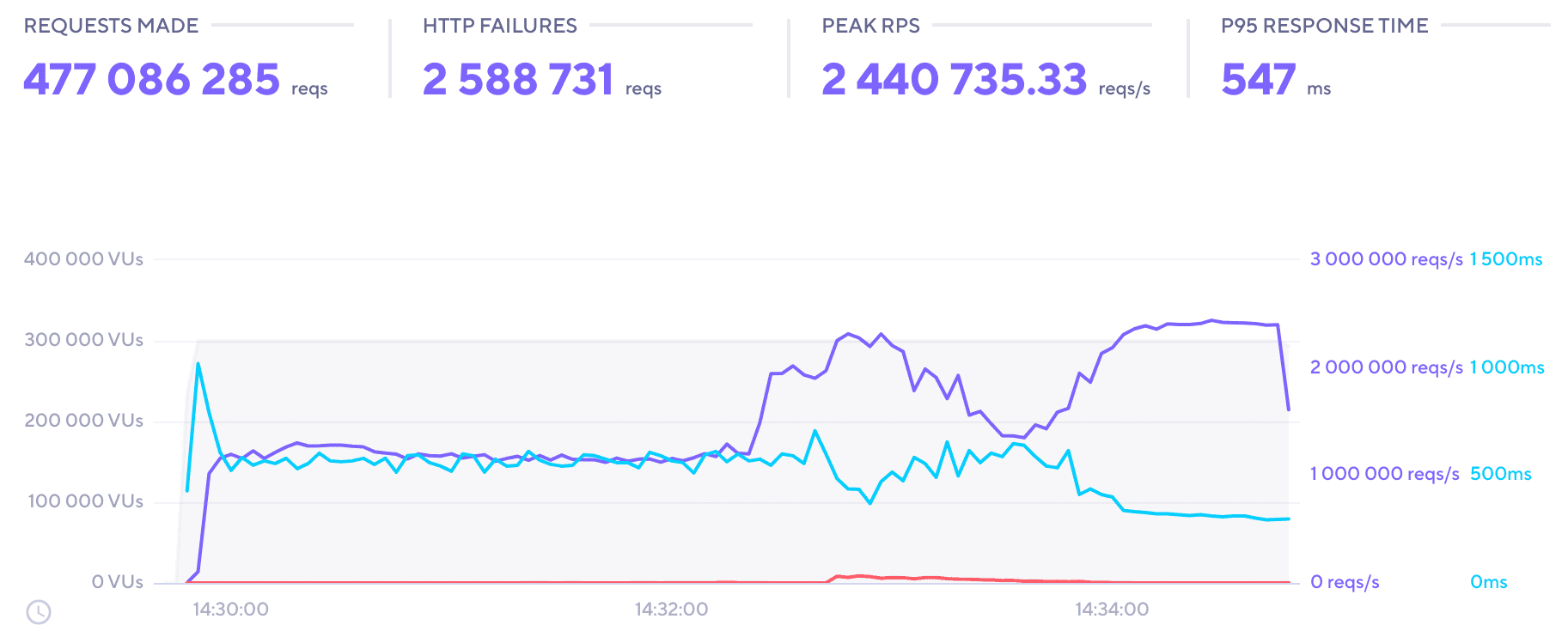

Spike test
A spike test to generate as high an RPS as possible in a short period of time.
A screenshot of the spike test in a dashboard.
Load configuration:
  • VUs: 300k
  • Duration: 5m
  • Unique URLs: 40
  • Peak RPS: 2.4M
  • Total reqs: 477M
  • Load zones: 4
Output:
  • Time-series: 13k
  • Raw records: 210k
Observations: With the relatively low number of records, data-read time was lower than it was in the stress test. However, the CPU utilization of the load generators became very high.

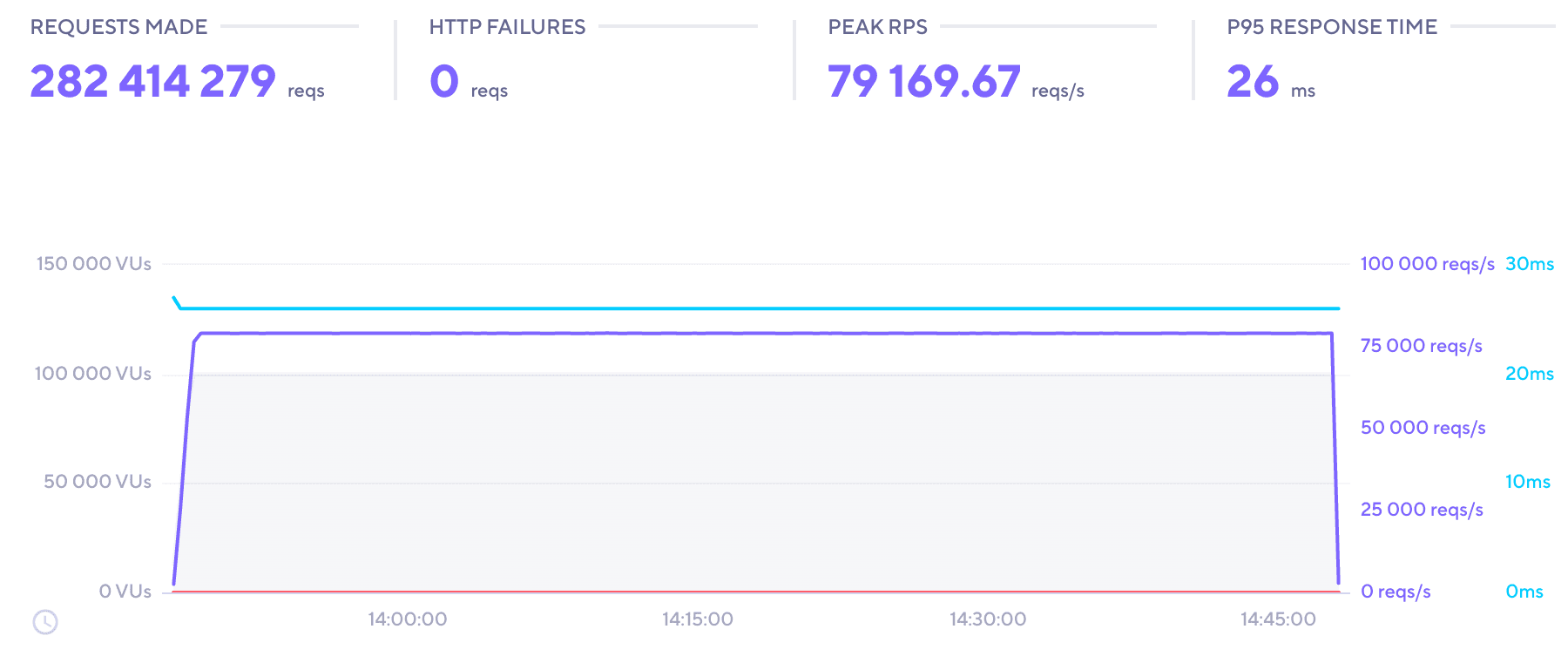

Soak test
A soak test to discover how read time increases with test duration.
A screenshot of the soak test in a dashboard.
Load configuration:
  • VUs: 100k
  • Duration: 60m
  • Unique URLs: 50
  • Peak RPS: 80k
  • Total reqs: 282M
  • Load zones: 4
Output:
  • Time-series: 5k
  • Raw records: 1.7M
Observations: While the system could handle this, read time for metric data gradually increased over the course of the hour. Comparing this with the other tests, we concluded that read time increases more or less linearly with the number of records.
