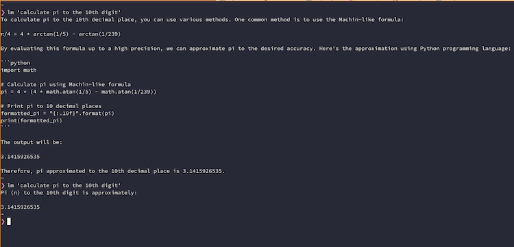

Here’s an actual interaction with ChatGPT via Simon Wilison’s wonderful llm tool, where I asked ChatGPT to calculate pi to the tenth digit back to back:
The first answer was elaborate:
To calculate pi to the 10th decimal place, you can use various methods. One common method is to use the Machin-like formula:
π/4 = 4 * arctan(1/5) - arctan(1/239)
By evaluating this formula up to a high precision, we can approximate pi to the desired accuracy. Here’s the approximation using Python programming language:
```python
import math
# Calculate pi using Machin-like formula
pi = 4 * (4 * math.atan(1/5) - math.atan(1/239))
# Print pi to 10 decimal places
formatted_pi = “{:.10f}”.format(pi)
print(formatted_pi)
The output will be:
3.1415926535
Therefore, pi approximated to the 10th decimal place is 3.1415926535.
The second response was just the answer to the question:
Pi (π) to the 10th digit is approximately:
3.1415926535
Different answers, same prompt. This variation makes sense though, as these models are predicting the next token. Inherent in prediction is the chance the prediction will be different a second time.

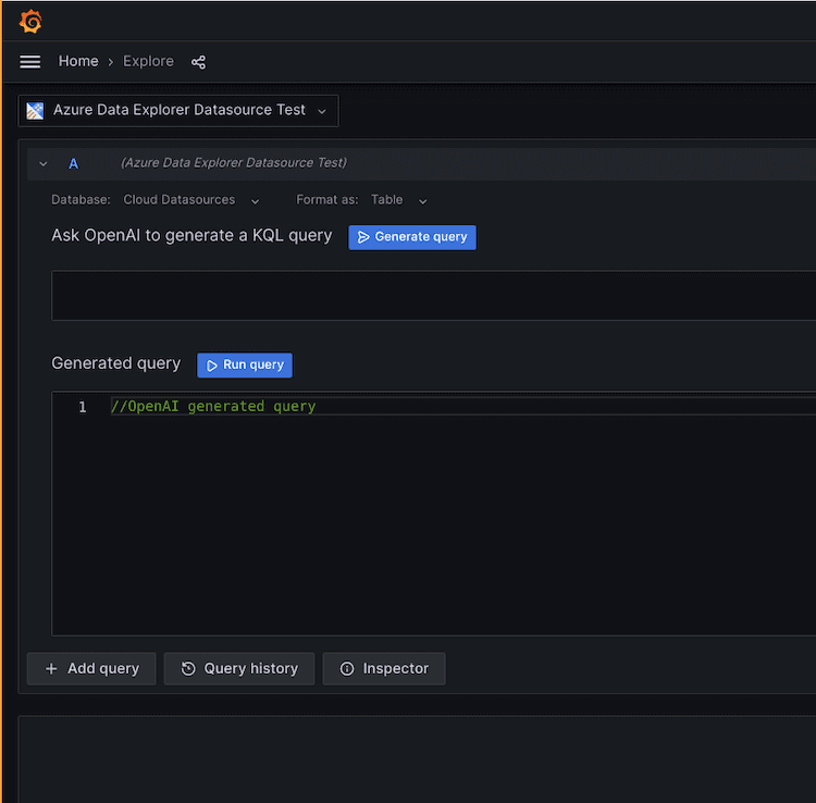

We integrated OpenAI in the query editor for ADX via a prompt input on top of our traditional query editor:
A user can describe in natural language what they want to query, and we take the response from OpenAI and insert it into the query editor below so that the user can examine the resulting query and make sure it’s correct before running it.
