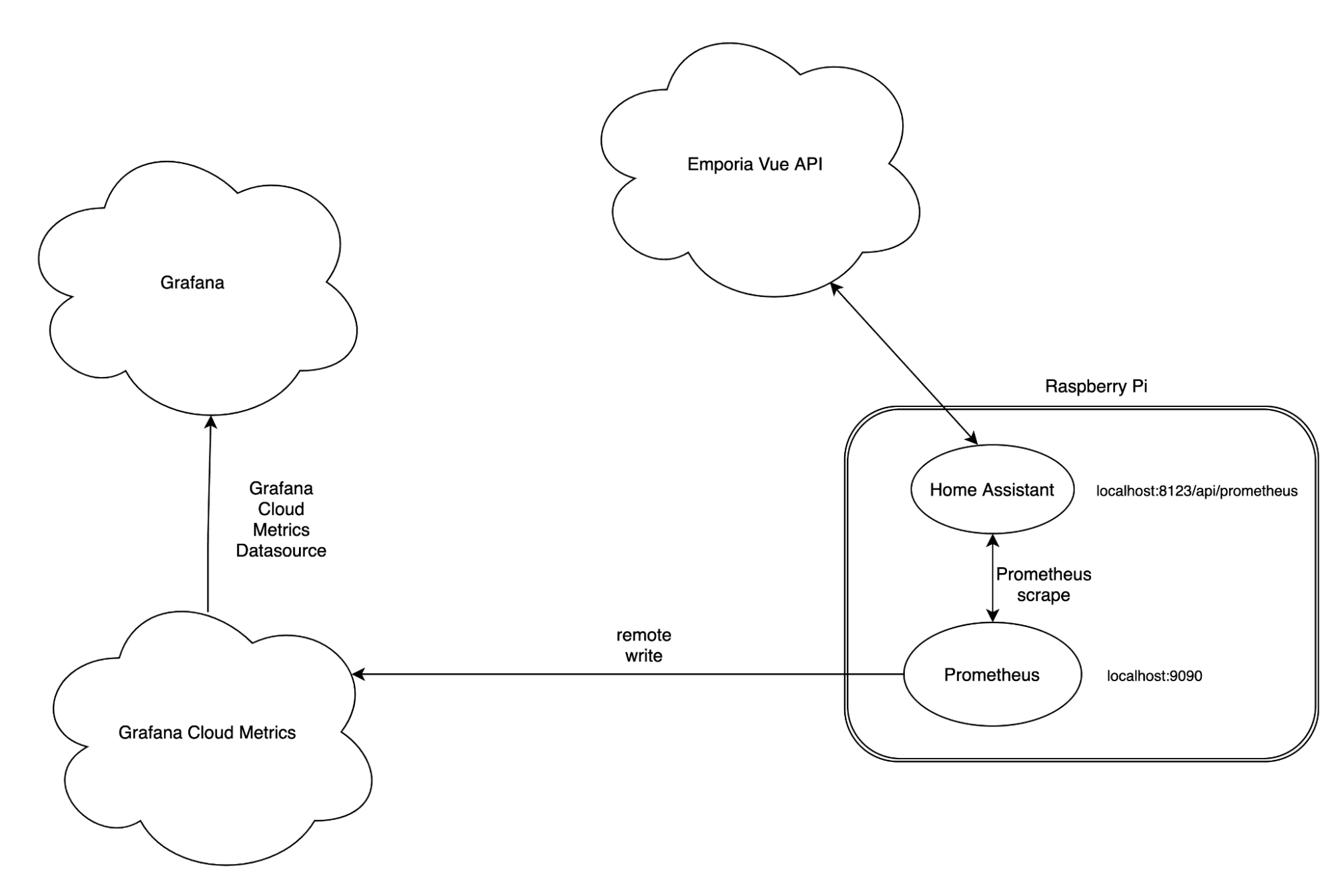

A quick explanation of the diagram above: On the right you see my Raspberry Pi. Inside it are two containerized applications running HomeAssistant and Prometheus. HomeAssistant is grabbing the energy metrics from Emporia Vue’s cloud API. Prometheus is then scraping those metrics now stored in HomeAssistant and remote writing them to my free Grafana Cloud stack. Then I use Grafana to visualize everything using the Prometheus data source that’s available by default in Grafana Cloud.
As a side note, I’m planning on writing a Prometheus exporter, which will natively scrape from Emporia Vue’s API. Once that’s complete, I won’t have to use HomeAssistant and the exporter will take its place.

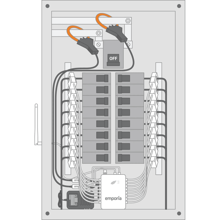

To start, you’ll need to get the Emporia Vue 2 setup in your home circuit board. The Emporia Vue app has great instructions and important safety information, so go slow and read all the directions — but it’s pretty easy to install. They even have a link to get a certified electrician to come and install it if you’re more comfortable having someone else do it.
Here’s a diagram of how it should look (my wiring was not this neat 😀):

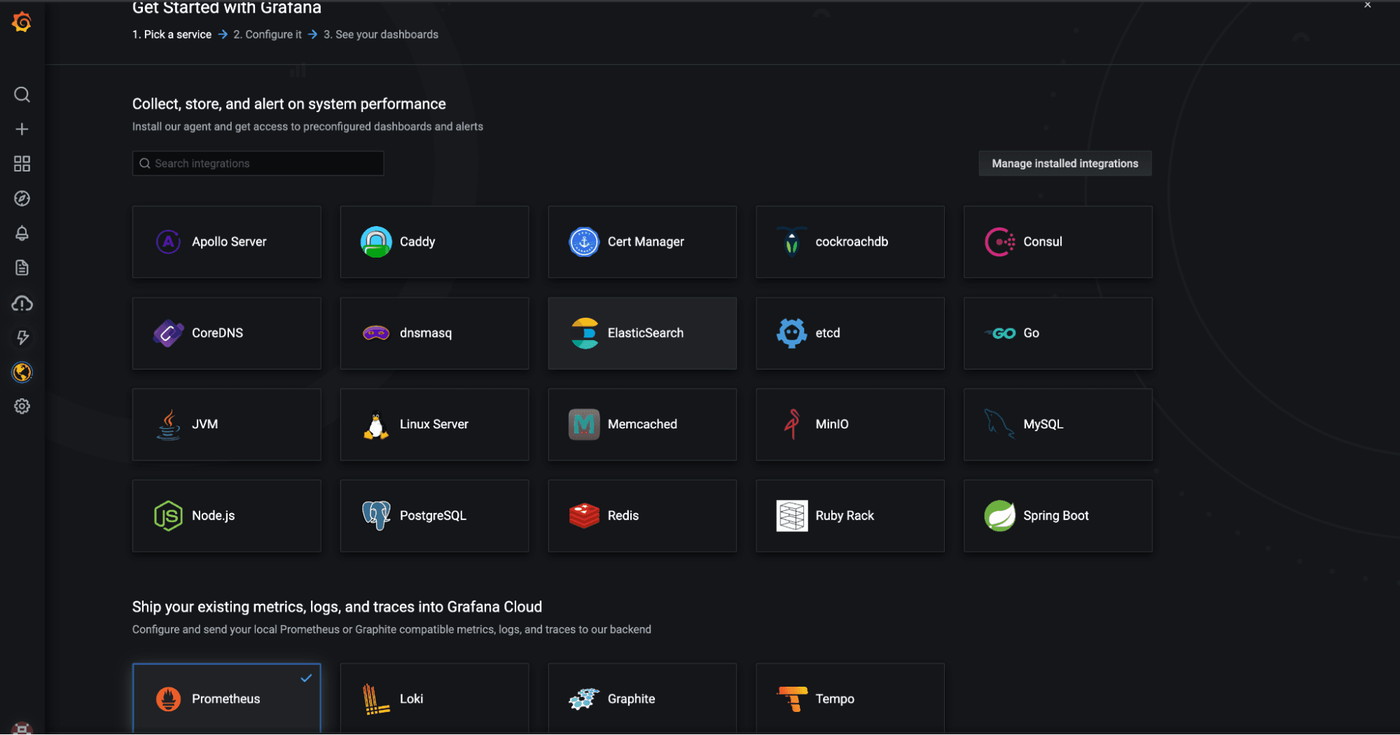

Once you’ve created your Grafana Cloud account, you will be redirected to the onboarding walkthrough page. Find Prometheus (shown below) and click continue to configure it.

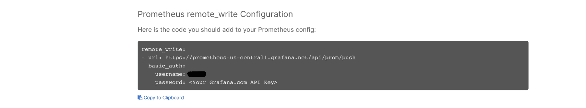

That should take you to a page with your instance url, Username/InstanceID, and API Key. If you scroll down a bit you’ll see a field that says Prometheus Remote_Write Configuration. You’ll need this configuration when we edit the prometheus.yml file later.
Embedded image
On that same page you’ll be able to create your API Key to fill in the password field in the remote_write configuration above. To create the key, click the blue “generate key” link in the API Key field. It’s kind of hard to see at first, so here’s a screenshot:

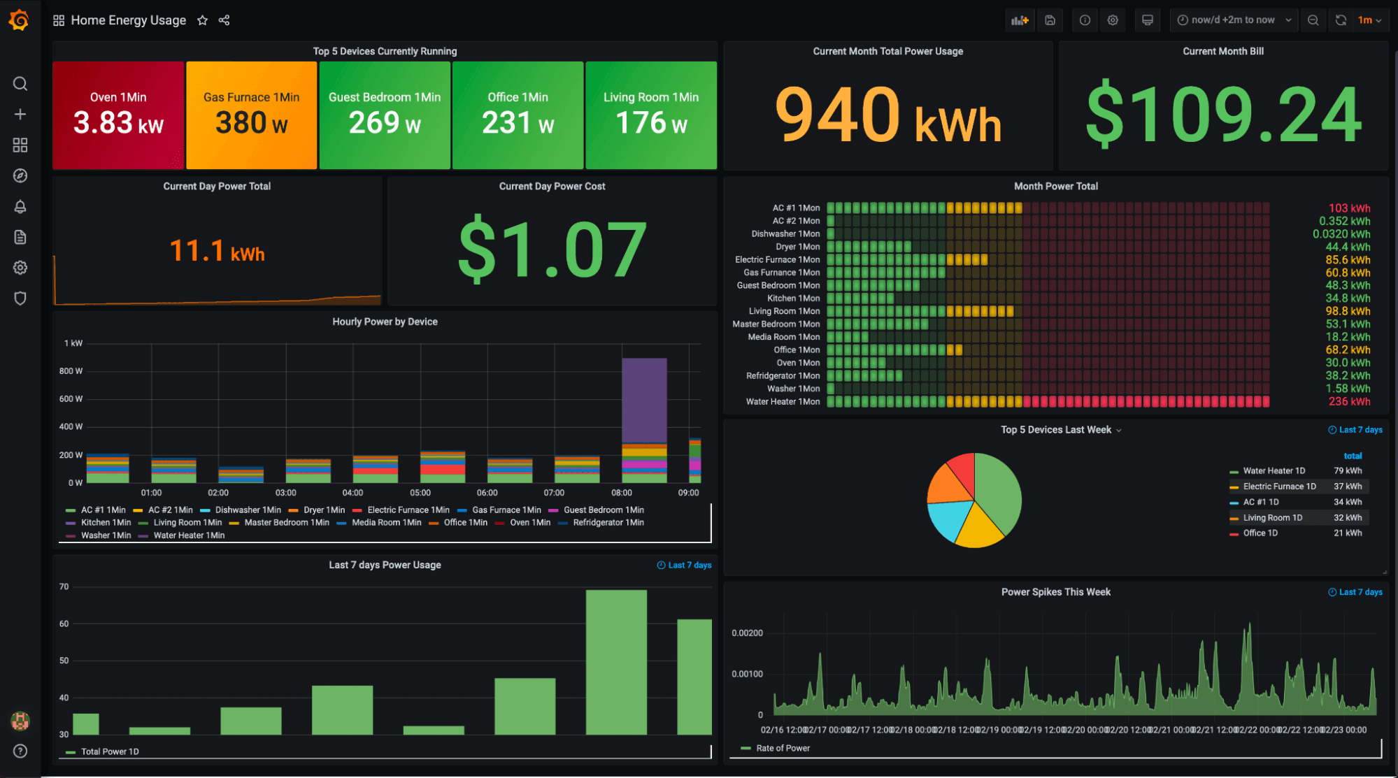

Now that you’ve done the hard part, it’s time to login to your cloud instance of Grafana and import the energy usage dashboard. If you’ve done all the steps correctly, you should be able to see live energy consumption data on your dashboard.
Embedded image
My home energy usage dashboard
And you’re done! I hope you enjoyed this blog post and now have a better understanding of your power bill — as well as Prometheus and Grafana. If you set this up for yourself, please reach out and let me know how it goes. I learned that my water heater uses about 50 percent of my energy bill every month! Time for cold showers . . .
