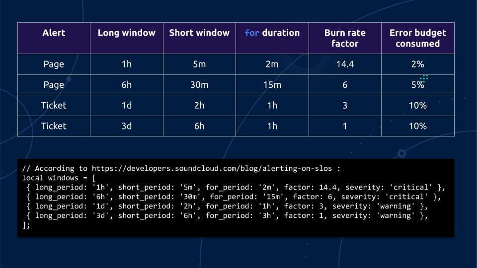

Rabenstein picked up his talk from there, with this table from the blog post:
Embedded image
The basic idea for alerting on SLOs – as described in the SRE book – is to measure the error rate over a variety of time windows (the “long window” in this table) and then alert on them. You page quickly if you are burning your monthly error budget quickly, and you only ticket people if the error budget is burning slowly enough that a response during work hours is acceptable.
“The easiest to understand is the one you have for three days,” he said. “Your average error rate is exactly factor one, the error rate you could sustain while not blowing your error budget. Let’s say you want 99.9% availability. Your error budget is then 0.1% error over a billing period, usually a month. So if you have exactly this 0.1% error rate, factor one, over three days on average, that means you’re exactly burning your error budget as fast as you are allowed to. Which is not too bad, but if anything happens in the rest of the month, you are screwed, right? So this is why if you have burned 10% of your error budget, three days is 10% of a month, you should do something about it. So you get a ticket because you don’t have to wake somebody up. This is a long-term slow error budget burn report. During work hours you can find out what’s wrong in your system.”
The table goes up in speed, with the fastest one the one-hour window. “You have a pretty generous factor of 14.4,” Rabenstein said, “so that means with the 0.1% error budget, if your error rate is 1.44% on average over one hour, you get a page, and the moment you get the page, you have burned 2% of your monthly error budget, within only one hour! That’s way too fast. This is where somebody has to wake up and fix it.”

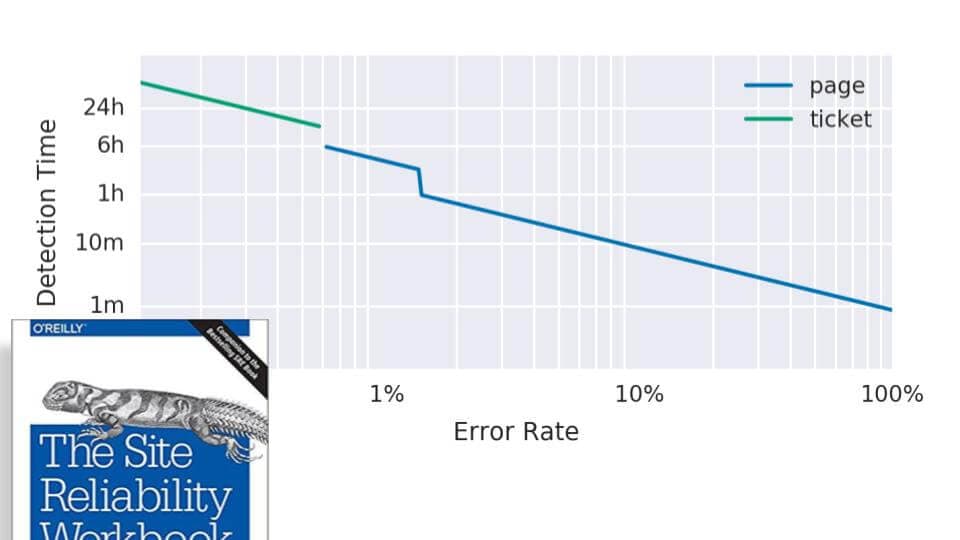

He then added that intuition would tell you that a one-hour average is too long for a page, because if you have a serious outage, you’d want to know within a minute. “But the intuition is wrong,” he said.
Embedded image
This graph from the workbook shows that “if you have a 1.44% error rate, then it actually takes an hour to detect that,” Rabenstein said. “In a one-hour window, if everything has been fine, 0% error, for most of the time, and then you suddenly begin to have 100% errors, the average is 1.44% within less than a minute. So that’s the interesting thing. Within less than a minute, this alert will page you, even if it’s an average over one hour, so this alert has actually no problem with being too slow.”
The big takeaway: “You can look at pretty long averages and still get meaningful alerts on slow and fast error burn,” he said.

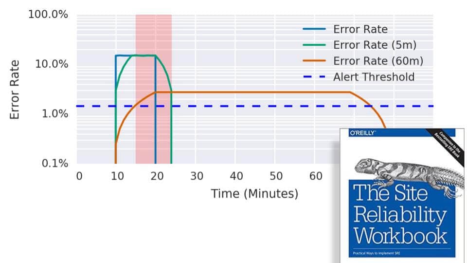

But there’s a potential problem here, as seen in the graph below.
Embedded image
“The blue curve is the actual error rate as it happens,” he explained. “So at T plus 10 minutes you have an outage for whatever – a few instances of your microservice go bad and you have like a 15% error rate. What happens? The red line is this one hour average. So it takes five minutes for this red line to go above the 1.44% error threshold. So after five minutes, even with this partial outage, you get a page. Presumably the engineer on call wakes up, fixes the problem within five minutes, good engineer. Error rate goes down to zero, engineer goes back to bed.”
The problem, though, is that the red line will stay above the threshold for an hour because this error peak is in the one-hour average. The alert fires all that time. You might be tempted to snooze it on Pagerduty or silence the alert in Prometheus. But then if something else happens, and the error spike happens again, the alert has been silenced and no one will be notified.
So how can you make sure that if the outage returns, the alert will reset quickly? “You take the five-minute average, and this is where the short window from the table enters the game,” Rabenstein said. “For the long window of one hour, you take another window of five minutes, and you also calculate the average error rate.”
Alerting on that alone would be too noisy; a few error spikes shouldn’t trigger alerts. “But if you alert on both curves being above the threshold, then you get the best of both worlds,” he said. “This pages here because both green and red are above the fold, and once you have fixed the outage, the green curve will go down really quickly. So from this moment on, your alert ceases to fire. The red area there is when the alert is actually firing, and that’s exactly what you want.”

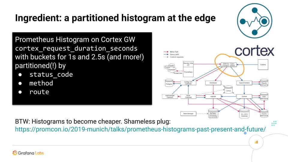

There’s an ingestion (write) path when people send Prometheus metrics and Cortex needs to ingest them, and there’s a read path where people run PromQL queries to retrieve Prometheus metrics from Cortex. At Grafana Labs, they created a Prometheus histogram on this gateway, with different buckets, including ones at 1 second and 2.5 seconds for their SLOs. They were partitioned by status code, method, and route (read or write path).
Rabenstein acknowledged that conventional wisdom among Prometheus practitioners discourages partitioning histograms because histograms are really expensive in Prometheus. But “more and more I run into use cases where I want to partition the histogram,” he said, “and we have big enough Prometheus servers to do this. Shameless plug, I gave a talk at PromCon very recently where I told people about my research of making histograms cheaper in the hopefully not too far future.”
For Grafana Labs, the SLO was to complete 99.9% of writes successfully in less than one second and respond to 99.5% of reads in less than 2.5 seconds. “This is an SLO, not an SLA,” Rabenstein pointed out. “We are not yet committing to our customers to reimburse them if it’s slower, but we want to in the future. I think it’s a good pathway to set an SLO to inform your designs. And then if you can transform this into an SLA, it will make your users really happy, and it will give you an advantage over your competitors that might have been less ambitious about latency SLOs.” The previously reported efforts to speed up PromQL queries are a good example for improvements inspired by the latency SLO.

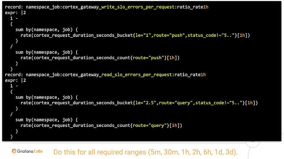

To set this up, create recording rules that give an error ratio in which slow requests count the same as explicit errors.
Here are the rules for the read and write SLO errors per request, averaged over one hour:
Embedded image
From the histogram, “we pick the bucket with 1 second for the write rule because this is the latency from our write SLO, our target to do everything fast,” Rabenstein explained. “It’s the push route because that’s the write path. We take from the histogram everything that is not a 500 and fast enough and divide it by the total number. But this is very flexible. You could change it to, for example, exclude 400s because the storm of 404s will be responded to really quickly and that shouldn’t count as free uptime. You can mix and match here.” For the read rule the 2.5 second bucket is used in accordance with the latency from the read SLO.
Corresponding rules exist for all the other required time windows.

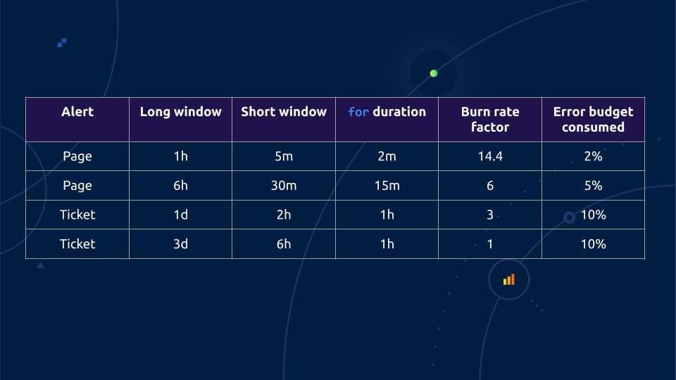

Looking back at the table with the original error-based approach, Rabenstein points out that it actually doesn’t change at all. “We use exactly the same principles,” he said. “Once we have defined those recording rules, we are back to square one. Essentially we have now a recording rule that looks like error rate, but it’s actually a rate of errors and slow queries.”

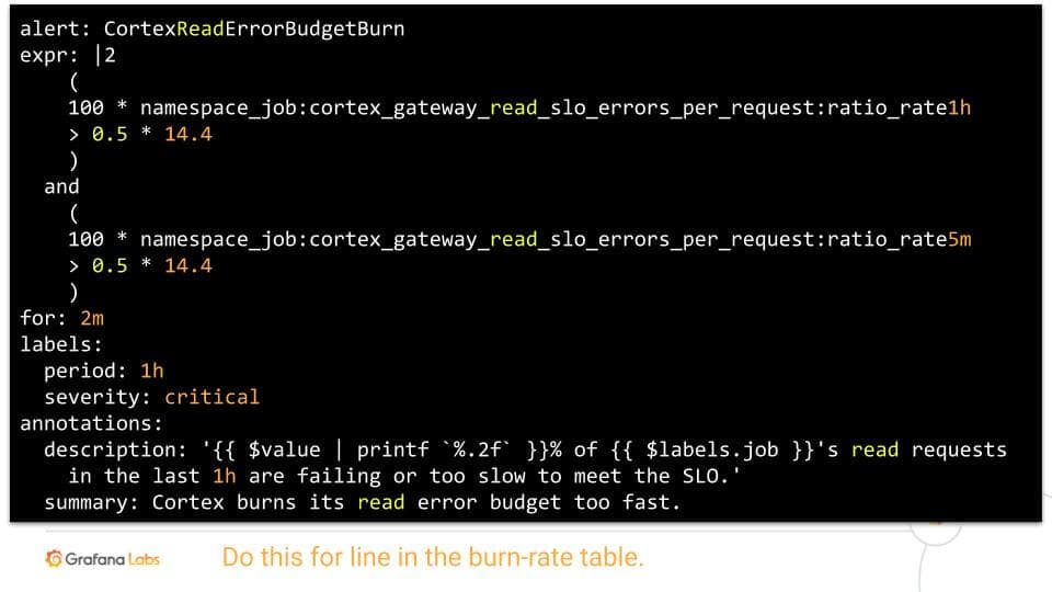

See the following two example alerting rules and compare them to the original purely error based alert above.
Embedded imageEmbedded image
