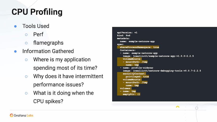

CPU Profiling

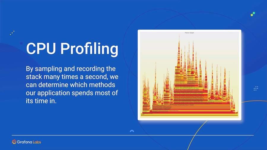

This is a sampling approach. It helps you understand which functions your application is spending time in, and it can also help you figure out why an application is behaving strangely. “Perf is going to sample the stack of our other process a thousand times a second, and it’s just going to write out what happens,” Elliott said.
It records those using a tool called flamegraphs, which created the image below.
Embedded image
Here is a breakdown of the technique:
Embedded image
Elliott explained that since he had to pass a PID, he ran ps x. “If you did not set shareProcessNamespace: true and you ran this ps x command, you would not be able to see your primary process,” he warned, “and you would not be able to perform these techniques.”
He said he mounted temp in this instance “because perf wants to see a perf map in temp” and it’s going to resymbolicate the stack, which makes it easier to understand what’s going on.

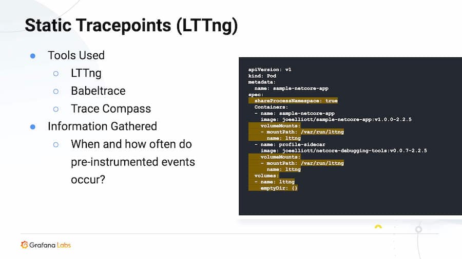

Static Tracepoints
“Static tracepoints are frameworks that are designed for very, very high volume – things that you can write in the critical path, and you can record this information and have low-to-no impact on your application,” Elliott explained.
This requires pre-instrumentation, and needs to be built into your application. He primarily uses LTTng (a framework for collecting tracepoints) and Babeltrace. The application and userspace create events and pass it to the LTTng daemon and userspace.
Embedded image
This technique doesn’t require kernel access, and doesn’t require securityContext.privileged to be set to true because it’s simply communicating with the main process in userspace. With Trace Compass, you can pull all these events and see them on your desktop.
“The reason we’re mounting var/run/lttng is because LTTng wants to communicate through a Unix socket, and by default it puts it in var/run/lttng.” Elliott said. “So for this to work at all, both of the applications need access to the same folder, essentially.” He noted that he used .NET Core because it has a pre-instrumentation for LTTng.
Through this technique, events such as garbage collection, thread creation, and deadlocks can be analyzed. Babeltrace supports Python extensions, so it’s possible to write Python scripts and also use to Trace Compass utility to see a histogram.

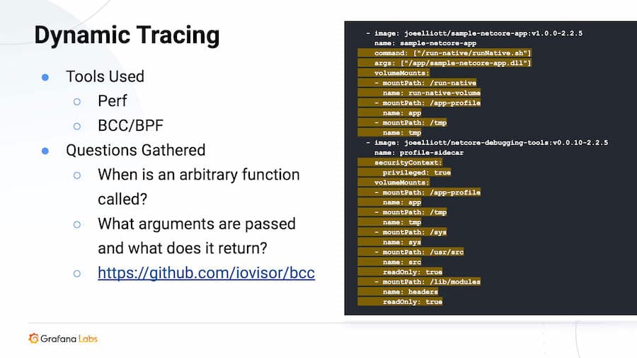

Dynamic Tracing
This is the newest of all the techniques Elliott demonstrated. It requires no instrumentation, but it’s the hardest to pull off.
“Dynamic tracing is a really cool trick, to have the kernel call back to you and tell you at any point when a function is called an application,” he said.
Embedded image
Here, he ran a script called run-native, “and then I’m sharing all this stuff and that’s all related to a specific requirement of Uprobes, which is what BCC is using,” he said. (To ensure it works, you need an on-disk machine code binary.) He also ran a script to take a bytecode compilation, turn it into machine code, and lay it on the disk. “Only that specific trick allows us to do BCC at all to this application,” he added.
As a cheat, he mounted usersource and lib/modules, and that’s to get Linux headers. “It can be difficult to pull the exact Linux headers that your kernel is compiled with into a container running in Kubernetes,” he said. He also mounted /sys from the host because it’s using an Ftrace, which requires /sys.
In one demonstration of this technique, Elliott dumped string parameter values, which he said shows off the power of BPF: “BPF is a technology to write a subset of C that is compiled to a byte code that is run in the kernel. So it makes it very fast and very performant.” He attached it to a Uprobe, took the .NET Core internal string representation, then extracted that string and displayed it on the console.
“Perf also supports dynamic tracing,” he added, “but it only supports null terminated strings, so you can’t actually do this with Perf.”
Using little self-written programs, he said, it’s possible to do things like calculate a histogram or take some data and re-present it in a way that makes more sense outside of the application.
