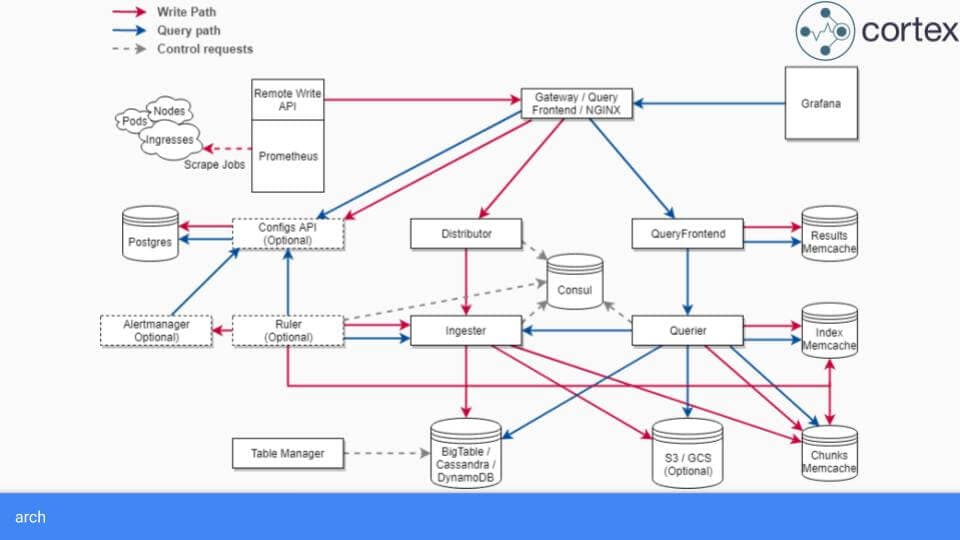

For the past year and a half, he said, pointing to a diagram of Cortex architecture, “I’ve been on call for this beast.” And, he added, what he’s learned is that it’s “quite easy to tame.”

The Write Path
In the write path, Prometheus writes to the gateway, which does authentication, adds the tenant ID and tenant header, then sends it to the distributor. The distributor sends it to the ingestor. The ingestor takes the individual samples, builds them up into bigger chunks, and then writes them into BigTable, GCS, and the cache.

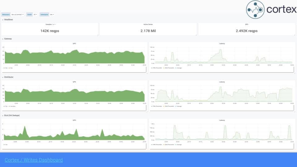

Imagine you’re operating Cortex, and you get paged because the writes are failing, or the Prometheus remote write is falling behind because it can’t write fast enough. What do you do? “This is my playbook for being on call for Cortex,” he said. “I get paged for writes. I go to something called the Cortex writes dashboard.”
Embedded image

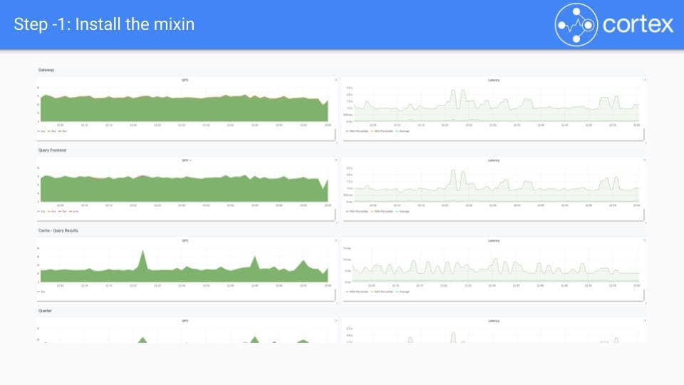

This dashboard, which has been open sourced, is based on the RED method of how to instrument distributed applications, especially if they are RPC systems. You need to track Requests, Errors, and Duration. “If you have distributed systems, you can build these very consistent templated RED dashboards that will actually give you at one glance what is wrong with your system and what is right with your system,” said Veeramachaneni.
Cortex, he explained, “is like a tiered application where A talks to B, talks to C, talks to D, and [on the dashboard] you have the QPS on the left and latency on the right. The beauty of this is if something goes red, for example, you see the gateway is red: 500 errors are being thrown, distributor is red. But the ingestor is green. So immediately you can understand the distributor is what is throwing these errors, and that you need to look at the distributor logs, not the ingestor logs.”
The same would apply for latency. If there’s, say, a 40-millisecond latency on writes, and you see that the ingestor only has a 5-millisecond latency, that means that the distributor is what is adding the latency.

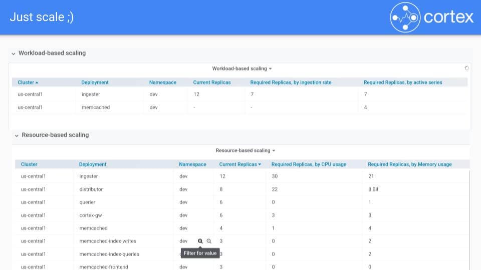

When the company signed up its first customers for Cortex as a service, Veeramachaneni found that things started to slow down because he hadn’t scaled it up enough. So they built a scaling dashboard for workload-based scaling and resource-based scaling.
Embedded image
In this example of the resource-based scaling dashboard, “essentially there are 12 replicas, but if you look at the CPU usage and CPU requests, you need 30 replicas,” said Veeramachaneni. “So I can just take a take one look at this dashboard and know exactly what is wrong here.”
With workload-based scaling, he said, “the ingestor component stores the most recent 6 to 12 hours of data. So essentially you send all the samples to the ingestor, it batches them into 6-hour chunks, and writes the chunk to BigTable or DynamoDB just to reduce rate amplification and to have compression and everything. We limit the number of active series an ingestor can do because we notice that regardless of 6 hours or 12 hours, the memory being used when ingested is dependent on the number of active series it has, and we limit the amount of active series to 1 to 1.5 million series.”
Veeramachaneni cautioned that those limits should be dependent on your use case. Also, if the ingestor has too many series, there will be some added latency to queries; with fewer series, the queries will be faster. Be aware of the tradeoffs. “You need to get comfortable with the number and then stick to that number,” he said. “Bryan from Weaveworks runs the Cortex with 4 million series with 64 GB RAM, while we run it at 1 million series with 16 GB RAM.”
One thing to note is that the ingester component cannot be auto-scaled right now, but it should be possible quite soon, when this PR is merged.

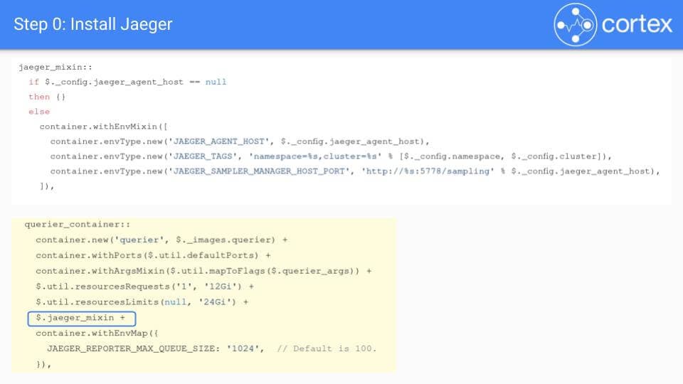

For debugging queries, especially those that are latency-sensitive, the Grafana Labs team uses Jaeger distributed tracing. To configure Jaeger into Cortex, you can use the Jsonnet above or simply add these enrollment variables:

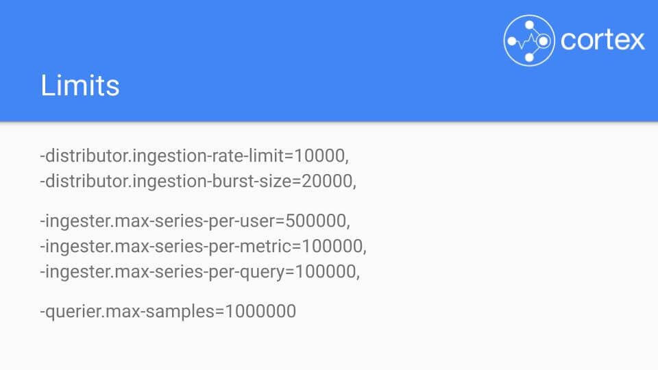

1. Keep the default limit for tenants very low, and once it’s hit, get an alert. “You need to make sure that they’re not querying 100 million time series or 5 million time series over 30 days of data,” he said. “You need to make sure that they are not OOMing all the queriers for everyone else.”
2. Set a limit to the number of samples per second that each distributor can handle, the number of series that each ingestor should have per user, and the number of series per metric.

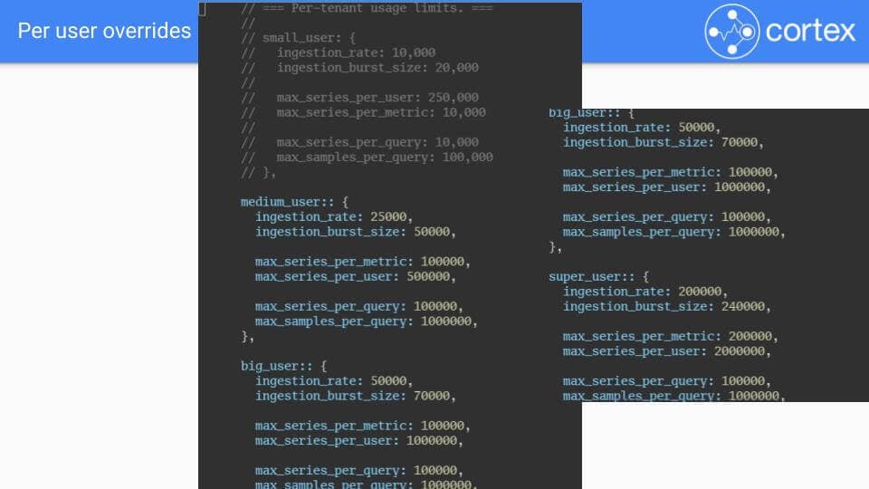

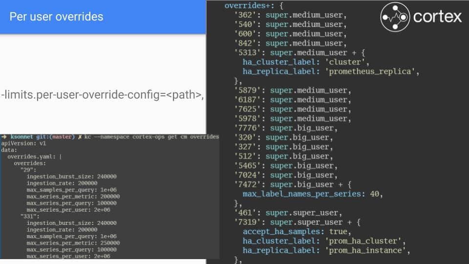

3. When customers hit the default limit, be able to increase the limit as needed. “Cortex is able to override the limits per user, and we use jsonnet on it to template this out because we have hundreds of users and we don’t want to set every one of them by hand,” he said. Grafana Labs uses override variables (small, medium, large, etc.) and a config management solution that’s open source. “There’s a config map that’s updated that Cortex takes up,” he said. “You can see how easy it is for us operators to manage this complexity.”
Embedded imageEmbedded image
