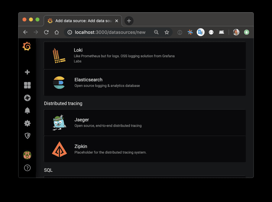

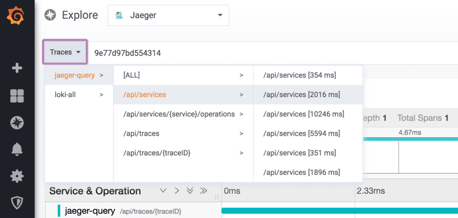

The experimental Jaeger datasource also comes with a trace selector that shows a list of services that break down into their operations, and then show the ten most recent traces. We added this so you can quickly browse traces when not coming directly into Explore with a trace ID.
Embedded image
The changes to Grafana making this possible are very much a work in progress; you can follow along with the PR.
