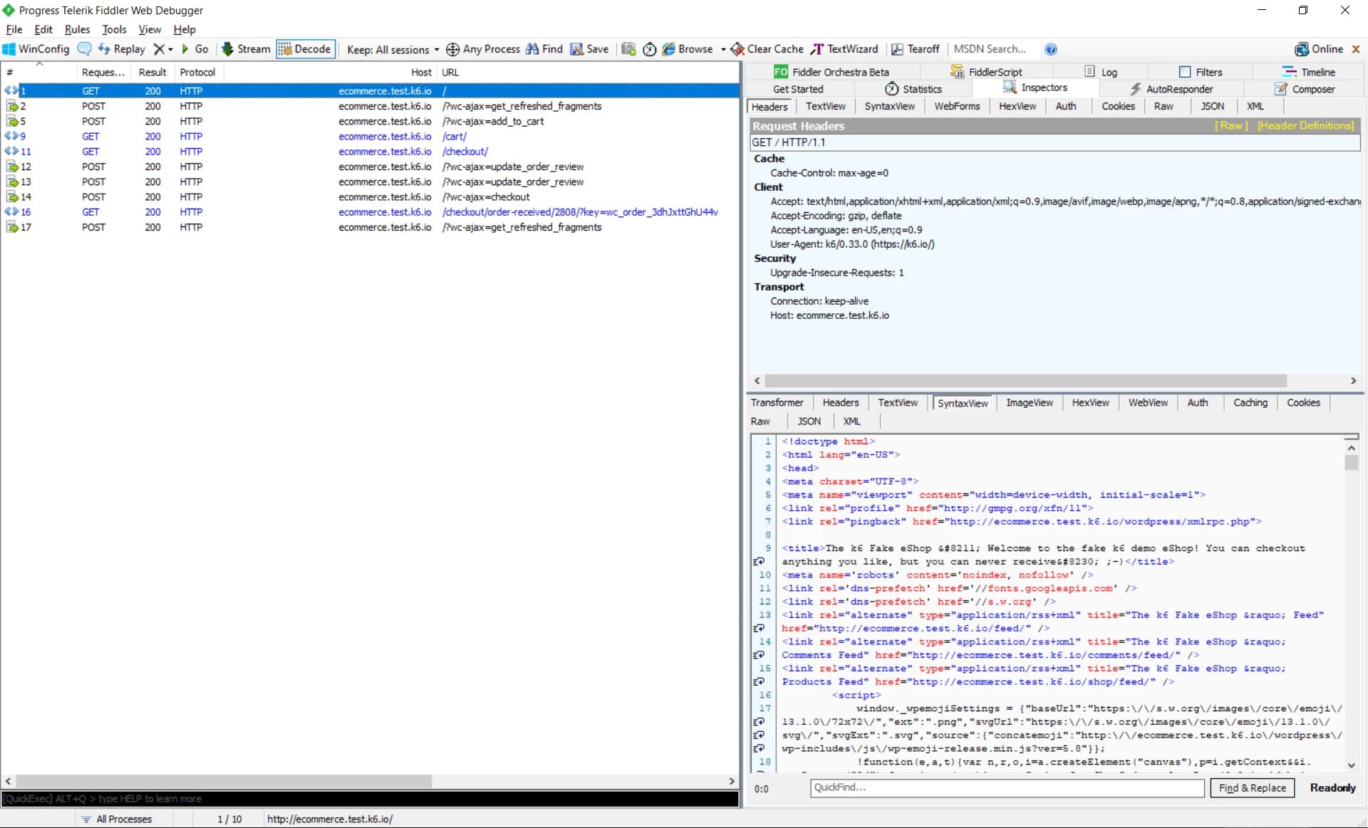

What you see will be reminiscent of the output a browser’s Developer Tools > Network tab might show. Here’s the output from running the example-woocommerce set of scripts:
Fiddler UI
Each entry will allow you to see the HTTP request parameters as well as those of the corresponding response. Headers, POST data, and response bodies are the most interesting of these parameters, and there will usually be ways of formatting data depending on their Content-Type. Being able to display JSON in its “beautified” form can really help make sense of things, especially when you don’t know the inner workings of the target system!
