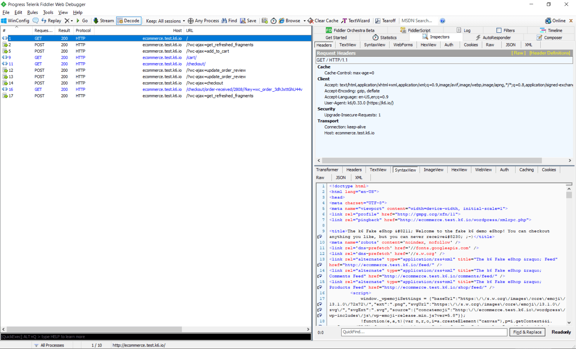

What you see will be reminiscent of the output a browser’s Developer Tools > Network tab might show. Here’s the output from running the example-woocommerce set of scripts:
Fiddler UI

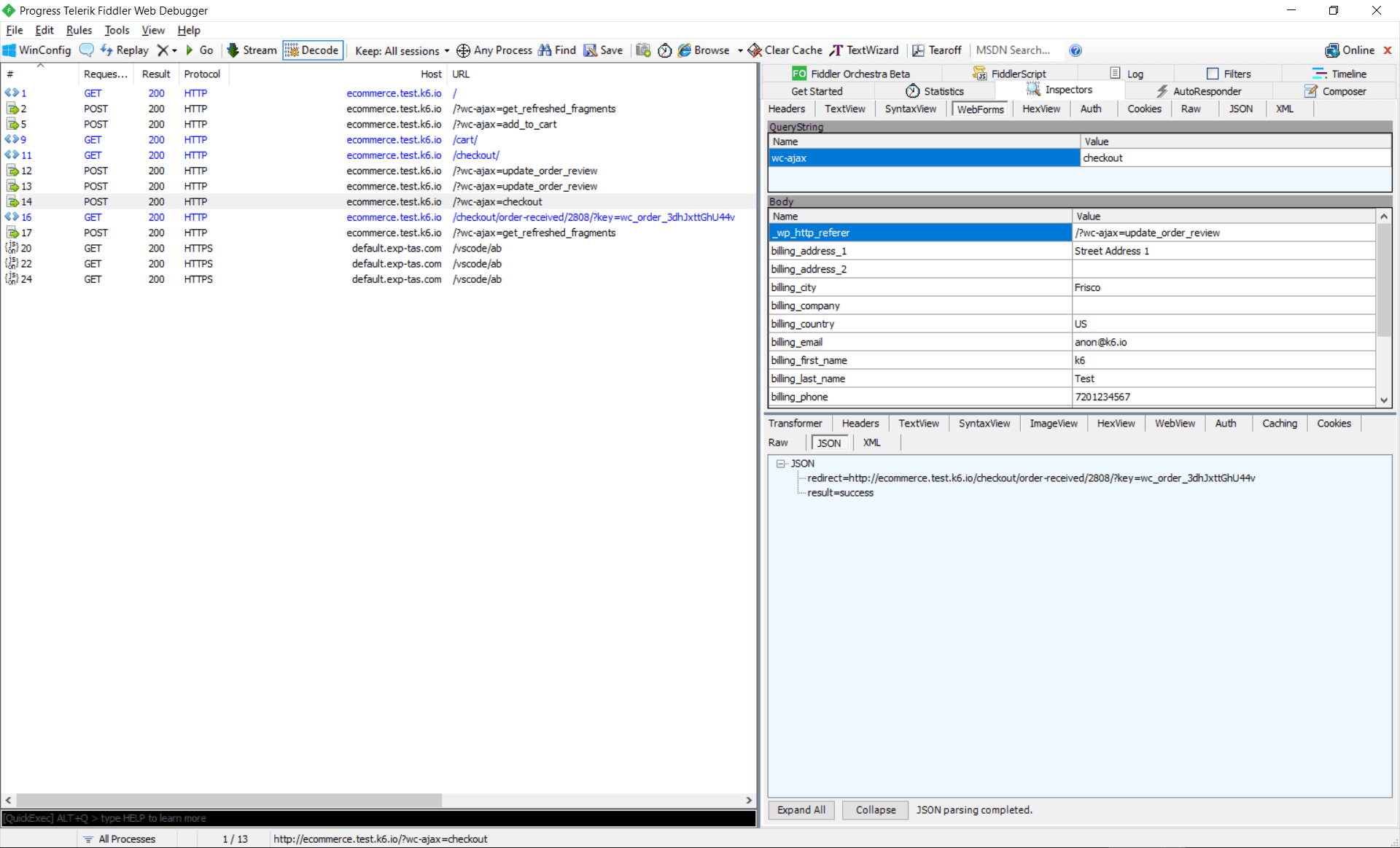

Each entry will allow you to see the HTTP request parameters as well as those of the corresponding response. Headers, POST data, and response bodies are the most interesting of these parameters, and there will usually be ways of formatting data depending on their Content-Type. Being able to display JSON in its “beautified” form can really help make sense of things, especially when you don’t know the inner workings of the target system!
Formatted responses in Fiddler

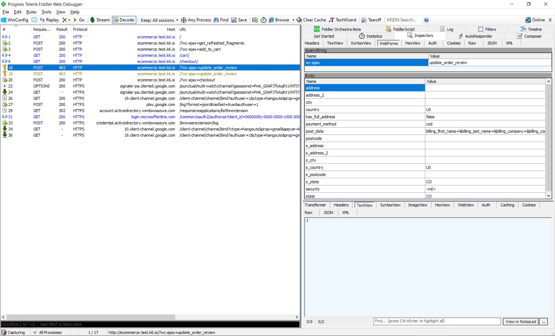

The default k6 output will let you know if you receive HTTP responses with status in the 4xx-5xx range as these inherently indicate some kind of problem in most cases. k6 will mark returned status codes in this range as failures unless otherwise specified. WDPs tend to do the same as well, making it easy to narrow down on problematic requests. For instance, should I fail to correlate a couple of key tokens used on the web form during the POST to checkout, I receive a couple of HTTP 403 Forbidden responses, with the selected one returning a -1 when instead I’m expecting to see a success message:
Error response screenshot in Fiddler
Of course, what you see here will be entirely dependent on the application you are testing.
