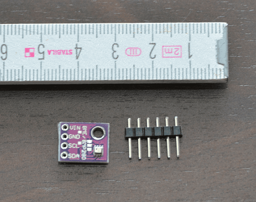

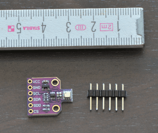

First, solder your BME’s connectors if they don’t come pre-soldered.
BME 680:
Embedded image
BME 280:
Embedded image

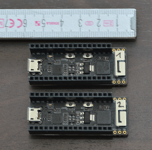

If you have more than one of a particular thing, you should strongly consider giving them an identity. There are high-quality markers that write reliably onto stainless steel and such, and they are immensely useful. Myself, I own a Pica Classic 533 in black and a Pica 532 in white, and I use them at least once per week. Giving an identity is as easy as numbering things from 1 onwards:
Embedded image

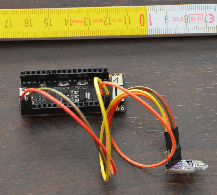

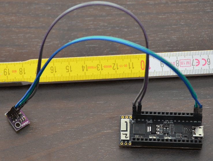

And then simply wire them up. If you’ve been waiting for weeks for your short jumper wires, your setup might look something like the following… If you’re lucky and you have shorter wires, yours will be prettier than mine.
The connection itself is quite simple. From the ESP’s point of view, you connect
  • Any ESP32 3.3V pin to 3.3V on the sensor
  • Any ESP32 ground pin to ground on the sensor
  • The ESP32’s pin 21 to SDA on the sensor
  • The ESP32’s pin 22 to SCL on the sensor
Ignore all other pins.

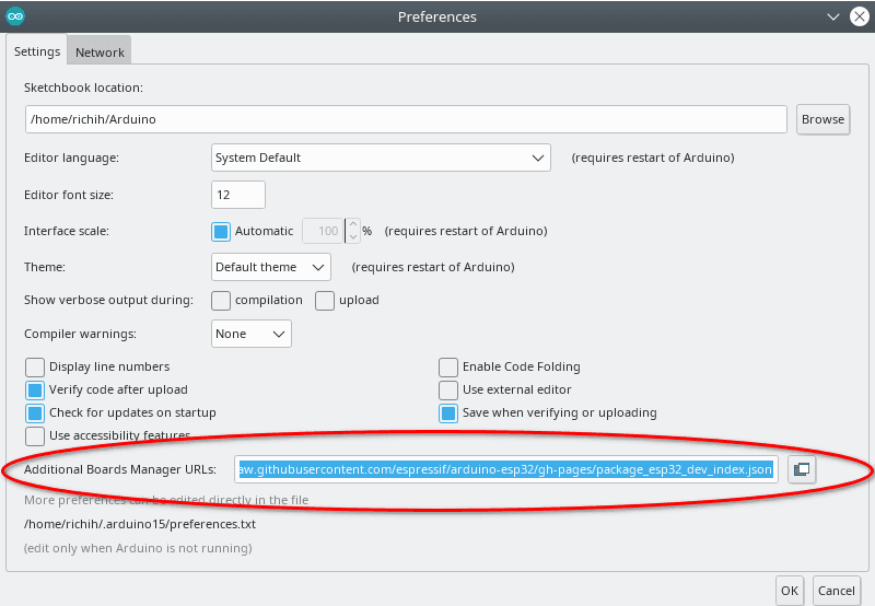

Set up Arduino IDE
  1. Add local support for ESP32 boards: Open “File” -> “Preferences” and copy https://raw.githubusercontent.com/espressif/arduino-esp32/gh-pages/package_esp32_dev_index.json into “Additional Board Manager URLs.”

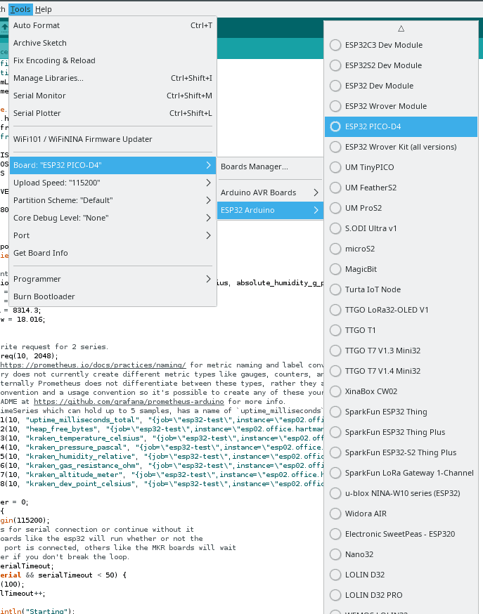

  1. Select the correct board from “Tools” -> “Board” -> “ESP32 Arduino”:
Embedded image

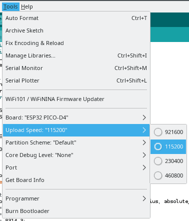

  1. Select the serial speed from “Tools” -> “Upload Speed” -> “115200”:
Embedded image

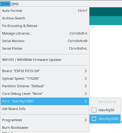

  1. Select the correct port from “Tools” -> “Port.” On Linux, the correct port should look like /dev/ttyUSB?. dmesg can help you find the right one. On some systems, you may need to add your user to usergroups like modem; if all else fails, on a single user system, you can simply use chmod 777 /dev/ttyUSB*. Not recommended, but it works, and a reboot or device reconnect will reset it.
Embedded image

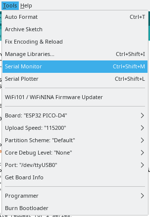

  4. Open the serial monitor with “Tools” -> “Serial Monitor.”
Embedded image

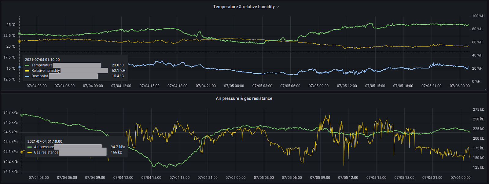

After all this work, how about some dashboards?
  1. Use Grafana Cloud’s Explore mode to verify that you’re received data:
Embedded image

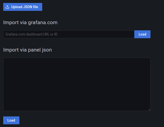

  1. Go to Grafana Cloud’s Panel Import.
Embedded imageEmbedded image
  1. Import the dashboard from https://github.com/RichiH/kraken/blob/main/bme_680/kraken-bme680-mixin/dashboards/kraken_bme680.json as file or copy-and-paste of the raw JSON.
As an optional step for site operators: Choose alerts from https://github.com/RichiH/kraken/tree/main/bme_680/kraken-bme680-mixin/alerts. I created alerts for ASHRAE 55 recommended, A1, A2, A3, A4, B, and C. That should fit everything from the highest-class data centers to a cowshed. If you’re in Europe and operating/certified under EN 50600, you are free to assess your own needs and simply align with any ASHRAE envelopes if you so choose.
You will also find an alert for dew points in there. This is useful if you have a room that can get damp or moldy: As long as you’re staying 2-3C above the dew point, you will not have any mold growing, ever. If you’re near the dew point, either heat up the air or get moisture out. Either works, and you will see the effects in the dew point curve immediately.
The last step is the most important one: Enjoy!
