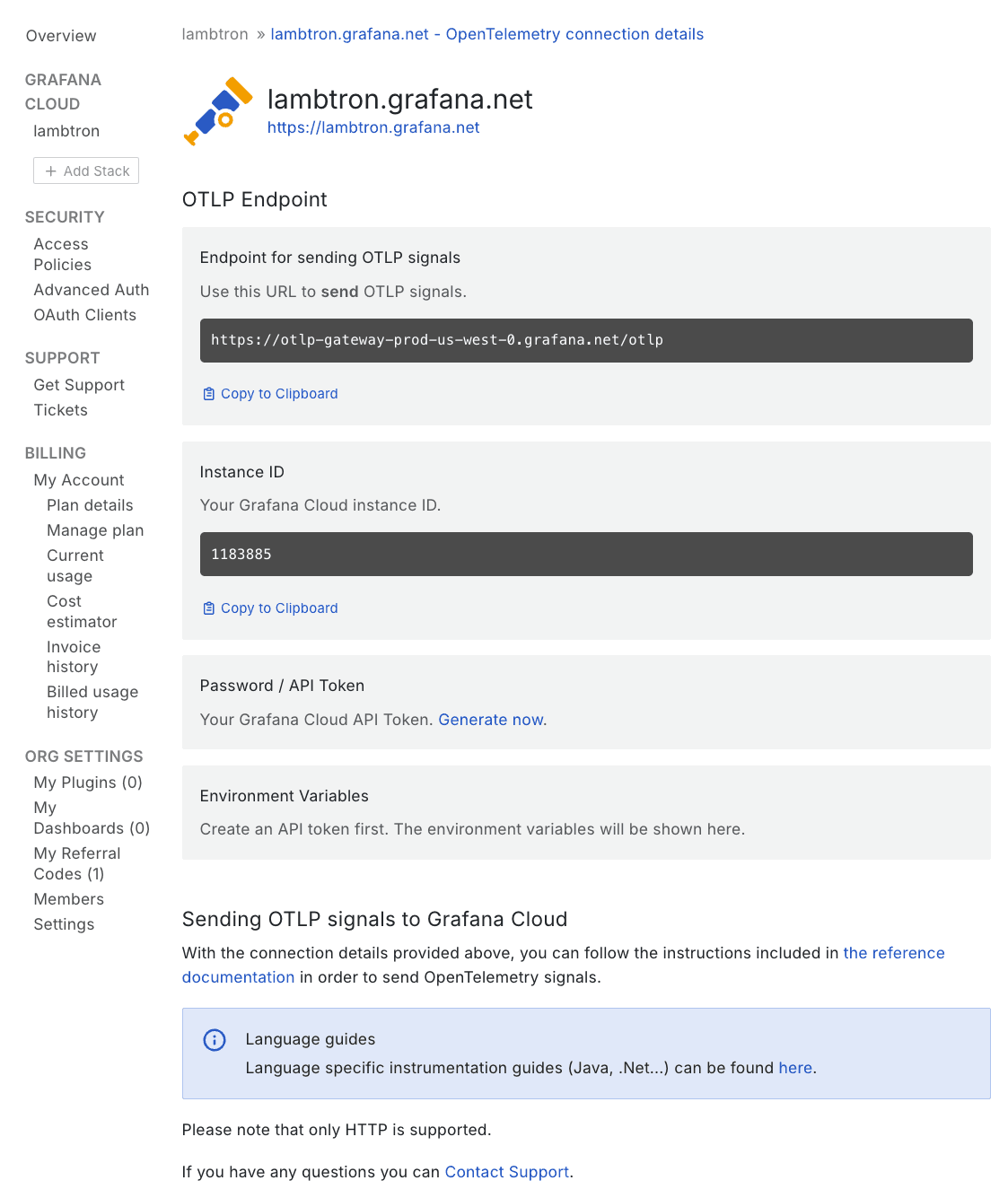

Next, create a free Grafana Cloud account, which will provide you with a Grafana Cloud stack. Click Details, find OpenTelemetry, and then click Configure. This page will provide you with the OTLP Endpoint, Instance ID, and Password / API token, which you'll need to configure your collector.
Screenshot of Grafana Cloud settings page showing OTLP Endpoint details.Finally, in our otel-collector.yml file, let’s define how telemetry data should be exported to Grafana Cloud with those aforementioned details:

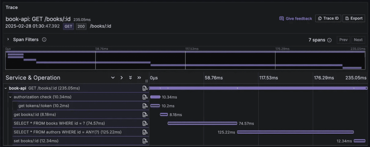

Connecting spans and traces by request

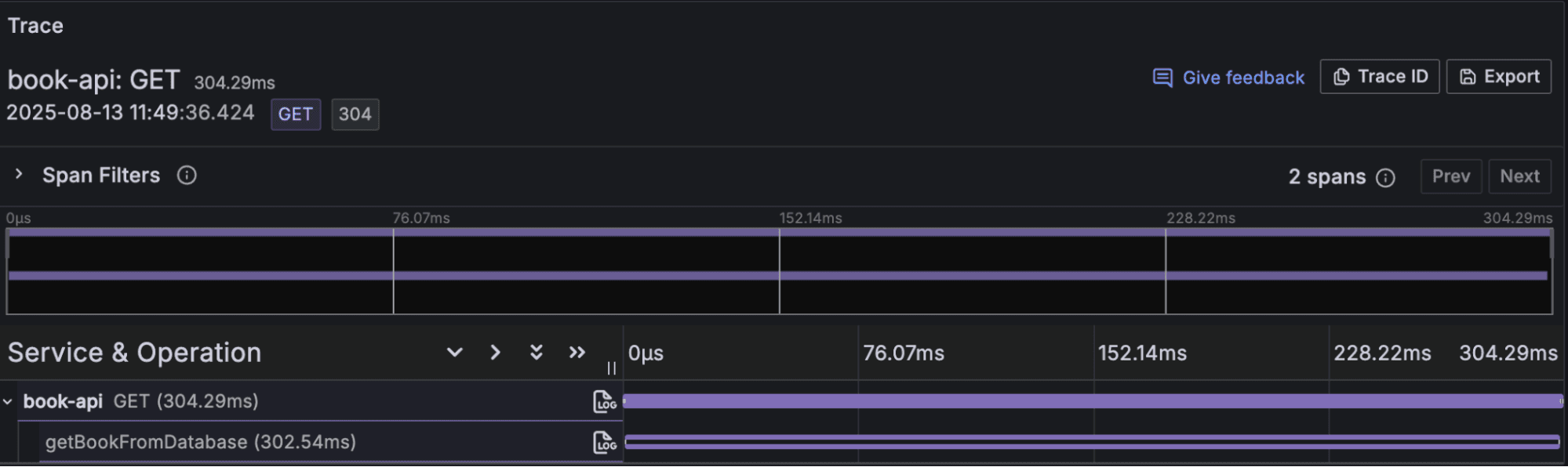

Spans and traces help answer the who, what, when, and duration of exceptions in production. Without any additional code instrumentation, Deno will automatically create a span for each incoming and outgoing HTTP request (this includes fetch, Deno.serve, and node:http):
Trace visualization of a book API call showing service operations, spans, and execution times.This trace shows a single GET request, which triggered an authorization check, and two database queries.
In order to have the subsequent spans nested correctly under their parent operation in the trace, we can add some additional code that assigns each operation a span ID and passes that value as a Parent Span ID for its children operations.

Now when we send another request to our API and view its trace, we can see the new getBookFromDatabase as a nested span under the parent HTTP trace:
Trace analysis of a GET request in a book API, showing timing details for operations.

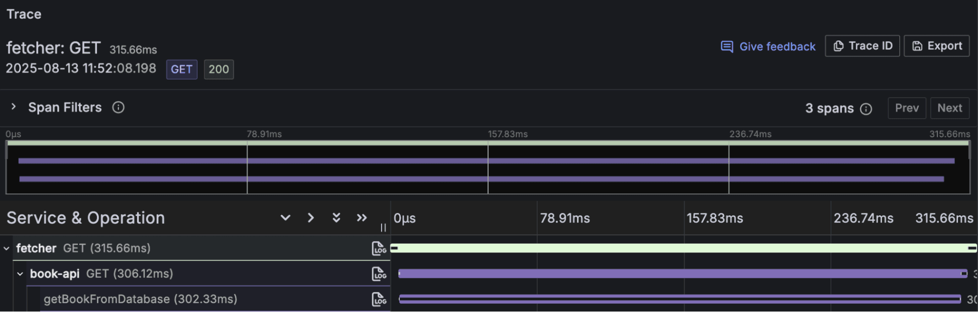

Using Deno and its built-in OTel support skips all of this. Deno automatically propagates trace information between services: injecting trace information into outbound requests and reading trace information from incoming requests.
Let’s take a look at an example. We’ll run a new script that simply calls the API server with fetch:
const resp = await fetch("<https://localhost:8000/api/book/1>");
const book = await resp.json();
console.log(book);
We’ll run this with Deno and OTel:
$ deno run -A --unstable-otel main.ts
{ id: "1", title: "The Great Gatsby", author: "F. Scott Fitzgerald" }

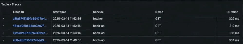

In Grafana Cloud, we can see that the latest trace has a new service name:
A table listing traces with columns for Trace ID, Start time, Service, Name, and Duration.Clicking on that reveals three spans:
Decorative imageDeno has automatically tracked a single trace across two services. For more complex microservice architectures, you could imagine having deep nests of spans across several services.

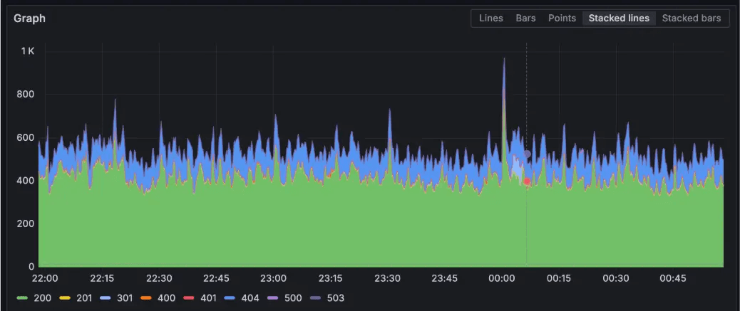

Built-in metrics
Metrics are a great way to alert you when to investigate an issue. They are aggregate data that show how frequently something is happening. For example, a common setup for any web server would be to measure the percentage of requests with 500 status codes, and to set an alert when that percentage exceeds 1%.
A graph with stacked lines showing data trends over time, featuring green, blue, and red areas representing different data sets.If you want more context about the health of your program, Deno will also automatically collect metrics on V8, letting you monitor metrics such as v8js_memory_heap_size_bytes and garbage collection duration.
