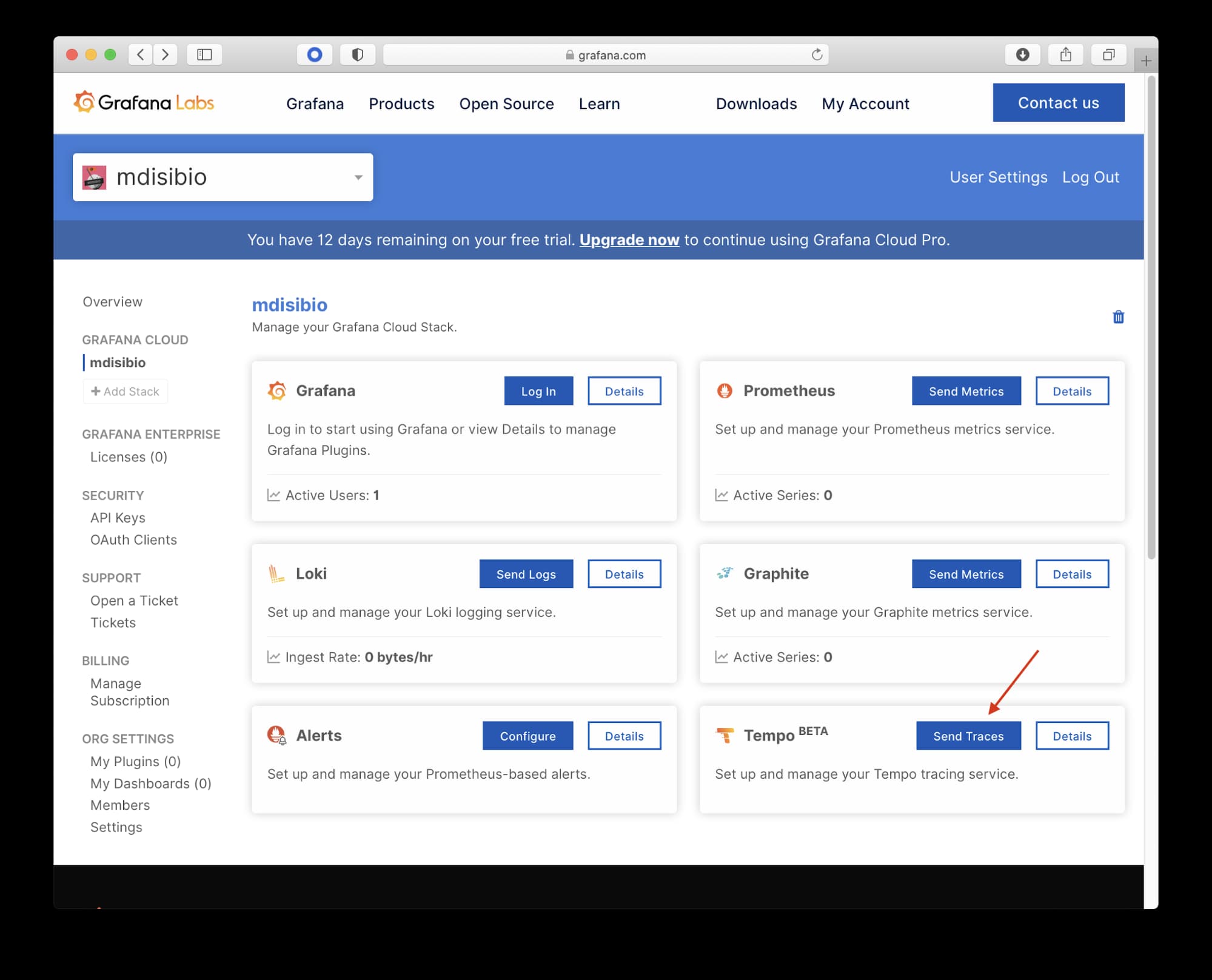

Your Grafana Cloud credentials for Tempo can be found under the My Account page. Choose the stack, then Send Traces to view your username. API Keys are managed under the Security -> API Keys section. Add these values to the agent-config.yaml.

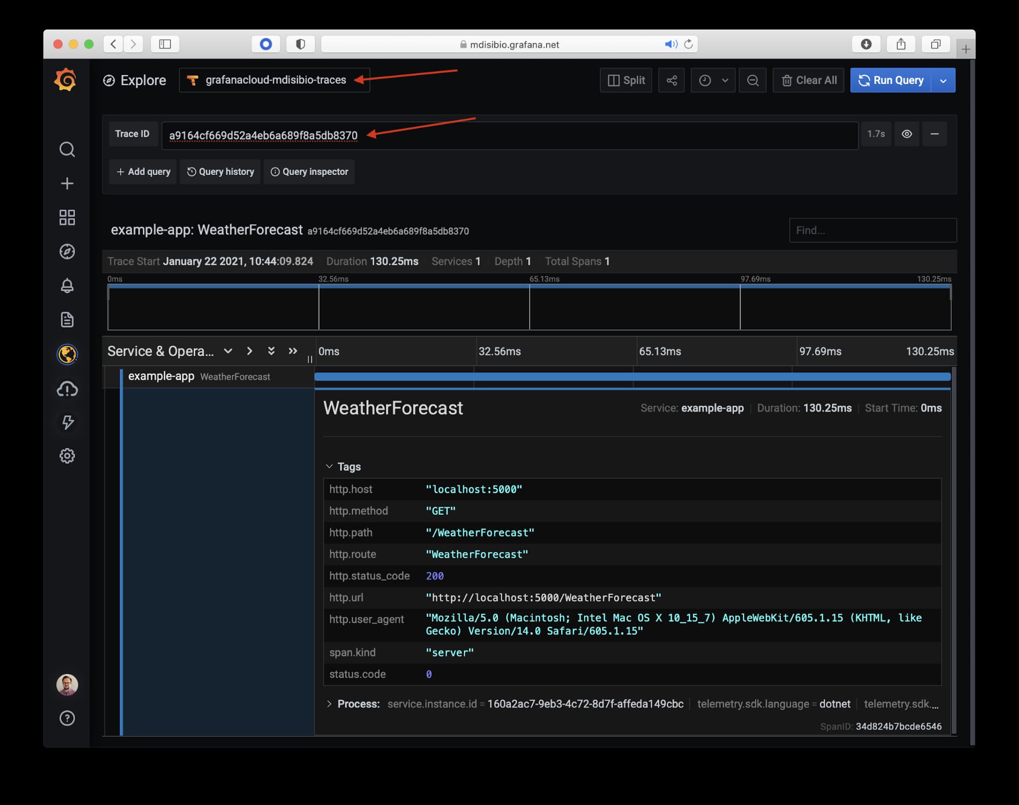

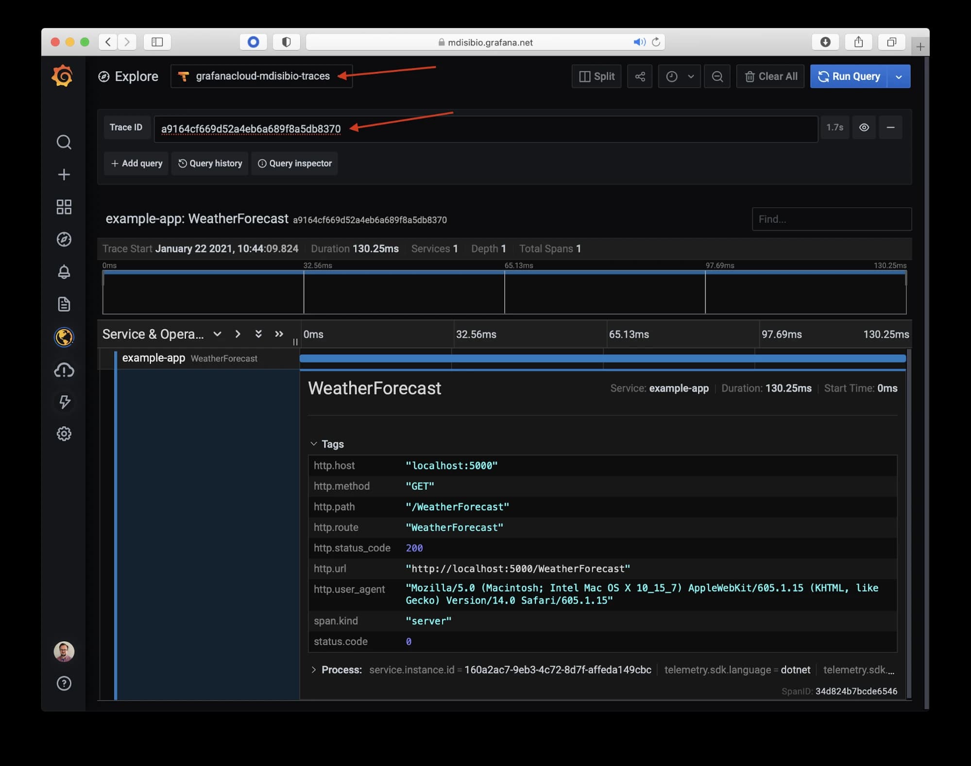

Run everything with docker-compose up and call the /WeatherForecast API again. Since we still have the console exporter, we can use the output to get the trace ID and view it in Grafana Cloud.
Look for the Activity.Id. The second segment is the trace ID.
app_1            | Activity.Id:          00-a9164cf669d52a4eb6a689f8a5db8370-34d824b7bcde6546-01
app_1            | Activity.DisplayName: WeatherForecast
app_1            | Activity.Kind:        Server
app_1            | Activity.StartTime:   2021-01-22T15:44:09.8240910Z
app_1            | Activity.Duration:    00:00:00.1302539
Log into your Grafana Cloud Stack (.grafana.net) and go to Explore. Choose the Tempo data source and paste the trace ID. Now we are viewing traces in Tempo!

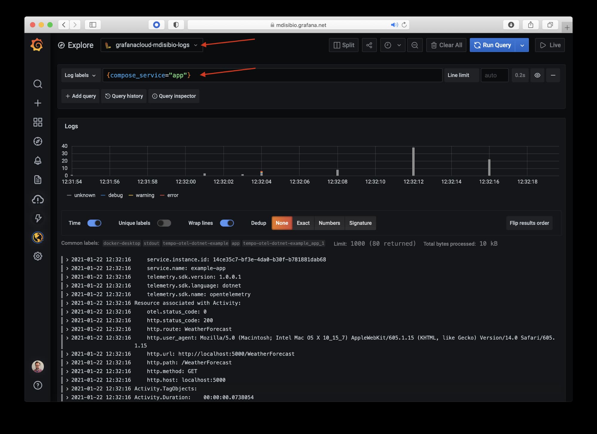

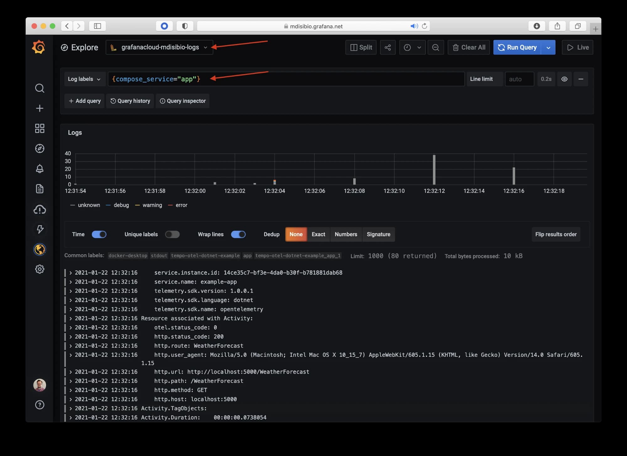

Now we can view logs for our application in Grafana Cloud at .grafana.net -> Explore. Use the following LogQL query to find the log messages for our app:
    {compose_service="app"}

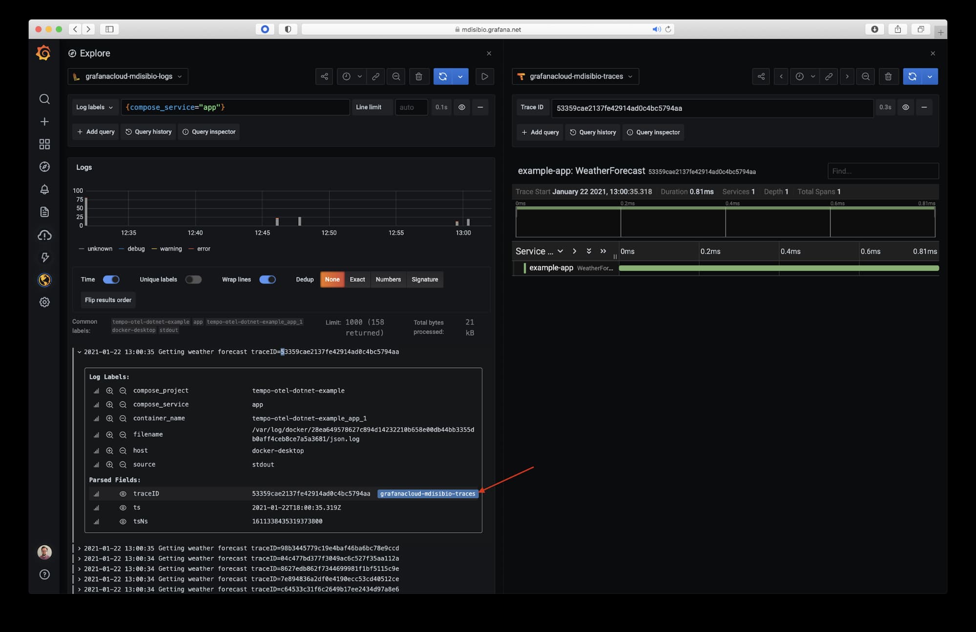

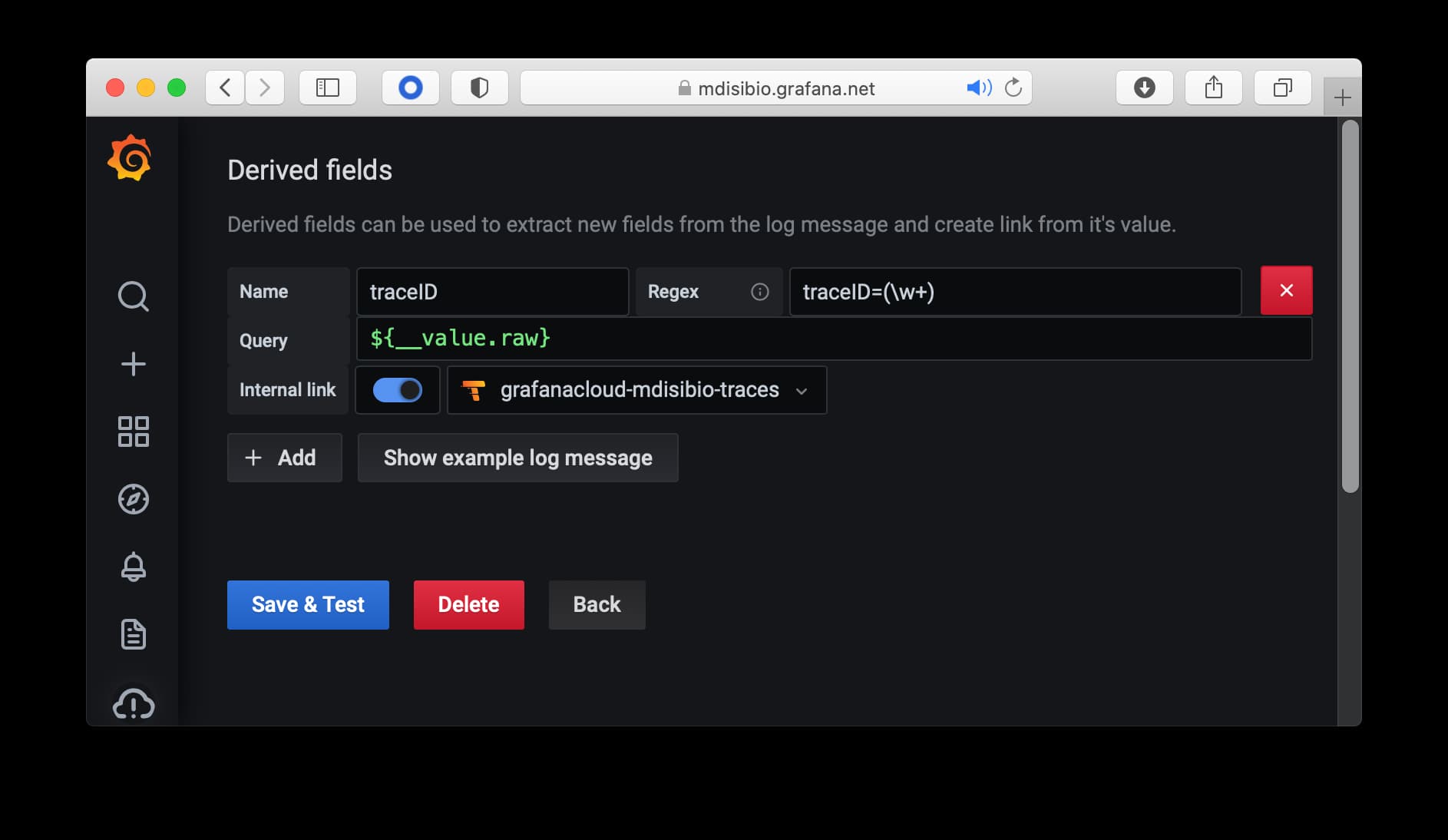

Next, create the Loki derived field in Grafana Cloud. This derived field is how we can turn the “traceID=…” log portion into a clickable link to view logs and traces side by side. See the blog post link above, but the steps are also repeated here for clarity:
  1. Configure your Loki data source by browsing to .grafana.net, Settings -> Data Sources.
  2. Towards the bottom of the configuration page, add a new derived field with the following properties:
    1. Name: traceID
    2. Regex: traceID=(+)
    3. Query: ${__value.raw}
    4. Internal Link: Yes, and point to your Tempo data source. This is the same data source from above when viewing traces.
Embedded image
Finally, let’s look at our logs again. Expand one of the log lines and now we have a clickable link to quickly jump from logs to traces and view them side by side!
Embedded image
