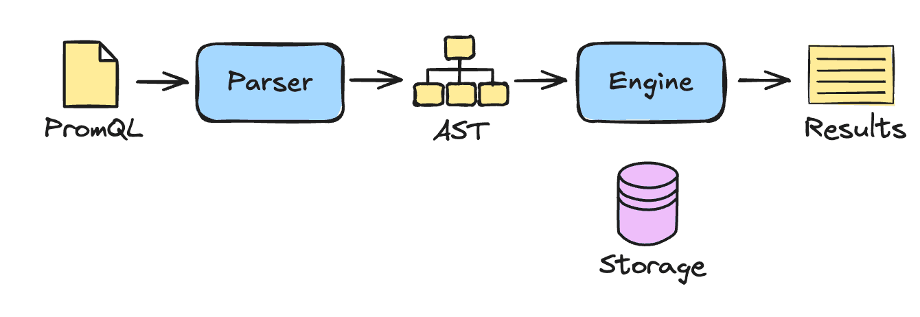

Inside Prometheus, the module that does most of the work is called the “engine.” PromQL is processed by the parser to create an Abstract Syntax Tree (AST) which the engine executes, pulling data from storage, and then outputs the result. (We’ll cover ASTs more below.)
Parsing
The parser takes the textual form of PromQL and transforms it into a data structure to drive the PromQL engine. As an example, let’s take this query:
rate(http_requests_total[5m]) > 0
The parser will turn it into the following tree:
As mentioned above, the technical name for this is an Abstract Syntax Tree. Simply put, it’s a data structure with nodes representing selectors, operators, functions, etc. It has one root (at the top of the picture — computer trees grow downwards), and you can “walk” down the links to find everything that was in the original query.

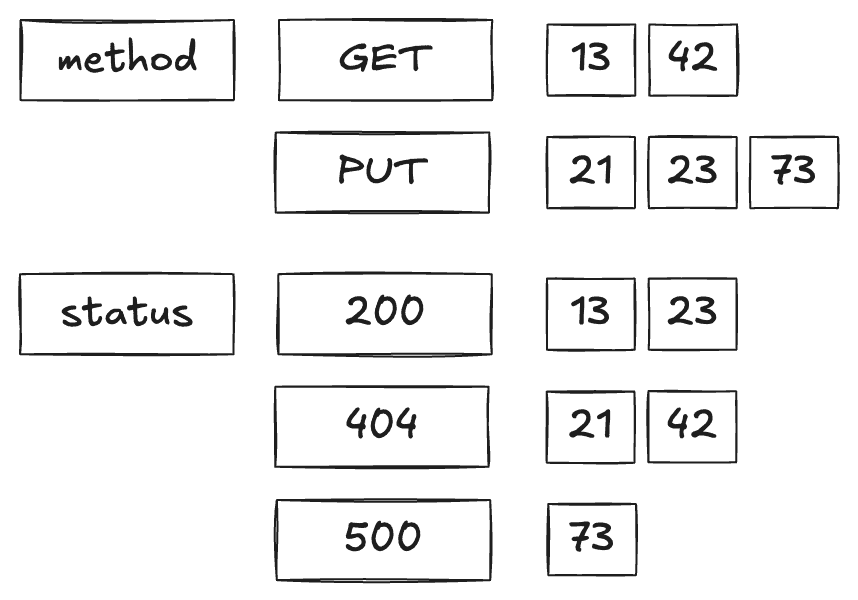

A selector in PromQL looks like a series, but it doesn’t have to specify all labels. For example http_requests_total{status="200"} should fetch the two series that have that status.

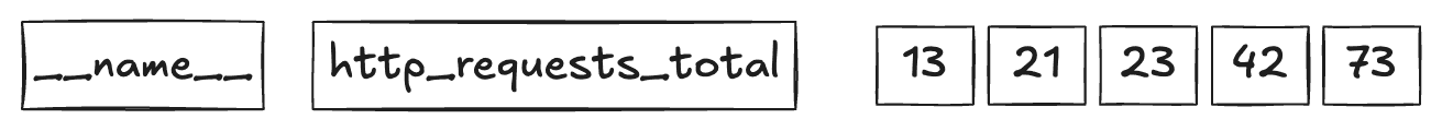

The index starts with label names. Under each name are all the values for that label, and against each value is a list of series IDs. Traditionally, in databases, these lists are given the unusual name “postings.”
The name of the metric is just another label, with the special name __name__.
So, a selector like http_requests_total{status="200"} is equivalent to {__name__="http_requests_total",status="200"}.
To look up the index, we take all the postings lists that match each part and intersect, to give us all series that match all parts of the selector.

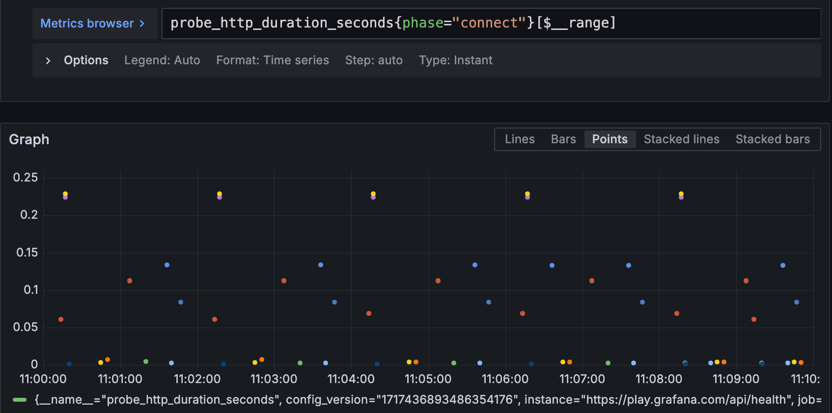

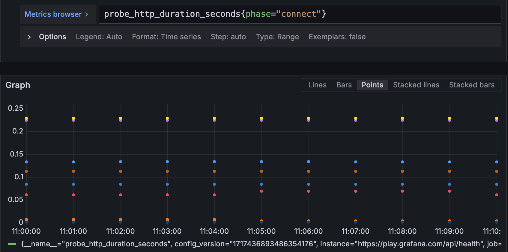

To illustrate the concepts of series and samples, let’s look at a simple query, shown here in Grafana.
The query returned 14 time series, each relating to a different source of data. Each sample has a value, plotted on the vertical axis and a timestamp, which Grafana lays out horizontally. Each series is drawn in a different color. The timestamps are in nice, regular intervals, according to the step parameter; in this case, Grafana picked 1 minute. Having all points lined up is what you want if you’re going to compare the values, or do arithmetic on them.
However, real-world data is not usually so neat. In Grafana, if you select Type: Instant but put the whole dashboard range in as a range vector selector [$__range], you can see the underlying data points. This little trick is extremely useful when working with PromQL to understand what goes into the computation.
In our example, each data source provides data at a different time offset, so the points as a whole look scattered across the panel.
When PromQL takes a sample from each time series, all at the same timestamp, this is called an instant vector. A range vector, on the other hand, is a set of time series containing a range of data points over time for each series. In PromQL, a range vector is specified with a duration in square brackets, like [5m] for five minutes.
Note that “range vector” is different from “range query.” A range vector is found inside a PromQL expression, while a range query executes a whole PromQL expression at regular intervals from a start time to an end time.

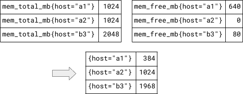

When a binary operator is used between two instant vectors, PromQL goes through a process of matching labels. Here is a basic example, where PromQL will match labels on each side one-for-one:
mem_total_mb - mem_free_mb
As with functions, there is no __name__ label on the output.

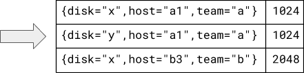

A common pattern using operators in PromQL is to “join” a series with some values with an “info” series containing more labels, and where every value is 1. To illustrate:
disk_mb * on (host) group_left(team) host_info
In the expression, on gives the list of labels to match on, and group_left says the left-hand side can have multiple matches. Extra fields in brackets are added from the other side.
The PromQL engine first extracts the “signature” of each series, with just the on labels, then constructs a map (hash table) of signatures on the “one” side, and then goes through the “many” side and finds the match.
Finally, the result series are assembled, taking all labels (except __name__) from the “many” side and the extra labels listed after group_left from the “one” side.

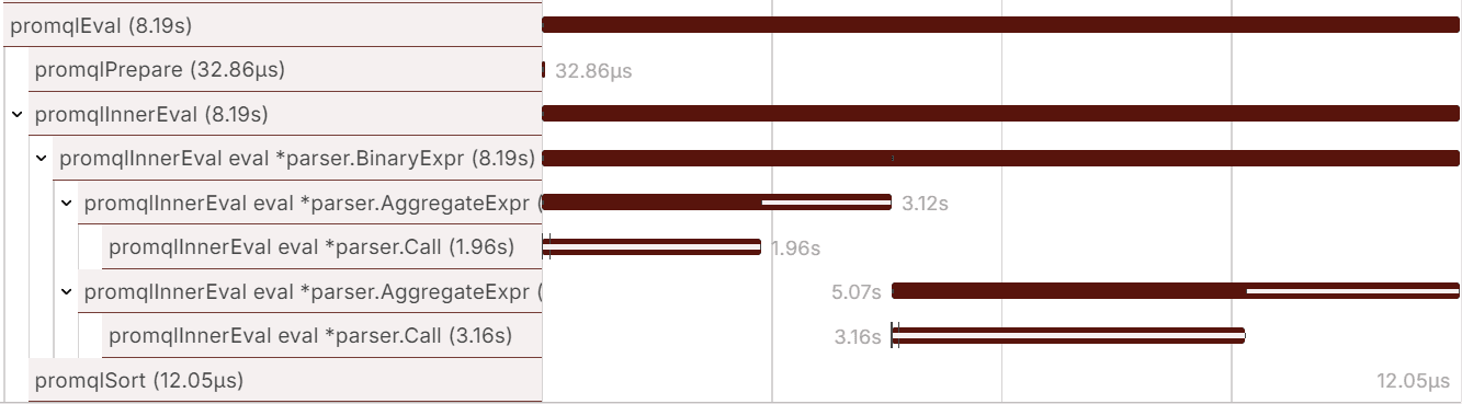

Tracing
Prometheus is instrumented with OpenTelemetry tracing, so if you have a distributed tracing system like Jaeger or Grafana Tempo, you can use that to view individual queries and see how they were executed.
This example is the query sum by(job, mode) (rate(node_cpu_seconds_total[1m])) \ / on(job) group_left sum by(job)(rate(node_cpu_seconds_total[1m])).
Traces are made up of spans, each with a start and end time. In the viewer, time goes from left to right, and flow from top to bottom. The indentation of trace spans shows how the PromQL engine executes each node in the AST. In this case, a BinaryExpr node calls two AggregateExpr nodes, each of which calls a Call node representing the rate() function. Data fetching for range vector selectors appears as part of each Call span.

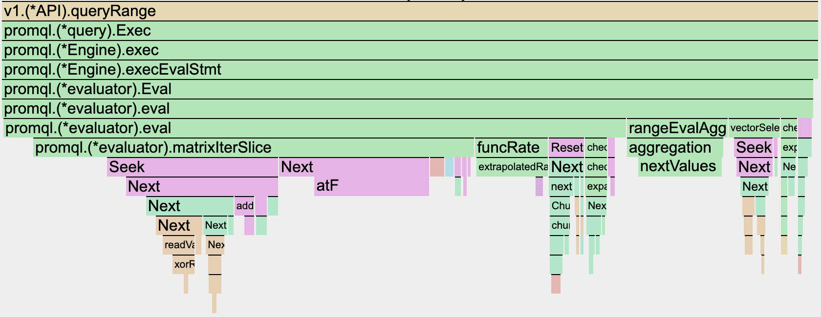

Profiling
Prometheus is also instrumented for CPU and memory profiling, courtesy of the Go language runtime, so we can take a look at CPU usage. The image below shows Prometheus executing a mix of queries over a 30-second period, so it can’t be mapped directly to an individual query, but you can still see how the calls break down. This is a flame graph view, in which calls from one function to another go from top to bottom, and the width of each bar indicates how much of the profile time was spent in that function.
