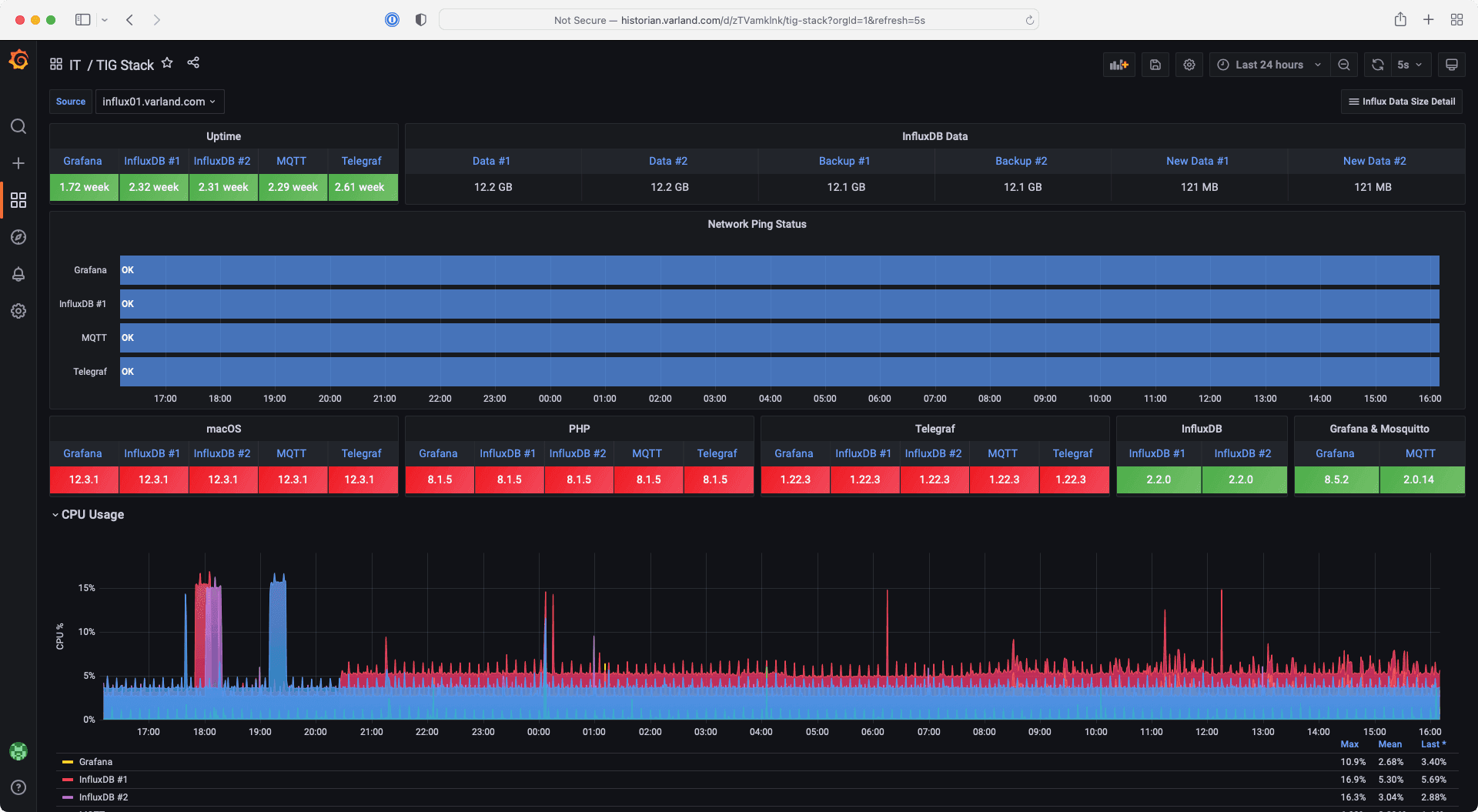

By setting up a TIG stack (Telegraf for data collection, InfluxDB for storage, and Grafana for contextualizing and displaying data), Varland created a system that is much more automated and provides a better, customizable visualization experience. Varland chose Grafana, in part, because it was so easy to get started.

With their updated architecture, everything is optimized to run on separate, specialized components. It’s all designed for multiple simultaneous remote client connections, and, most importantly, they can create any type of visualization they need with Grafana.

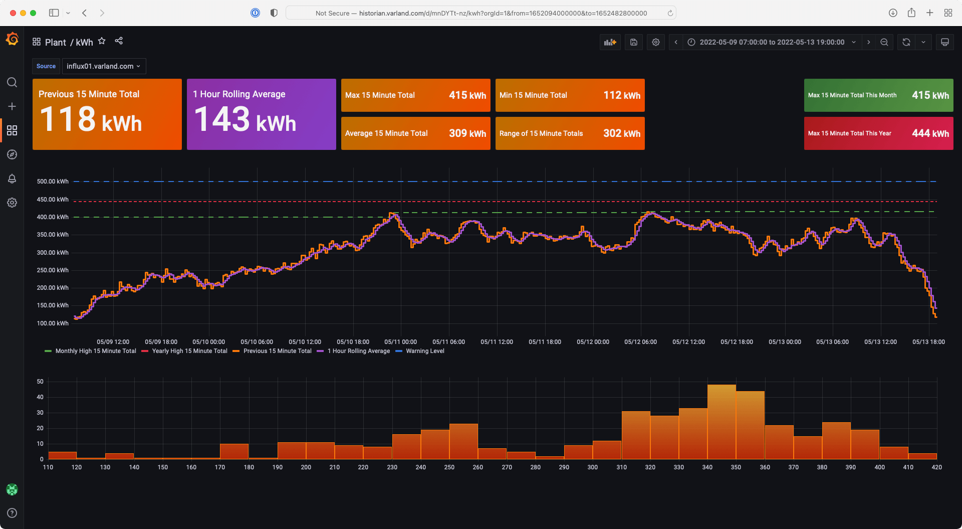

“Whatever you can dream of you can probably find. And if not, there’s a bunch of resources for how to build it,” said Varland. With Grafana, the team can create visualizations that use histograms, graphs, and tables to display key metrics all at once. Varland uses everything from state timelines to color-coded line graphs to visualize key statistics and share metrics across the company.
Varland is also able to aggregate and analyze data more robustly now. Grafana provides query options and customizations so the team can create visualizations that suit their data best. They can also look at values across much bigger ranges of data to provide better insights.
