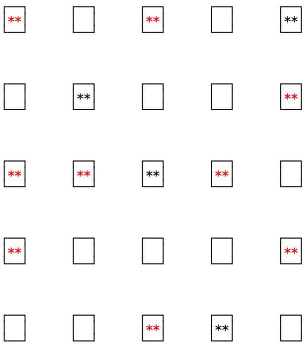

In the picture, we have 25 nodes. The node in the middle has some information that it wants to distribute to all the other nodes. In gossip, every node runs a simple loop: In each iteration, a node randomly picks 3 other nodes, and sends the information to them.
In round 1, information is now available on 4 nodes: the original node in the middle, and three new nodes (marked as red in the picture).

Now all nodes do the same again: randomly pick 3 other nodes, and send the information to them. It’s possible that some nodes get the information from multiple source nodes, or a selected node already has the information. That’s fine.
Embedded image
In the next round, more nodes get the information, and will start sending it out. In a couple of more rounds, all nodes will have it. The number of rounds required to spread the piece of information everywhere depends on the total number of nodes, and how many nodes we randomly select in each iteration (3 in our example).

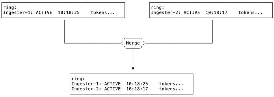

Merging two rings together is conceptually a very simple operation: For non-conflicting updates (different ingesters), we simply put them together.
Embedded image

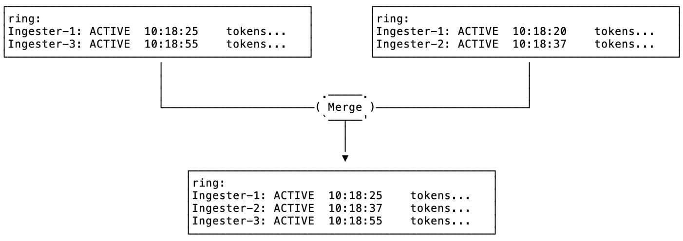

If there are conflicting entries (“Ingester-1” on the picture), the entry with the more recent heartbeat wins. Heartbeats are generated on the ingester and propagated from there, so a more recent heartbeat indicates more recent information.
Embedded image
The merge operation is invoked between the state that node already has and the state (update) that was received via gossip. If the merge operation actually updates a ring, this update is then sent out via gossip to the other members. Sending out only updates (deltas) keeps the messages exchanged between nodes small. The merge operation must be idempotent, commutative, and associative.

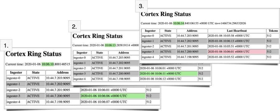

Cortex and Loki distributors have the /ring page where operators can see the ring. Refreshing this page may hit different distributors each time, showing slightly different views of the ring. In the picture below, we see that viewing the /ring page three times shows an older Ingester-3 timestamp on the last refresh. This can happen if the distributor serving the page hasn’t seen the update yet.
