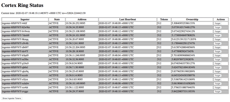

Consul is a consistent KV store that utilizes raft underneath. This means that you can run a Consul cluster, and be sure that all the nodes in the cluster will return the same data when queried. In Cortex, we use Consul with only a single key: the Cortex ring structure, which contains the list of ingesters (their names, the list of owned tokens, and the timestamp of the last update). When distributors send data to ingesters, they know which ingester to go to based on this ring. Arguably, we don’t need a highly consistent or a highly available store for this, and the original Cortex design document even talked about simply using gossip protocol to share the ring.
When ingesters join the cluster, they randomly generate their tokens, and then create an entry into the ring by writing tokens to it. When distributors receive data through an API, they check the ring to see which range of tokens the ingester is assigned to and send the data over accordingly.

The Ingester continually updates its own ring entry with the current timestamp every five seconds (heartbeating). If the distributor and querier see an ingester that hasn’t had a timestamp updated in more than 30 seconds, that indicates that ingester isn’t healthy (e.g. it may have crashed).

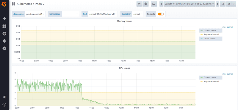

We were doing fine when there were up to 20 ingesters each updating its heartbeat every 5 seconds, which is 4 updates a second in total. But when it was scaled to 50 ingesters, the CAS started breaking down. With many ingesters doing the update at the same time, many of CAS operations fail, and then ingesters need to retry them. This increases the load on Consul. Furthermore with this many ingesters, the size of the ring can reach a megabyte or two (although we have optimized this since).
By default Consul was storing up to 1,024 versions of a key. That initially seemed like an efficient number of versions for the compaction process, but we discovered that because Consul uses BoltDB, it wasn’t actually deleting the old versions. Instead, it was turning the data into zeroes – so with a 2 megabyte key with a thousand versions, it was suddenly trying to write 2 gigabytes of zeroes. Needless to say, this slowed down the process and caused the ingesters to fail their heartbeating.

  • Compact every 128 versions instead of 1,024.
  • Mount a memory disk and write to RAM instead of writing directly to disk.
By essentially “abusing” Consul in this way, we were able to scale up the number of ingesters without running into the inherent issues caused by the built-in Bolt DB method of deletion.
