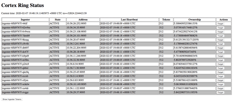

The Ingester continually updates its own ring entry with the current timestamp every five seconds (heartbeating). If the distributor and querier see an ingester that hasn’t had a timestamp updated in more than 30 seconds, that indicates that ingester isn’t healthy (e.g. it may have crashed).
Embedded image
We were doing fine when there were up to 20 ingesters each updating its heartbeat every 5 seconds, which is 4 updates a second in total. But when it was scaled to 50 ingesters, the CAS started breaking down. With many ingesters doing the update at the same time, many of CAS operations fail, and then ingesters need to retry them. This increases the load on Consul. Furthermore with this many ingesters, the size of the ring can reach a megabyte or two (although we have optimized this since).

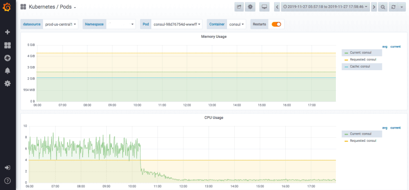

With the number of distributors and queriers growing, Consul got busier and busier with distributing notifications to them. Even if the total number of updates is low (e.g. with 30 ingesters each updating the ring every 15 seconds, it’s only two updates per second in total), sending each update to all distributors and queriers is a lot of work (with 30 distributors and 30 queriers, it adds up to 120 notifications sent out per second). This was, in essence, killing Consul by abusing its API.
Hashicorp has its own recommendations of how to use the blocking API of Consul, which Cortex uses for watching the ring. One of the suggestions is to use rate limit for watching. By allowing each distributor and querier to only issue one API call per second, Consul has more air to breathe and operate with more efficiency.
