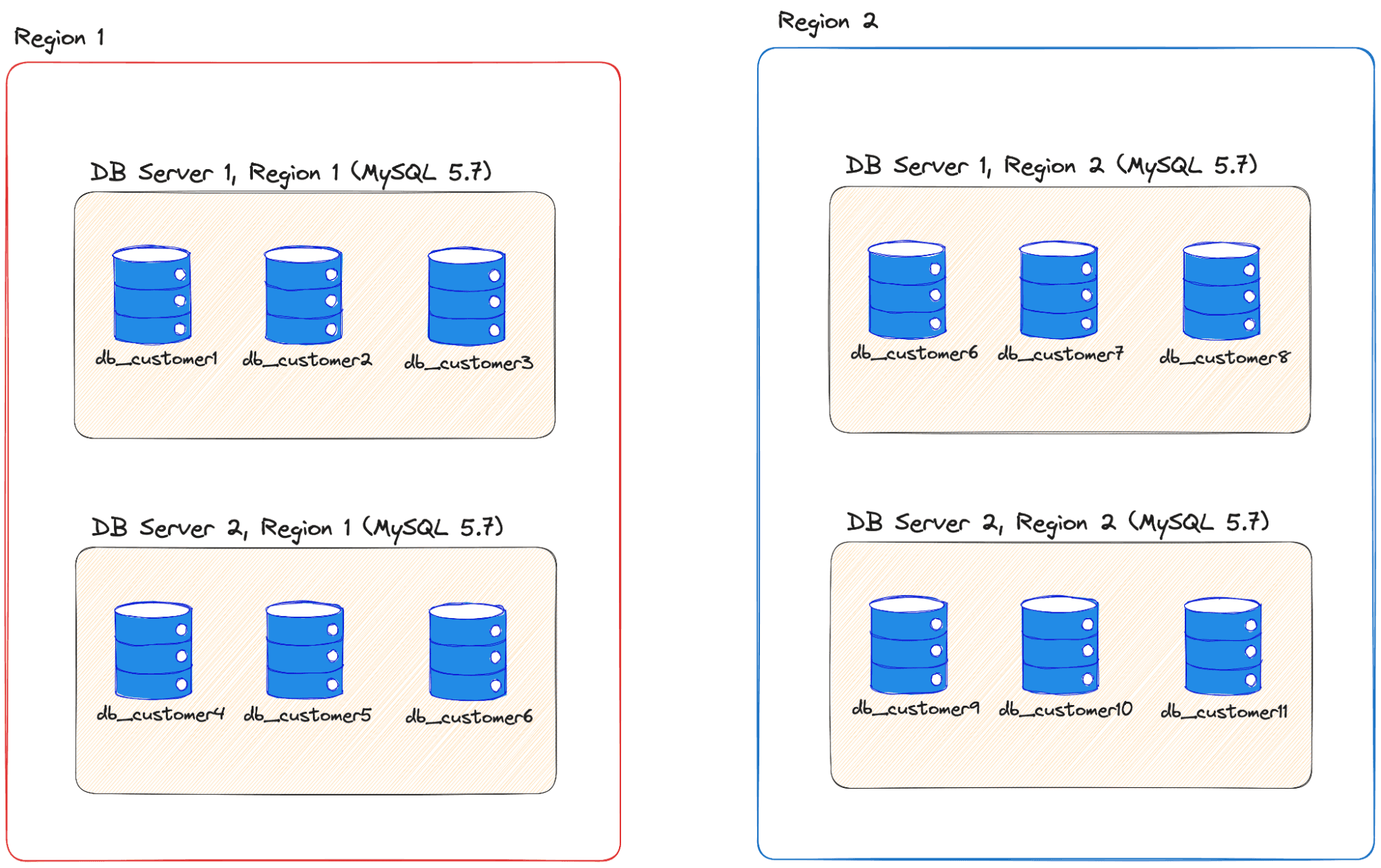

Grafana Cloud’s database architecture 🥞
In Grafana Cloud, our database servers run on multiple cloud providers, are distributed globally, and host single-tenant databases. This means that every customer has their own database within the database server they are assigned to. As some Grafana operators may have noticed, Grafana databases are generally quite small. The vast majority of databases in Grafana Cloud are less than 100 MB. A single database server in Grafana Cloud will have between a few hundred to upwards of 1,000 databases.

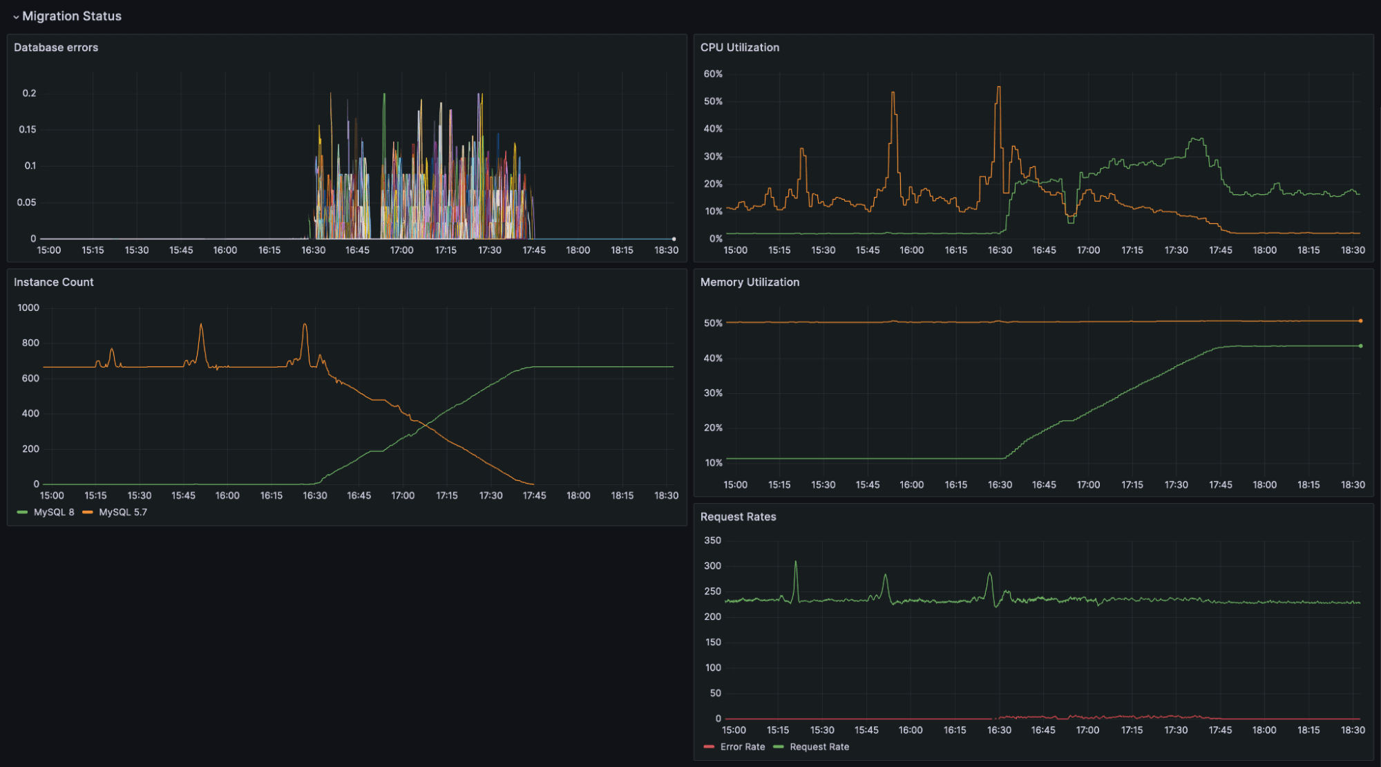

Using a Grafana dashboard to monitor progress 📈
We created a Grafana dashboard to monitor the rollout of the migrations for each cluster. This dashboard tracked how many instances were running on the source and target database servers, instances with a high database error rate, and database server resource utilization. It was important to keep an eye on CPU usage, since MySQL 8 uses a bit more CPU than MySQL 5.7 (about 5-10% more, from what we saw).
