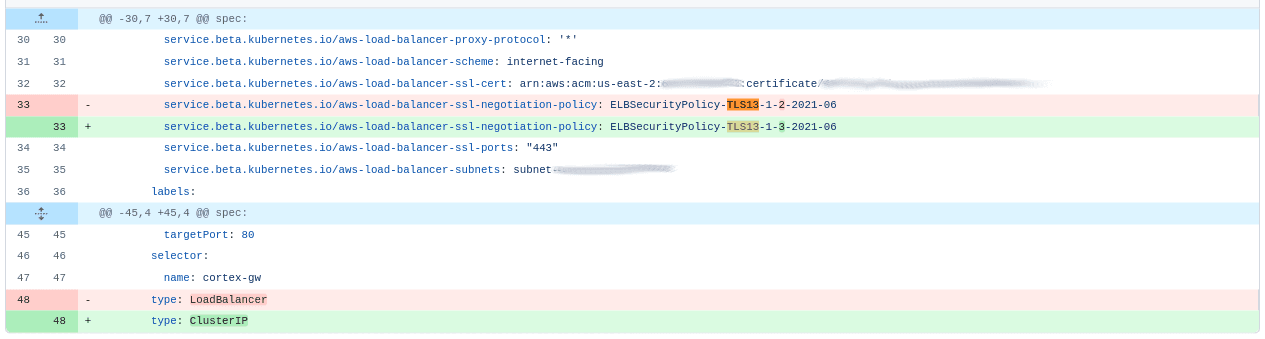

The change actually caused a default value from the base configuration to be unintentionally overridden, resulting in an undesired change in many Kubernetes services from type LoadBalancer to type ClusterIP, causing Kubernetes to destroy the load balancers.
To resolve the problem, we needed to roll back the code change, and then recreate the affected Kubernetes services in order to have Kubernetes recreate the load balancers.

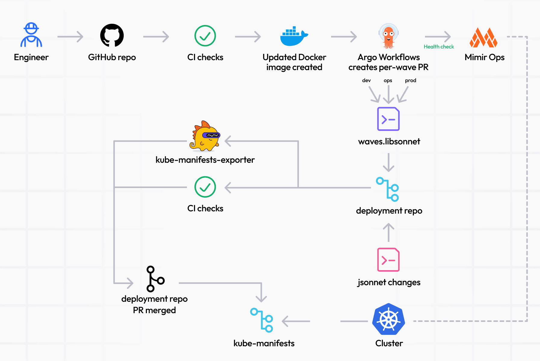

We use the concept of waves to stagger the deployment of changes—first to our development environment, then to staging before canary deployments in production and gradually across production. After each wave we observe the systems to be assured of their health before we continue. Typically, this observation period lasts at least 24 hours. We believe and speak about reducing the blast radius of changes, and we use waves to practice this.
The diagram below illustrates how the PR to create a wave is dependent on the health of the previous wave.

Over the last quarter we have been developing a Crossplane Managed Resources exporter to help us improve change validation and visibility. This is now in beta testing within Platform engineering. When we simulate its use against the change that caused this outage, we can see a clear diff.
