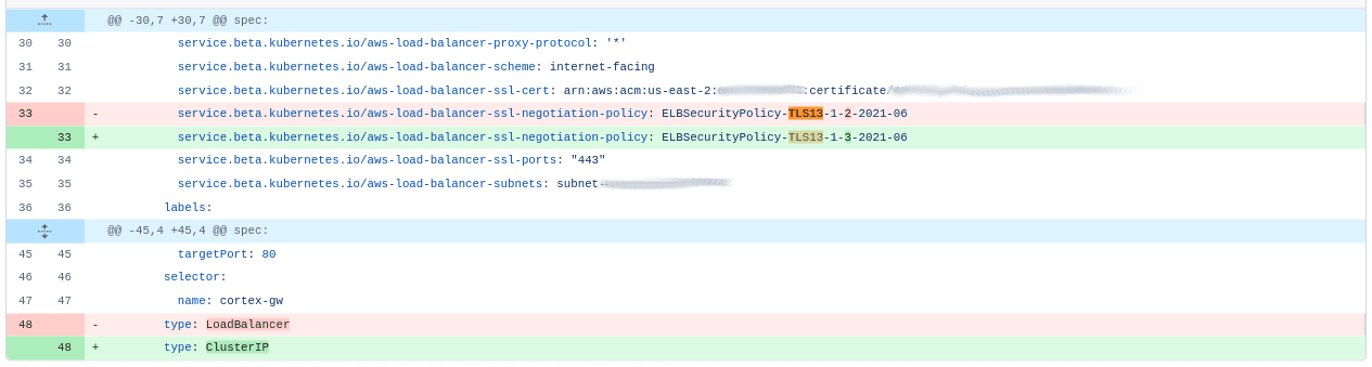

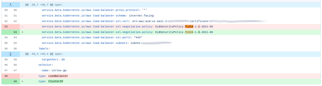

An engineer who was upgrading the TLS policy version on our load balancers, which are used for many services including the ingest of both metrics and logs data, updated and tested configurations in our development environment. This work was manually tested and proved that the change could be safely made without redeploying load balancers.
Code to implement this change was then updated in our configuration management system. We use Crossplane, an open source control plane framework, to manage many of our cloud service provider (CSP) resources with Kubernetes. An update was made to allow the default TLS policy to be overridden by changing the merge policy for the Crossplane composition. It was then possible to observe that the overridden change remained in place after reconciliation of the running configuration.
Once the results of the code change were seen to function as expected, a full redeployment and test of the code should have been performed in development. We assumed that seeing the override work was enough of a test, but this assumption was wrong.
The change actually caused a default value from the base configuration to be unintentionally overridden, resulting in an undesired change in many Kubernetes services from type LoadBalancer to type ClusterIP, causing Kubernetes to destroy the load balancers.
To resolve the problem, we needed to roll back the code change, and then recreate the affected Kubernetes services in order to have Kubernetes recreate the load balancers.

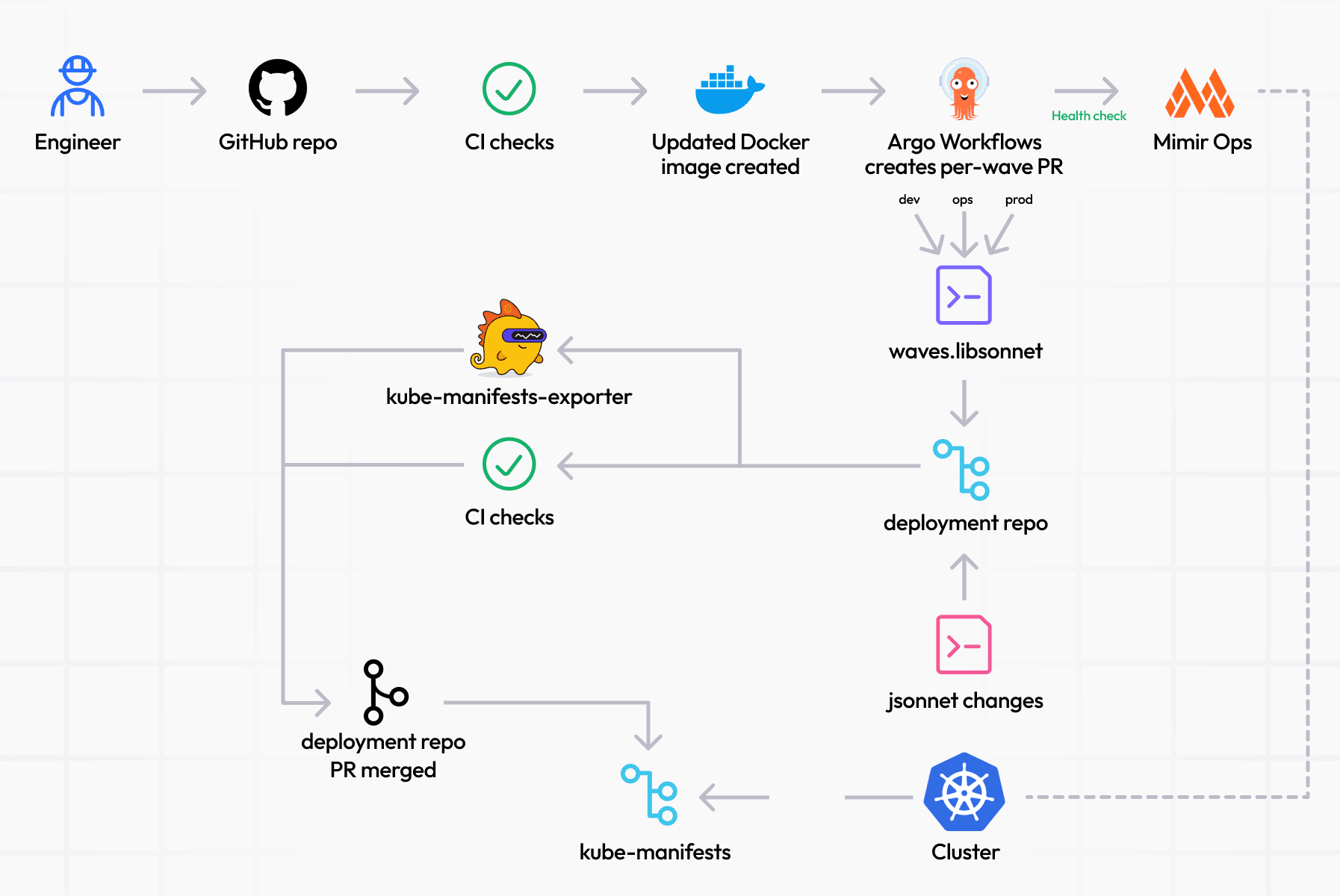

Deployment in waves through to production
At Grafana Labs, we follow good—and no doubt expected—engineering practices. This is evidenced in how we have maintained our SOC II and ISO 27001 compliance certifications. These practices include mandatory code reviews and protections against accidental merging of code in our continuous integration (CI) and continuous deployment (CD) pipeline. The code that made the problematic change on this occasion was raised in a GitHub pull request (PR) and reviewed by a qualified peer of the author before being merged and deployed.
We use the concept of waves to stagger the deployment of changes—first to our development environment, then to staging before canary deployments in production and gradually across production. After each wave we observe the systems to be assured of their health before we continue. Typically, this observation period lasts at least 24 hours. We believe and speak about reducing the blast radius of changes, and we use waves to practice this.
The diagram below illustrates how the PR to create a wave is dependent on the health of the previous wave.
Waves workflow
In a case like this TLS update, we would employ what is effectively a feature flag to conditionally apply changes to specific waves. When a library change is made, the updated version would be staggered through the waves, beginning in the development environment.
Without this flag, we would deploy without waves. This is what happened in the case of this accidental load balancers removal. We did not deploy the change as a wave into the development environment through our automated process—it was done manually—so we missed the unexpected behavior of the Kubernetes Crossplane operator and its effect on services.

  • We now have a CI check to prevent a deployment to more than one wave, meaning that any exception to the devstagingcanaryproduction0…productionN expectation is caught.
  • We have had more sophisticated designs for waves in discussion, and this work has been made a higher priority towards an agreed improvement and implementation.

Over the last quarter we have been developing a Crossplane Managed Resources exporter to help us improve change validation and visibility. This is now in beta testing within Platform engineering. When we simulate its use against the change that caused this outage, we can see a clear diff.
Embedded image
