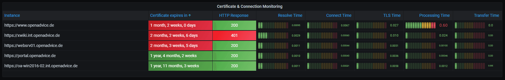

This is how it looks, all your certificates in a glance: the time remaining until the certificate expires, the HTTP response message, and connection metrics.

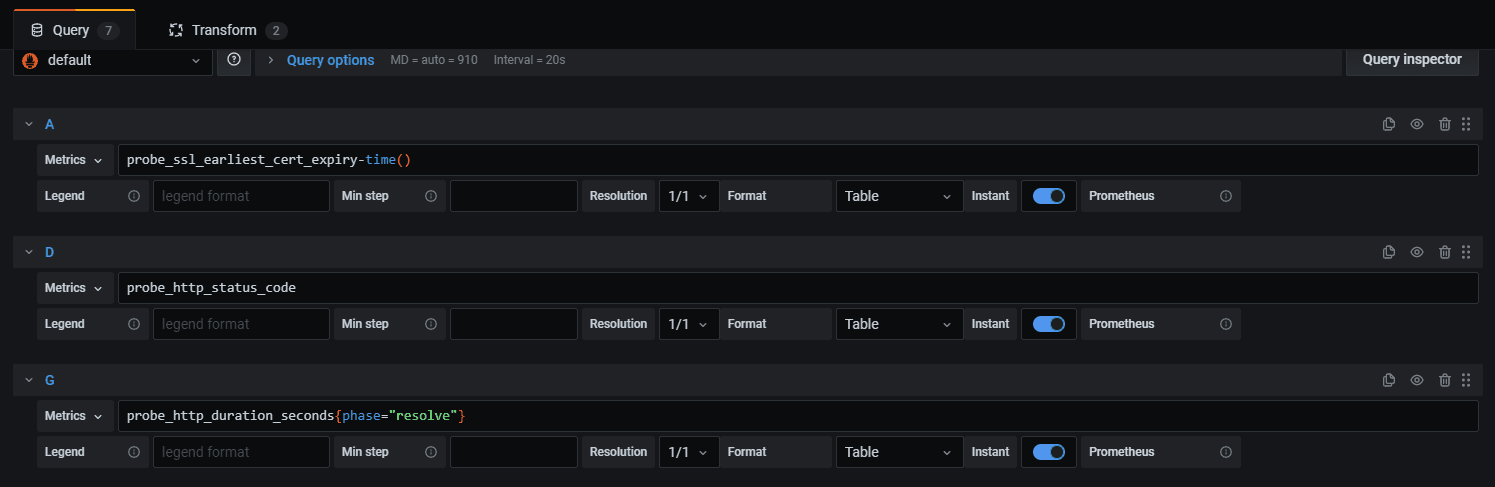

A couple of Prometheus queries…
We’ve kept the queries simple in this example.
Embedded image
Remaining time:
probe_ssl_earliest_cert_expiry-time()
HTTP status codes:
probe_http_status_code
All HTTP duration queries:
probe_http_duration_seconds{phase="resolve"}
probe_http_duration_seconds{phase="connect"}
probe_http_duration_seconds{phase="tls"}
probe_http_duration_seconds{phase="processing"}
probe_http_duration_seconds{phase="transfer"}

One of our favorite new features in the table visualization is the “Cell Display Mode” option for each column. We’ve chosen bright background colors for the “Certificate expires in” and the “HTTP Code” columns. The “LCD Gauge” in the connection performance columns provides clarity, but also a cool retro look. :)

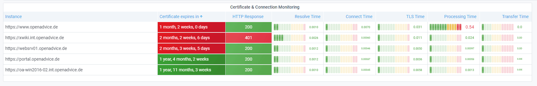

It was possible to do something similar with earlier Grafana versions, but now with Grafana 7 features, we can put everything into one compact table without overloading the dashboard visually, and the certificate/connection problems jump right out with even a quick glance!
