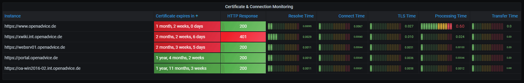

This is how it looks, all your certificates in a glance: the time remaining until the certificate expires, the HTTP response message, and connection metrics.

Now that we have our metrics, we can quickly visualize this in Grafana. We’ve created a new table panel in Grafana 7 to display all the relevant metrics in one panel.

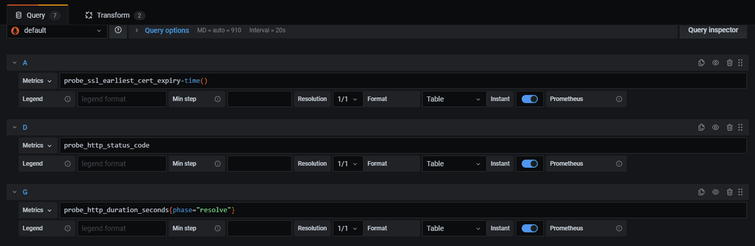

A couple of Prometheus queries…
We’ve kept the queries simple in this example.
Remaining time:
probe_ssl_earliest_cert_expiry-time()
HTTP status codes:
probe_http_status_code
All HTTP duration queries:
probe_http_duration_seconds{phase="resolve"}
probe_http_duration_seconds{phase="connect"}
probe_http_duration_seconds{phase="tls"}
probe_http_duration_seconds{phase="processing"}
probe_http_duration_seconds{phase="transfer"}

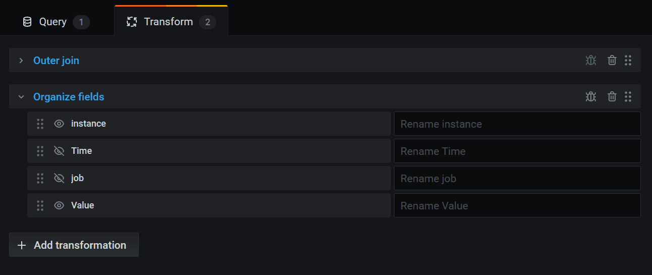

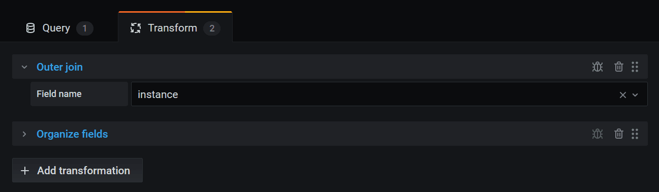

We are also leveraging the new “Transform” features of Grafana 7: using an Outer join on the “instance” field to display the results of all queries together on one row.
The Organize Fields transform is also used to filter the columns that are displayed in our panel.

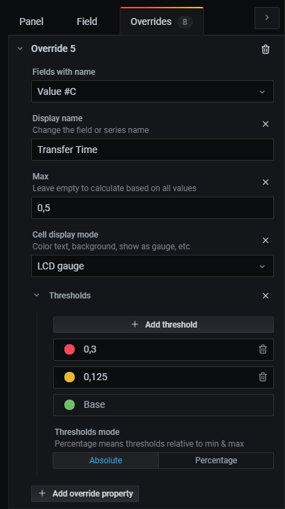

And some series overrides…

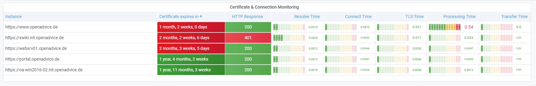

One of our favorite new features in the table visualization is the “Cell Display Mode” option for each column. We’ve chosen bright background colors for the “Certificate expires in” and the “HTTP Code” columns. The “LCD Gauge” in the connection performance columns provides clarity, but also a cool retro look. :)
