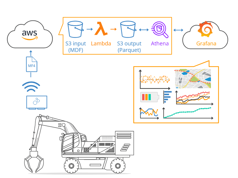

- A CANedge device uploads raw CAN/LIN data to an Amazon S3 input bucket
- When a log file is uploaded, it triggers an AWS Lambda function
- The Lambda function DBC decodes the data to Parquet files
- The Parquet files are written to an AWS S3 output bucket
- Grafana visualizes this data lake via the Amazon Athena data source plugin
This setup can be auto-deployed in less than 15 minutes — zero coding required.

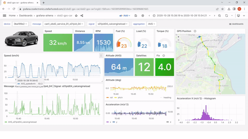

By preparing agnostic Lambda functions and AWS CloudFormation templates, the Grafana-Athena integration enables every individual user to deploy everything in minutes — without writing a single line of code. Further, Grafana’s open source nature enables our team to prepare dashboard templates for common use cases. Most users simply load one of our plug-and-play JSON dashboard templates, which lets them get started in seconds. We use this to enable dynamic dashboards through variables, where users can browse between different devices and parameters via auto-populated drop downs.
3. Seamlessly analyze data across years (or milliseconds)
The upload log files are automatically decoded and written to an Amazon S3 Parquet data lake. The data lake is structured so that every CAN message is contained in a separate folder, which enables users to retain the original timestamps of every message. In Grafana, users can then leverage standard SQL queries to define each dashboard panel — and seamlessly resample data on-the-fly. In practice, this means end users can effectively visualize data across years and GBs of data, and then seconds later zoom in to visualize intra-second observations matching the original timestamps at which the data was recorded on the CAN bus.
